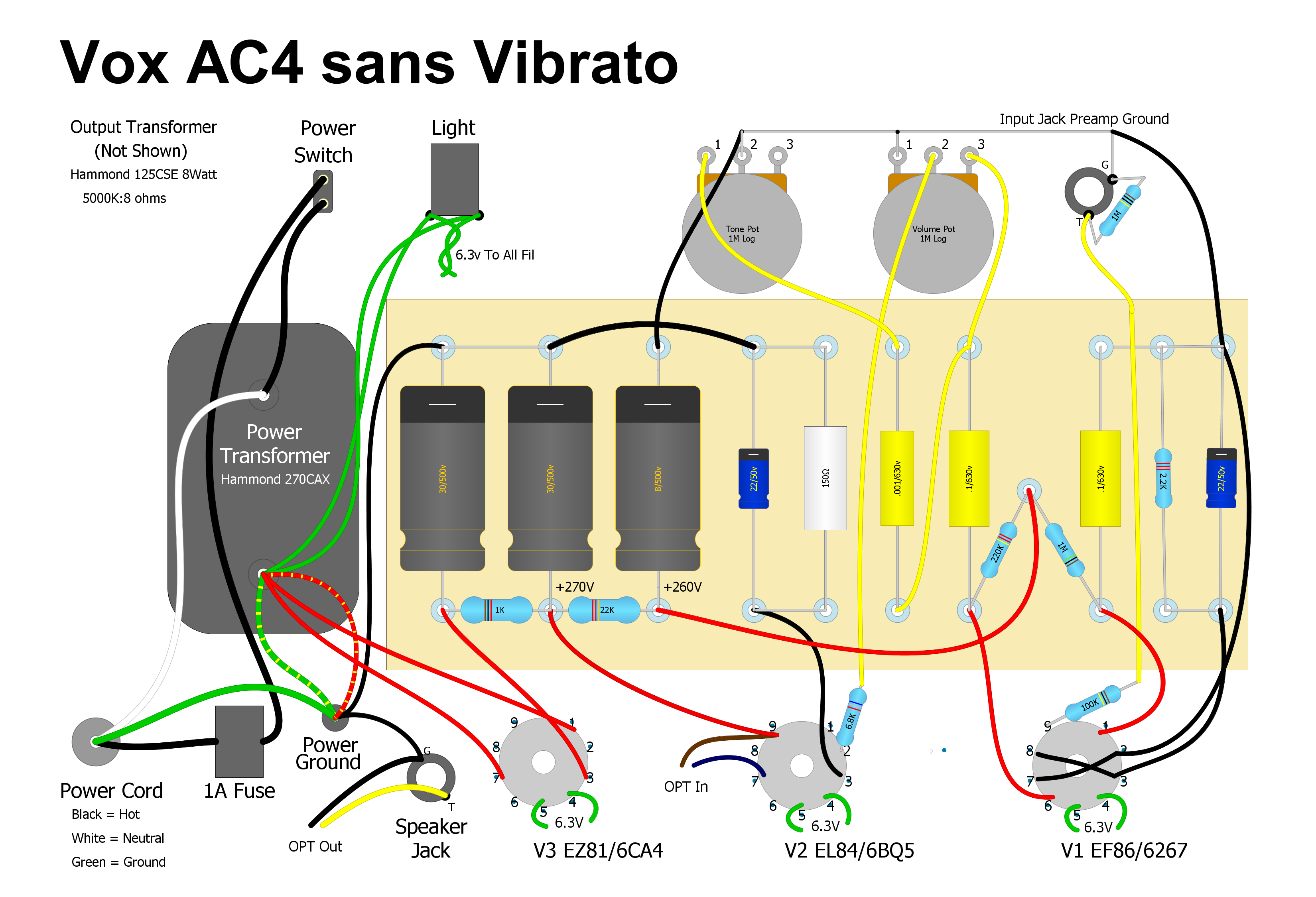

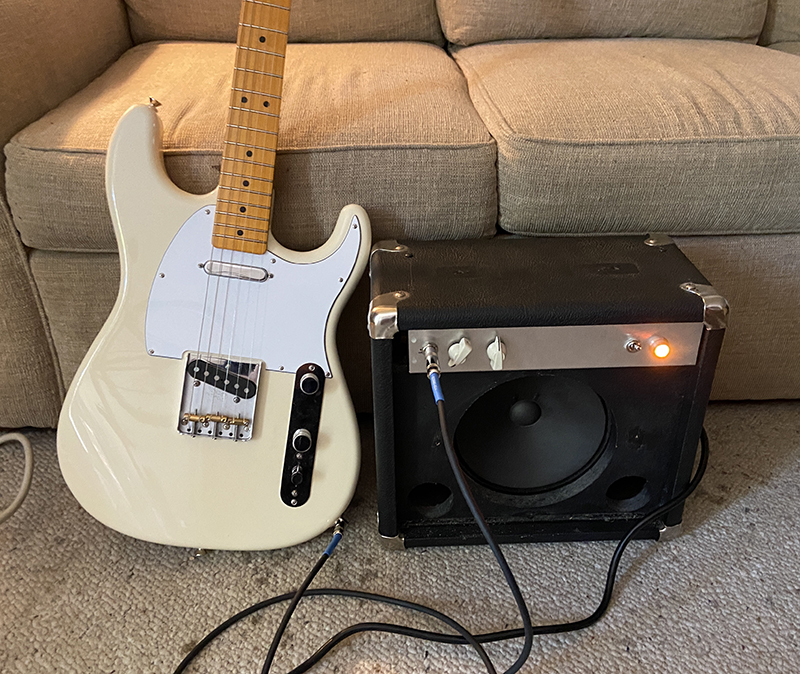

Hey everyone, I know this isn't directly related to Tubelab, but it was my SSE that gave me the confidence to start another build.

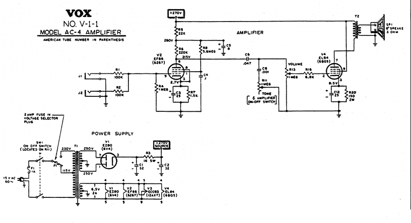

I chose a 55 yr. old schematic for a Vox AC4 and built a tube guitar amp from scratch. I re-used an old Fender Frontman cabinet. I built the amp in a Hammond chassis using a Hoffman turret board that I designed.
Amazingly, it worked from the first power up! But, I got a TON of help and guidance over on another amp forum, so I didn't do it alone by any means.
Anyway, I wanted to share it here. George, I know you like building guitar amps, and even started out with them. My AC4 sound great. It was a really fun project. It uses an EZ81 rectifier, an EF86 for preamp, and an EL84 for power.

That AC-4 schematic is very similar to the first real guitar amp I built when I was somewhere around 10 years old. There was no internet in 1962, information came from electronics magazines, library books, or from another more knowledgeable friend.
In my case a schoolmate had an older brother who was a ham radio operator, and played guitar. He had taken his 5C1 Fender Champ apart and traced out it's schematic. I copied his the hard way, pencil and paper. Copy machines were not available to ordinary people either. He gave me some advice that I still share today....get it working as designed, then we will talk about upgrades and mods.
The old Champ used a 6SJ7 in place of the EF86 and a 6V6 in place of the EL84, and it had grid leak bias, which was ditched as the first mod, making the schematic virtually identical to yours, except for the tube choices.

Wow - that's nothing less than super-cool! I especially like the turret board; did you purchase that pre-made or did you build it from scratch? Excellent workmanship either way. I've been toying with building a Marshall 18-Watt clone for a long time; yours just might push me into action.
Also, whatever you used to sketch up the pictorial and schematic was just the ticket. I'm looking at purchasing (or otherwise legally acquiring) some new visualization tools to replace some of my aging software, and the ability to produce output like that would be nice indeed.
Thanks George. I bought a lot of my parts and the tubes from them. Great service.
But, I used the free DIY Layout Creator software to draft my layout and then uploaded the turret board drawing to Hoffman Amps. He cut the board to size and installed the turrets all for a great price for a one-off custom part. I bought a lot of other things from him, too. He (Doug) also first-rate service and super fast 2-day shipping.
As built, my new AC4 is running at just under max plate dissipation. About 11 watts for an EL84 that's rated at 12 watts max! But, it sounds great so I'm leaving it alone. Going from a 150 Ohm cathode resistor to a 180 would drop it a bit, but I like the way it sounds. From what I've read Fender historically pushed output tubes pretty hard in a lot of their amps.
Mr_Zenith, I used a free program called DIY Layout Creator. It's super easy and works great. It comes with a library of parts drawings. No need to buy any software.

The first layout I posted has an error with the tone knob wiring. Maybe sixty year-old British tone knobs worked "treble-left/bass-right."
Here's the final corrected layout.
I installed a Celestion speaker in the cabinet today. A more efficient speaker than the old cheap Fender. It's a lot louder with much better tone.
Edited: that's still wrong! The second one is correct. Sorry about that.
