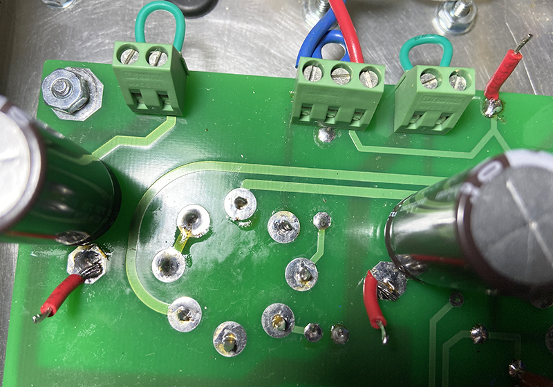

.....I wired up the PT. I'm assuming the 6.3V center tap is not used. I tucked it away.....
on my edcor xpwr144 transformer for a point to point wired 300b/6sn7 set the 6.3v winding had a centre tap. enquiring about where to put this, it was advised to connect to the ground bus. i have not tried leaving it unconnected though. @tubelab_com or others may wish to confirm as to the correct terminal on the pcb to connect this if at all.

Thanks woodo. I haven't come across any recommendations to ground the 6.3 center tap. Hopefully someone with an SSE will comment. Yep, I'm nervous about powering up for the first time. I also thought about calling around town to try and find a good amp tech. But, I'm just going to make a dim-bulb tester and let it do whatever it does!
The 6.3V CT is not used on the SSE. Do not ground it.

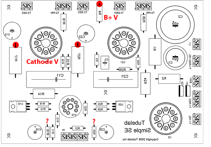

Well, I made a diagram following Ty_Bower's guide. I flipped the image in Photoshop so it matches what I'll be looking at from beneath the board.
Ty did not say which ends of R10 and R20 to test when checking for the 12AT7 cathode voltages. I put a "?" there. Can someone tell me which end of the resistors to connect to?
In the same thread, SGregory said to check for AC out. I assume he meant to measure AC at the speaker terminals? How would I do this?
Here's my plan:
1) Power up with no tubes and watch for problems. Power down.
2) Power up with tubes and dummy load and watch for problems. Power down.
3) Check B+ voltage at R4. Power down.
4) Check Cathode voltages at R17 and R27. Power down.
5) Calculate current draw and power dissipation for the EL34's.
6) Repeat steps 4 and 5 for R10 and R20 (when I know which end of the resistors to connect to). Power down.
7) Post my measurements and calculations here and wait for comments.

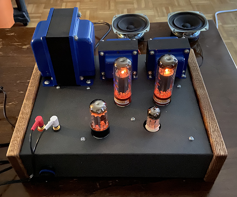

All the tubes are glowing to what I would call a dim orange.
The 200 watt dim bulb has a low orange glow.
I did not hear any noises, and I can't smell any smoke.
I let it sit like this for a few minutes.
I did notice that it was several seconds before the dim bulb started to glow. I'm guessing that's due to the CL-90, D3, D4, TR1, and the 5AR4 warming up? Is that normal?

And, a functioning Tubelab SSE!!!
A HUGE thank you to George for making this project possible, and a HUGE thanks to everyone here who took time to answer my questions and provide advice.
But, this is enough excitement for one morning. Later, when my heart rate is down, and I'm relaxed, I'll take some voltage measurements.
For now, I'm really happy!
[My phone camera makes the tubes look brighter than they actually are.]

Thanks everyone! I'm glad I made it through that part.
A few observations:
The amp is dead quiet through my speakers, no hum.
However, there is a very, very low hum that sounds like it's coming from the transformers. This hum seems external. All three transformers are cool to the touch.
I'm not sure how brightly my EL34's should be glowing. They are bright orange in a dimly lit room. But, I do not see any redness. I guess I won't know more until I measure voltages.
I would appreciate any comments on those observations - whether or not they represent red flags, or not.
