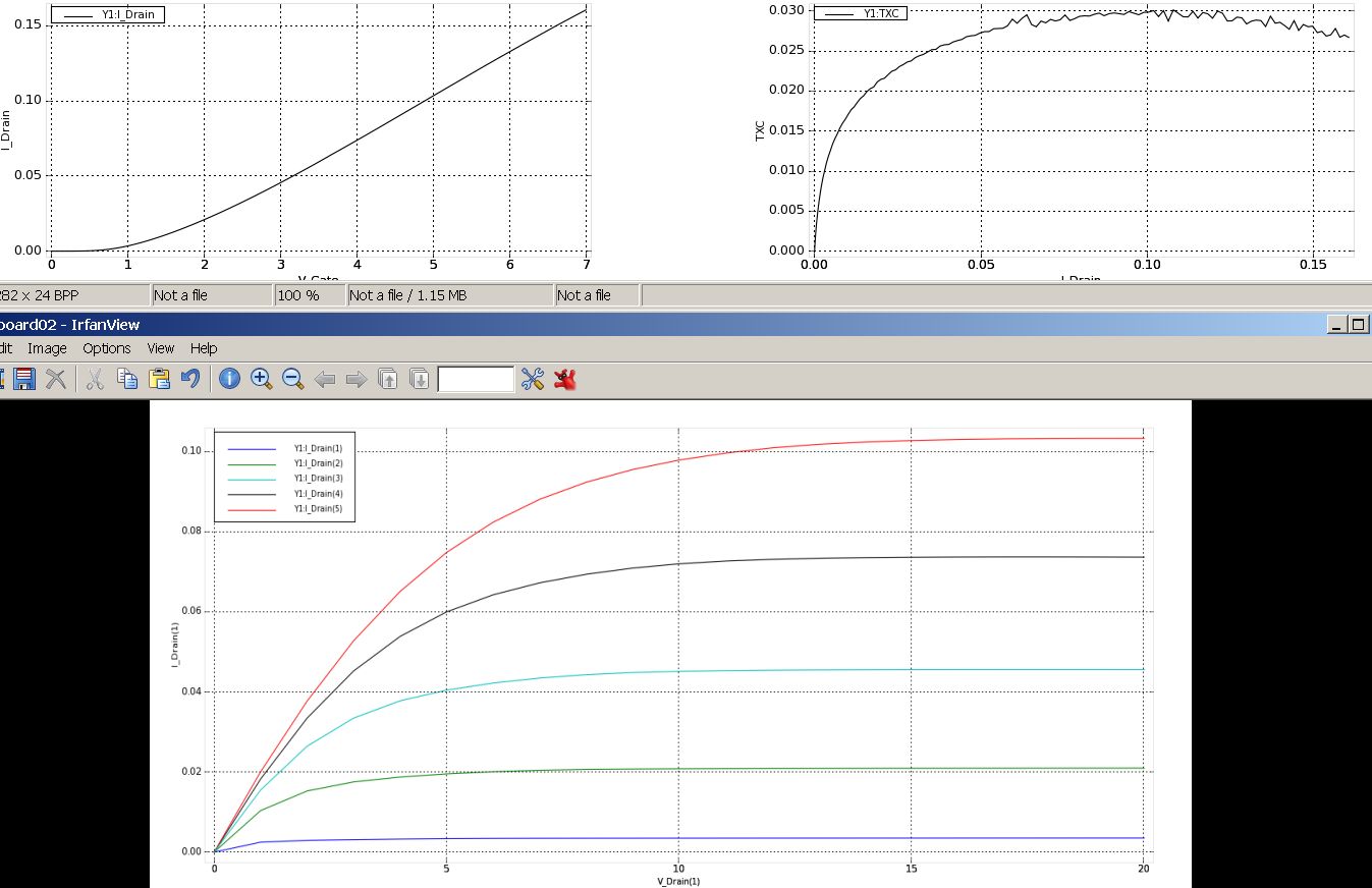

Now that I have access to a curve tracer, I can play much more effectively with some toobz and the the SITs, power JFETs, etc.
Just received some KP902A parts. Curves are attached.
At 20V Vds, this part looks very linear at 100mA.
Transconductance is 30mA/V.
Its not a JFET, but it looks like a nice input/driver.
