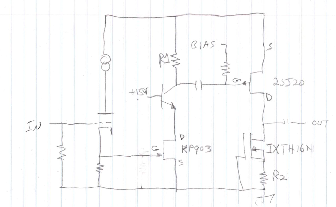

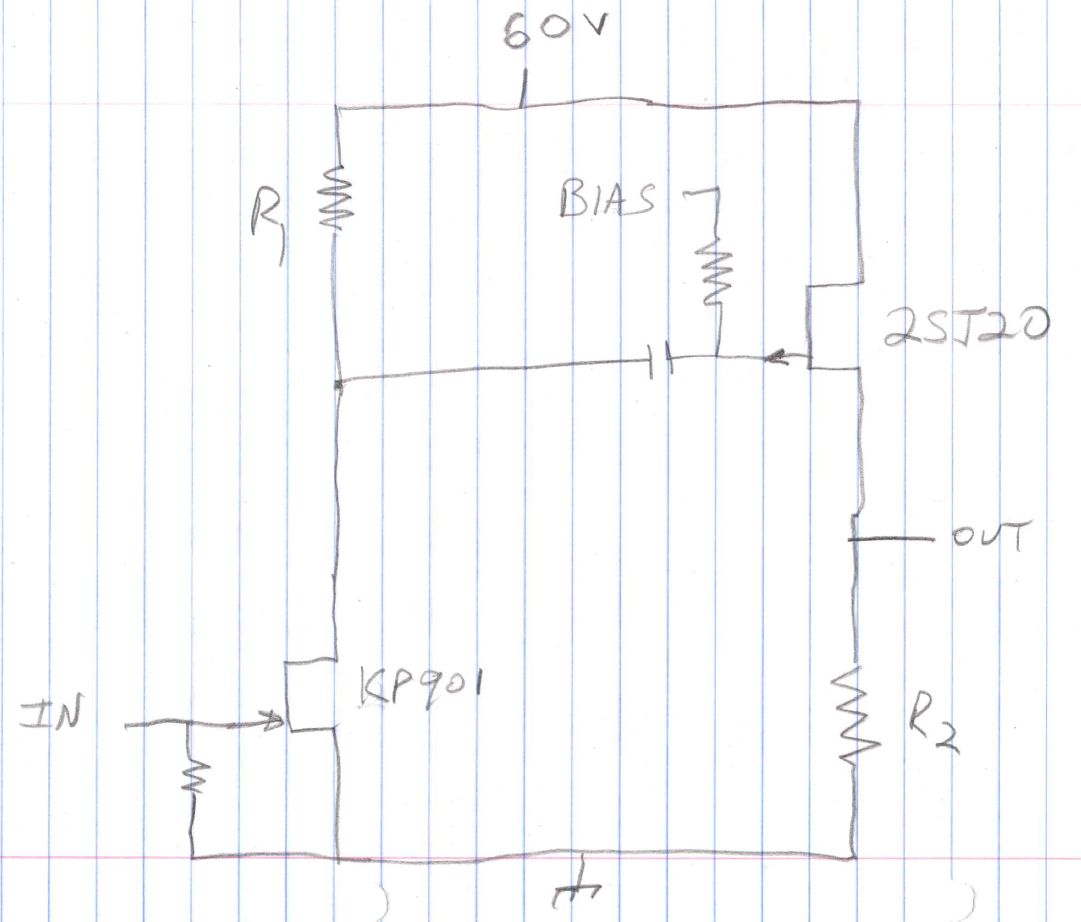

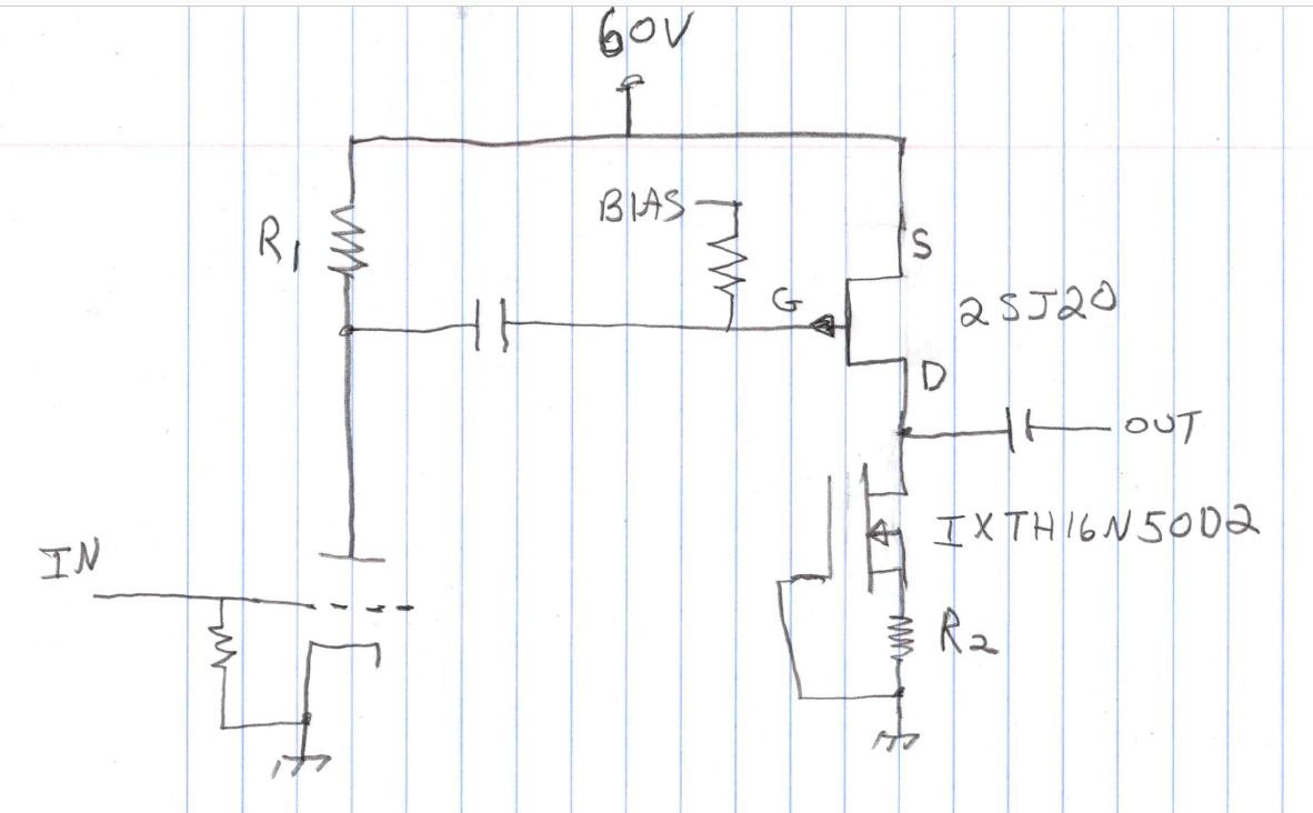

Now that I have access to a curve tracer, I can play much more effectively with some toobz and the the SITs, power JFETs, etc.
Interestingly, I played extensively with toobz when I was a kid. My father was a ham radio operator and built a Heathkit toob ham radio and built his own antenna. All ham radio gear was toobz at that time even though car radio was solid state.
- SIT-Triode Hybrid idea
