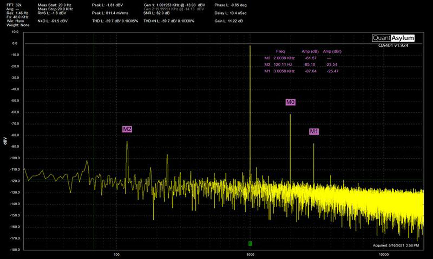

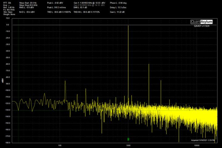

Finally decided to learn how to use some test equipment that has been here for over a year. 🙂 It's going to be a steep curve for me, but here's a quick 1k grab from the SIT

I can see that you have fundamental at 0db
keep it at -10dbfs, everything is more controlled that way

Thanks for the tip, I can use all the help I can get... wish I had someone close that knew it all, so I could do the Cliffs notes version.

Clip a meter across the output and when you measure 2.83VAC you have 1W output and you can take your 'official' THD @1W into 8R or 4R measurement from there.
Others with actual knowledge can chime in here but I have also noticed that 1W or 2.83VAC also seems to correspond with -7.3dBfs in my REW readings. Trying to get fundamental (1KHz) up to 0dBfs is driving the amp pretty hard which is what ZM's comment is alluding to.

The amplifier undergoing testing is powering the load resistor so I don't think it cares about 0dB at the test rig. I use REW with a Focusrite USB sound card and I have found that 0dB will overload the Focusrite/REW, so a lower level signal sent to the test rig will reduce the possibility of the test rig affecting the test result. But perhaps the QA401 is different.

I have an Autoranger (thanks Jan!) in front of my soundcard (Focusrite) but the QA401 doesn't need an attenuator in front of it, you can just connect the DUT directly.
You have a good point Ben - it's not dbV that I have my REW set to so I should point that out for clarification - I am measuring in dbFS which doesn't seem to get affected by the attenuation. I'll have to do more reading on this

twitchie, I measure in dBFS also. I think it may be the autoranging that does it for you. With a sound card, I can manually adjust the input level of the sound card or use external attenuation for dBFS or dBV. I use external attenuation because the Focusrite is supposed to have a input level sweet spot for self distortion level so I keep the Focusrite input level knob at a set location.

In any case that is a good looking harmonic spectrum.
Thanks for the input Nelson. At this point the testing is more along the lines of learning the gear with a known quantity. I trust John's measurements, so I can duplicate and see if I'm in the ball park as a sanity check.
