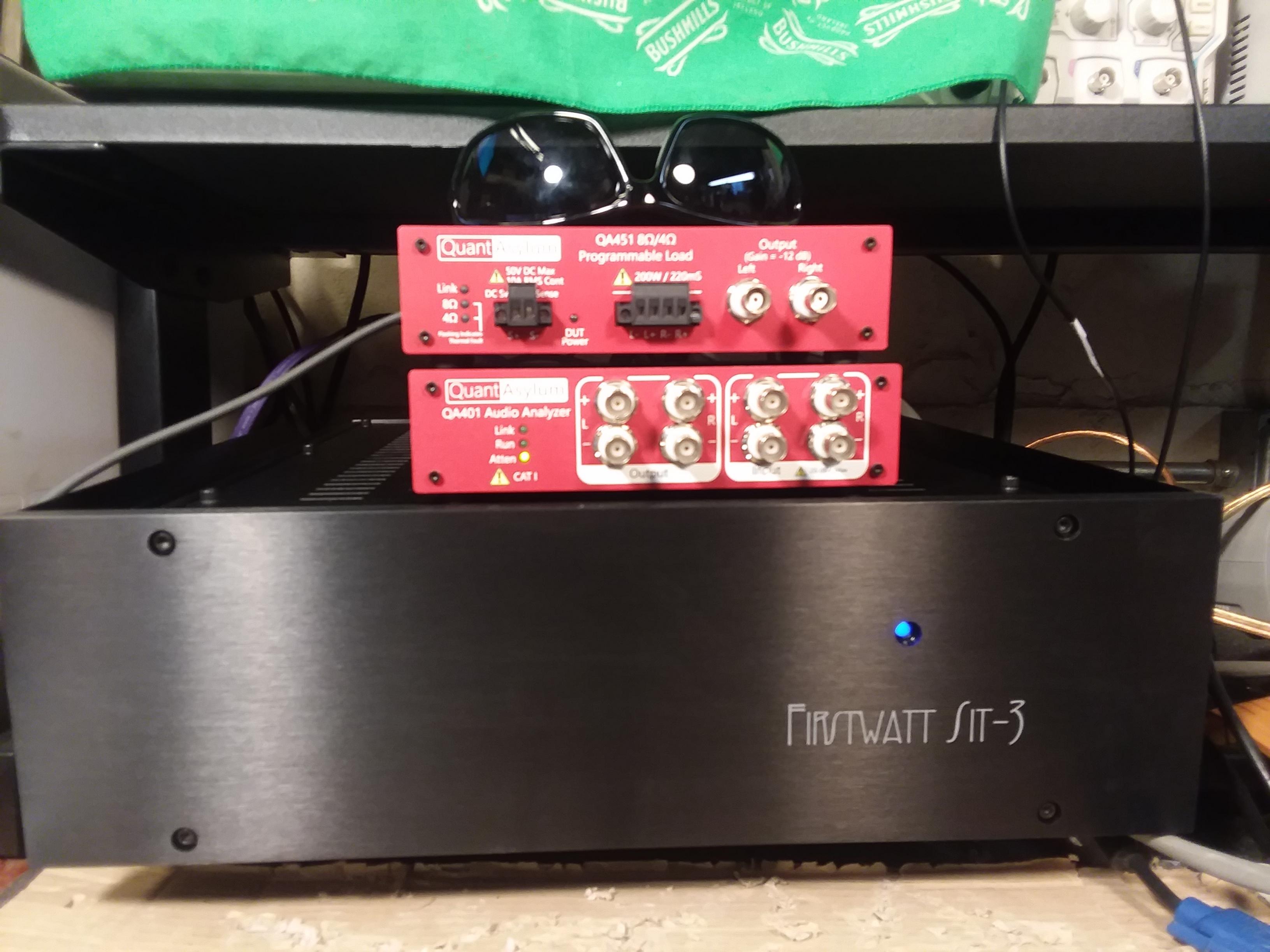

Okay, Waynes amp IS driving it to clip, but it seems likeI'm down on power, so I hooked up some 8ohm dummy and pumped in a 1k test tone and got the following.
30.4Vpp (just before clip)
15.2Vp
10.5Rms
So for amps do we use Vp in our wattage calculation? V(squared)/Rload? If so then I'm seeing 27W, but it doesn't sound like that, or maybe I've gotten used to the Badger. 🙂
