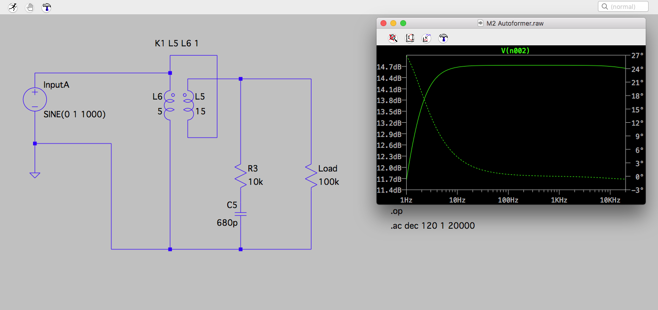

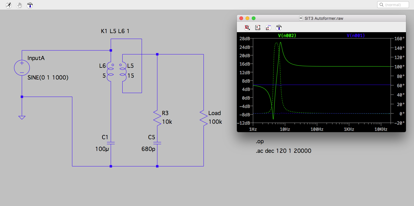

I did a simulation of M2 and SIT-3 autoformer (using M2 schematics), and I see high pass filter effect with SIT-3 (cap inserted). Am I doing something wrong?
Transformer emu is based on Hammond 600:600 spec sheet.
http://www.hammondmfg.com/pdf/140QEX.pdf
xformer simulations are either just informative ...... or tough as nail , if you want them proper
stay with first ones

Hello ZM, Thank you for the comment. I actually have another question about transformer.
I checked CMOQ4 spec sheet, and I find its max 20 Hz input level is +16dBu. Used it as autoformer, can we ignore this number? It look like SIT-3 requires +25dBu or more...
http://cinemag.biz/output/PDF/CMOQ-4.pdf
go and check that drek , not xformer sheet
if Pa chose it , no question mark
Sure, I will. Thanks!🙂
