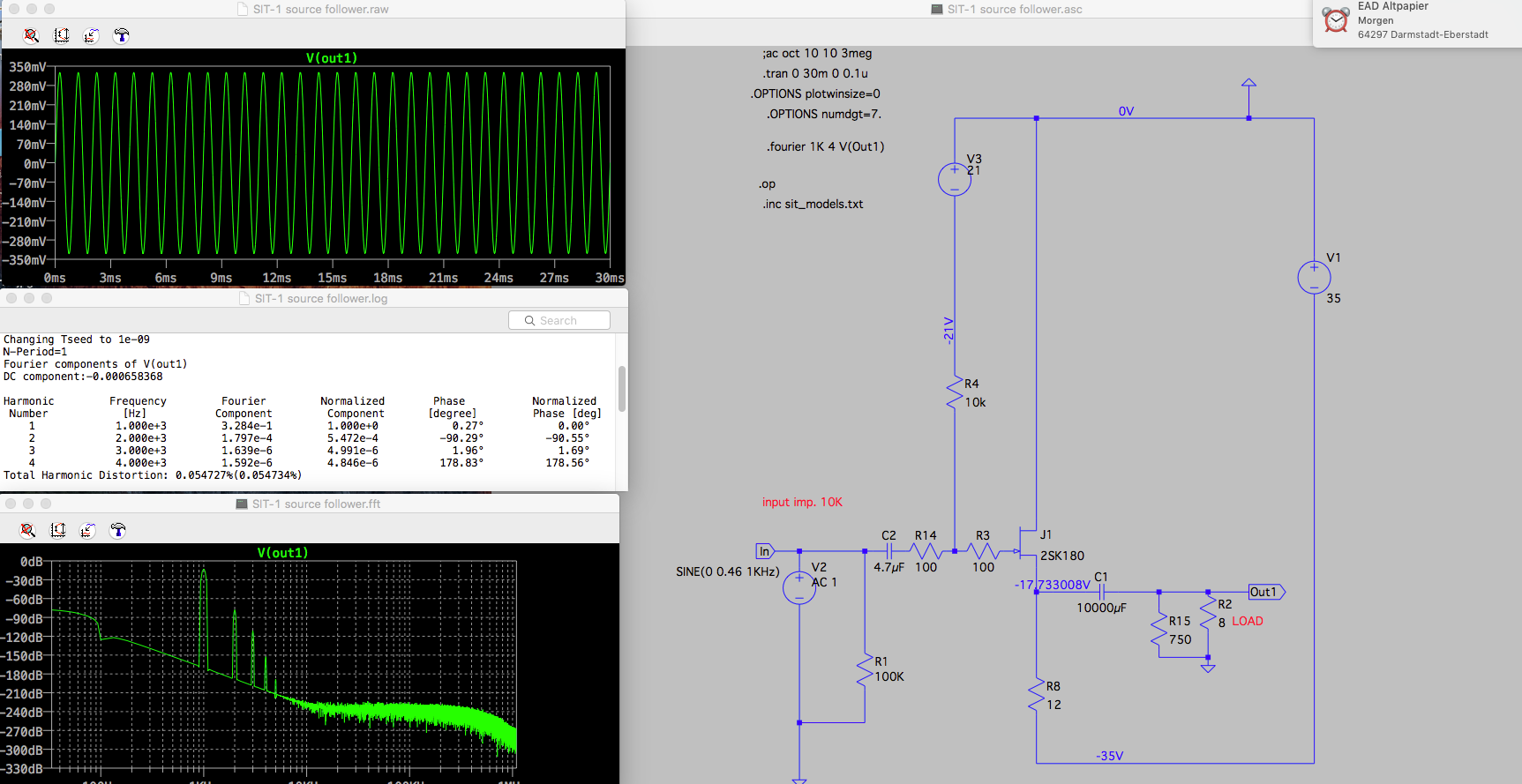

inspired by SIT-3, but maybe idiotic.....
I was told that the source follower solution sounded worse compared to the DEF.
That is not the conclusion. The Source follower SIT is pretty close to
the DEFiSIT into 8 ohms at lower power levels, but falls short in terms
of output power.

Lower output means 10W for the Source follower SIT?
I did not quite understand your last line...
DEF with the J-Fets....do you mean the J-Fet input pair or some SS at the output?

Lower output means 10W for the Source follower SIT? DEF with the J-Fets....do you mean the J-Fet input pair or some SS at the output?
Yes 10 watts.
The Jfet is SS R085 or R110 depletion mode N channel part.
