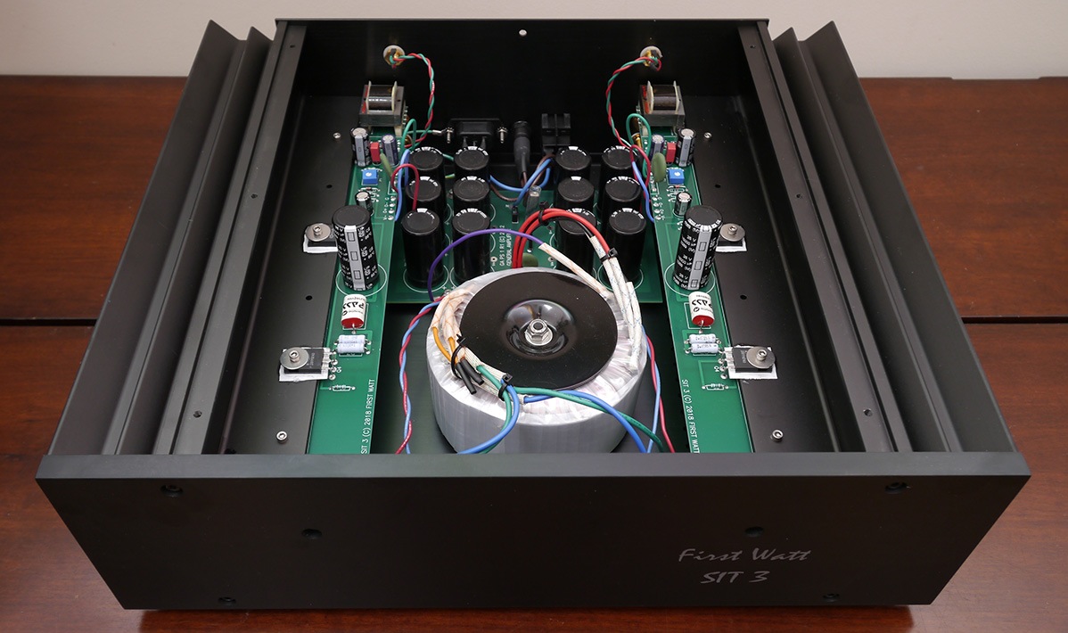

Sensational ! Let's see what inside of the original First Watt SIT-3

Salut
Seems the toroid has a mu métal shield like undercover cops.
Salut
Antek brand ~ 400 VA shielded toroid version I guess 😀
You really sound like an angel, your Antek info is like a very bright bulb jus lighten in my brain, I am building a special power supply for the Bi-Circleton, still can’t get close to the target, now your info enlighten me, it was designed with an audio toroidal transformer with ES shield. Problem solved.
This SIT-3 toroid has more than an ES shield.
Thanks for the PDF’s.
A magnetic shield and an ES shield, whoa the way to heaven is closer!
Thats possible reason why this time little Cinemag's are in the corner without mu metal protections.
Useful to know not every Antek have shields incorporated

You will notice that the sticker on the back sez "pilot run".
I built 10 amplifiers to test the uniformity of the design and also provide
some initial samples. They have the same sonic performance as
production, but have a capacitor glued to the bottom of the board
and a couple small layout changes.
You see that Srajan had the good taste not to show the underside of
the board.

Nice to see that even Nelson must match the transconductance of the IRFP240 with different parallel Panasonic 3W resistors fitting to the SIT.
In one case 2x 0R47 and in the other picture 2x1R.
Useful to know not every Antek have shields incorporatedGreetings
Now I have a good view of the photo with large screen.
Wander to know which scenario is happened first:
A) Mr Pass had bought a truck load of Antek double shielded toroids.
B) Mr Pass had bought a truck load of CineMag unshielded transformers.
Cheers
You are looking at early boards, not actual production, which has not
yet left the factory.
Actually, the match is for Vgs, not transconductance in order to trim the
bias current. Originally I tried to get as close a Vgs as possible, in an
effort to reduce the resistive degeneration, but then I developed a
technique to retain the "square law effect" independent of that.
Could that elusive cap glued to the bottom of the board be a bypass for the IRFP240 source resistor ?
