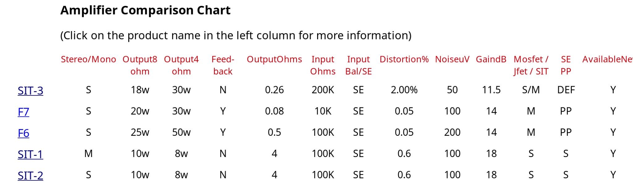

SIT-3 it's visible on all FW products chart 🙂

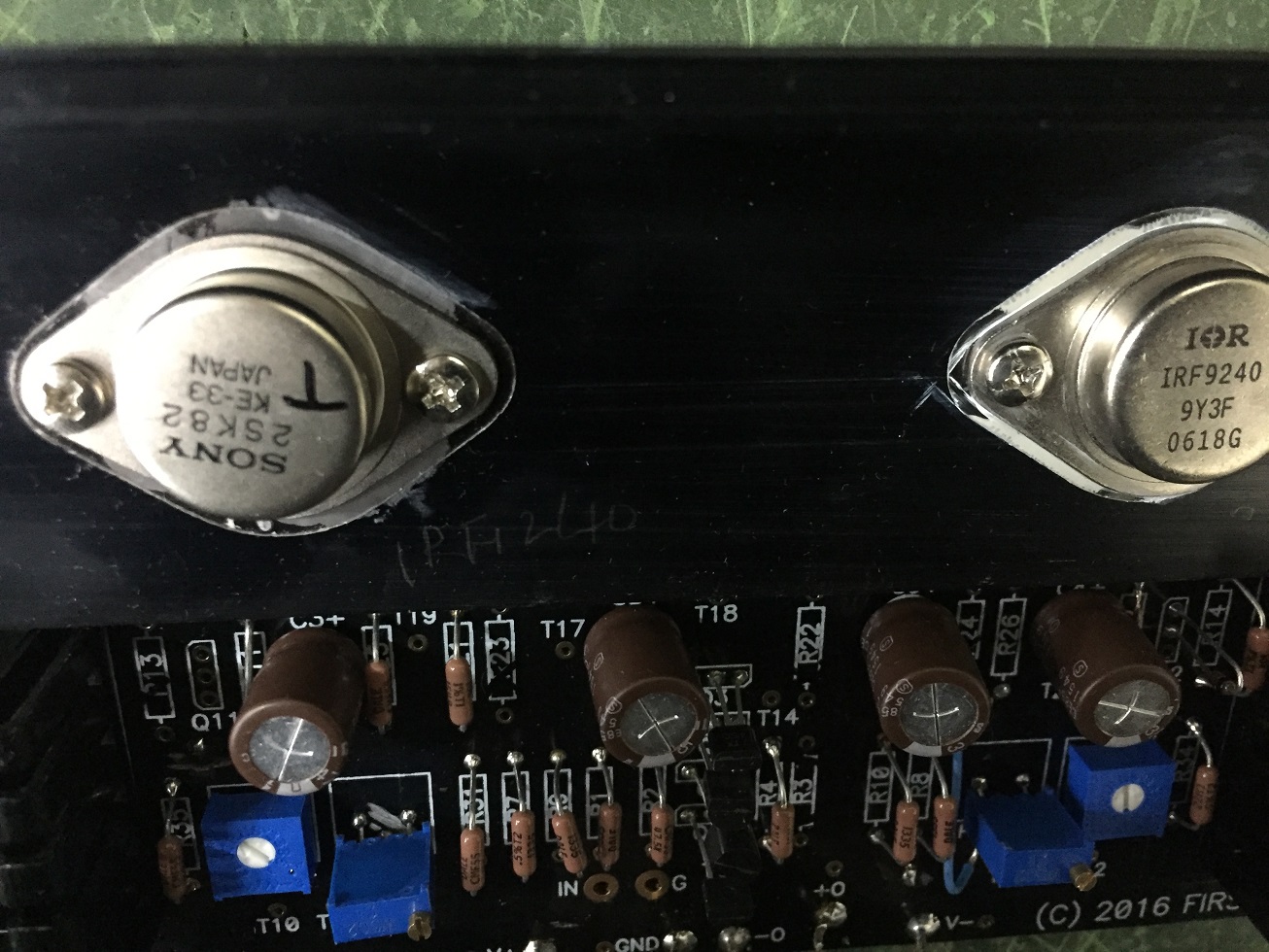

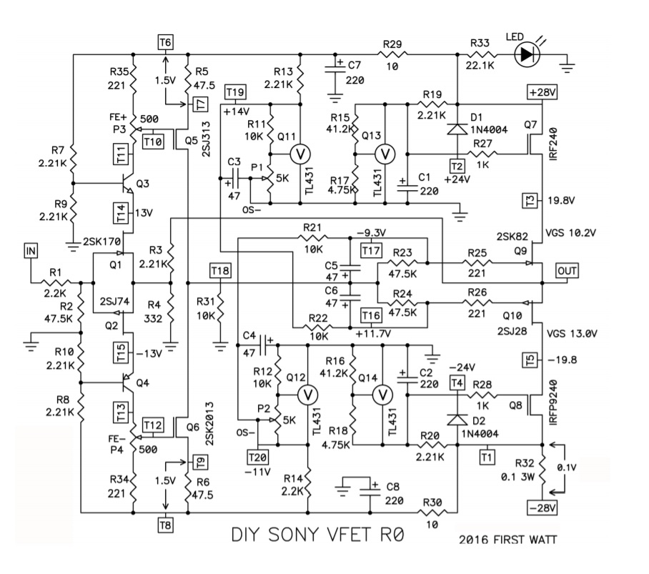

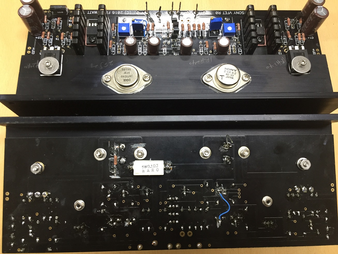

can be something similar to this? It is the DIY Sony VFet kit that I did not assemble yet. I found that they can be used as DEFiSIT with IRF9240 replacing 2SJ28. 😀😀
I tried this front end to my DEFiSIT output stage, and I like the sound, which is different from Firstwatt SIT-3. Maybe the FET regulation circuit could give some advantage?
The bias circuit for 2SJ28 needs to be converted for IRF9240 that needs negative voltage. 🙂
