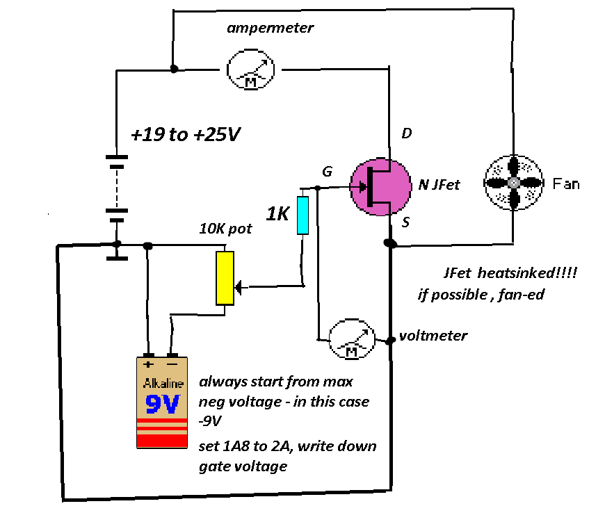

voltage source of some 20-25Vdc , capable of delivering at least 3A (you can borrow positive rail of your existing Papamp, if you have one ) ...... goal Iq is 2A
what the heck , you can use 19V power brick ,either from your ACA or your laptop
plain 9V battery for gate voltage (connected to gnd of above , to be negative)
10K pot or trimpot for setting that gate voltage
1K gate resistor
some kind of heatsink , best to have 8-12cm fan cooling it all the time of test ...... just to prevent temp. build up ..... you can use main rail for it , just reg it down to fan voltage .....or use 24V fan
ampermeter (one DMM)
gate voltage meter (second DMM)
have all that ?
if yes, I'll draw schm

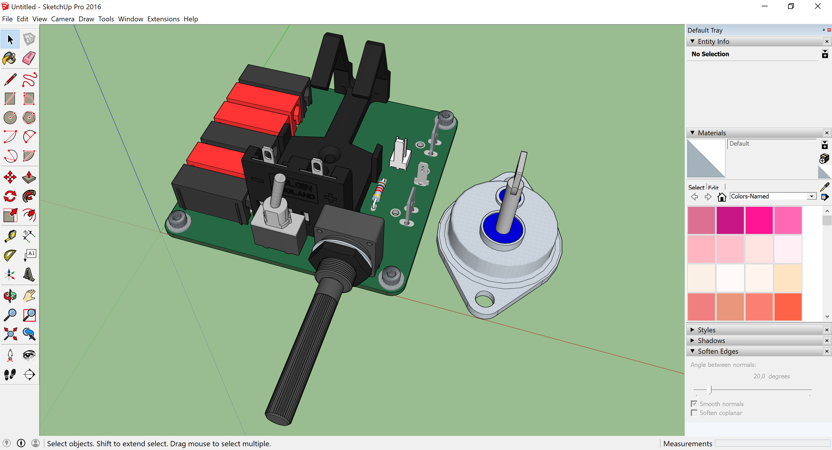

for THF51-S , body is drain ( no need for isolation for test , just keep heatsink electrically from other voltage potentials , other than + rail), fat protruding pin is source,while thin protruding pin is gate
again , any power N channel JFet , having ebough cojones , and having gate voltage in range of -1 to -3V6 is adequate for SissySIT circuit
if you sort your P channel mosfets , and use those with highish gate voltage (for -19 to -25V and Iq 1A8 to 2A) , in area of -4V5 , JFet can have even -4V gate voltage for intended conditions
have more questions , shoot

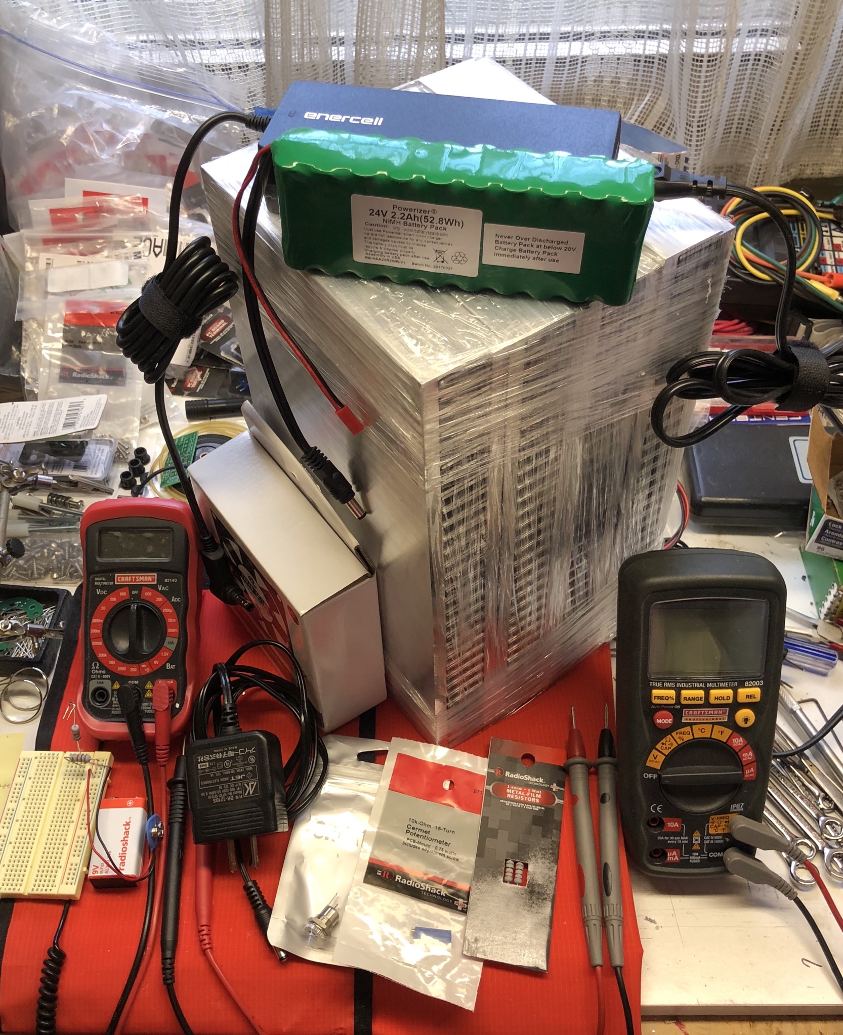

I have a bunch of raw HeatsinkUSA units that are 12”X7”X1”. Their description on the site says:
Quality extruded aluminum heatsink
Alloy: 6063-T6
Width is 12.000"
Fin Height is 1"
Base Height is .300"
Weight is approximately .60 lbs per inch
C/W/3": approximately .85
Think they’ll cut it with this project?
