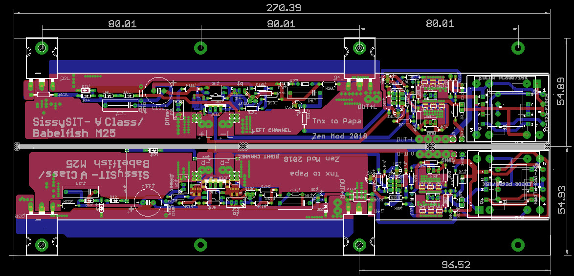

Huhboy...So, this is same board as I will receive with M25 kit? It will fit pre drilled protocol for store's deluxe 4 and Deluxe 5 chassis? If so, I better pay more greenies and get another board set?

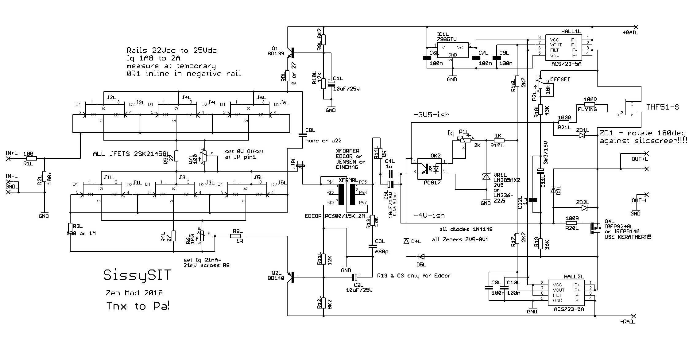

I asked tomoaki for some thf-51s matched at 22-25Vdc rails and 1A8 to 2A Iq.
He said he has some but with Vgs at -1V.
Can these be used for a sissysit?
of course
edit: from my limited batch of THFs , but also from every testing results available around , I have strong feeling that pretty much every THF , randomly taken , will fall in SissySIT circuit and work , those with biggest value of Ugs maybe just demanding some choosing of P mosfet Ugs
illustration - one IRFP9240 in my T-Bed is having -4V1 , second one is having -4V5 for same conditions
practically , if optocoupler is covering 10V gate voltage window in M2 , and it work covering 600mV window in SissySIT prototype , it'll cover everything in between ...... in worst case with resistor or two value correction
Regarding mechanismus of circuit itself , it's really hard to re-tell shortly everything spoken of in two threads linked in first post of this one ........ so ,I believe it's worth going back and re-read them , if you missed it .
However , for starters , to quote my self from Babelfish M25 thread , because circuit around DEF output stage is pretty much the same :

One of ideas was to keep , by any cost , sources of parts in question non-degenerated , as one of important "details" in Papa's purest DEFiSIT specimen(s) ; however , as zillion of sims showed , there is no way to keep source of any of these parts (or - to be more precise - compound pairs) clean , simply because THD spectra of said combos is simply not satisfactory , and some shaping of part behavior is easiest to do with source resistance , and strategic arrangement of same , regarding output node.

So ..... indra1's idea was tempting .... tnx to meine Bruder Generg , I obtained ACS723LLCTR-05AB-T2 chips without too much fuss ..... already done some extensive simming of some possible iterations of M2 and XA25 bstrd

1. to pursue possibilities of using small bug cased 2SK2145BL Toshiba JFets , of present production , instead of more and more rare Toshiba complementary oldies or always scarce LS JFets ........ in both usual SE configuration and in Papa Borbely's White Cathode Follower transpose in JFet realm ;
1. to make possible usage of Edcor , Jensen and Cinemag xformers of final user's choice ;
3.to pursue possibilities of current sensing in rails , to avoid source resistor in output...........

still pending changes to schm in first post; missing few protection diodes
will edit tonight , and leave a note about final schm

If I understood it right some p channel mosfets with vgs between 3.5-4.1v can work with these 1.1v vgs sits, right?

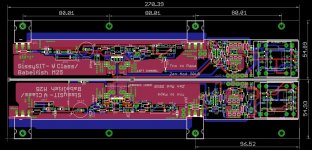

Updated images, these have been placed in post #1
