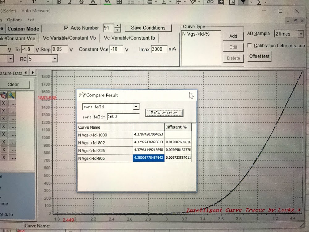

Today, I promised my friend to retest it, because I had chosen four of them yesterday, but because I didn't use the screw to fasten THF-51S in the radiator, the test results were inconsistent.
Re-measure four of yesterday's tests and compare them. (Today's four tests, or yesterday's four THF-51S)
LOOK:The first picture is four THF-51S without fastening screws (just placing them in the radiator) tested.
The next picture is to re measure the same 4 yesterday.
(screws attached to the top of the radiator)

Dit anybody try/succeed in curve tracing the THF-51Ss on the Locky_z curve tracer?
.....of course, many of them ....they are all different and seldom paired!
The best chance to get paired one is prass1170.
May I laugh a bit.... the difference is not big or I am blind?
No, your eyes are very bright
Your eyes are sharp
Impossible, I may believe you if you say his eyes are Rodenstock. 😀Your eyes are sharp
well , now you know that difference is not so big
but it is there , and consistency is matter of principle , also preventing border line cases rearing ugly head
yes of course now....
I had aspected a much bigger difference.....laughing was more Sisyphus like...
