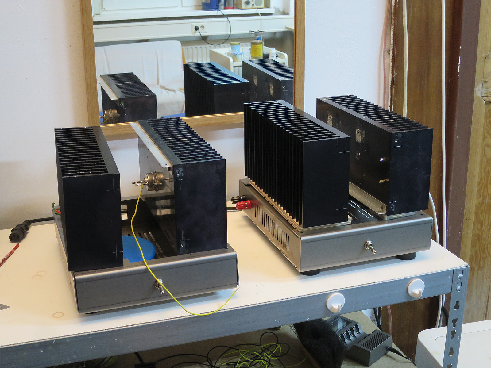

preview of the Sissy Sit Sisters
Oh, my god, this radiator is huge.
- SissySIT
