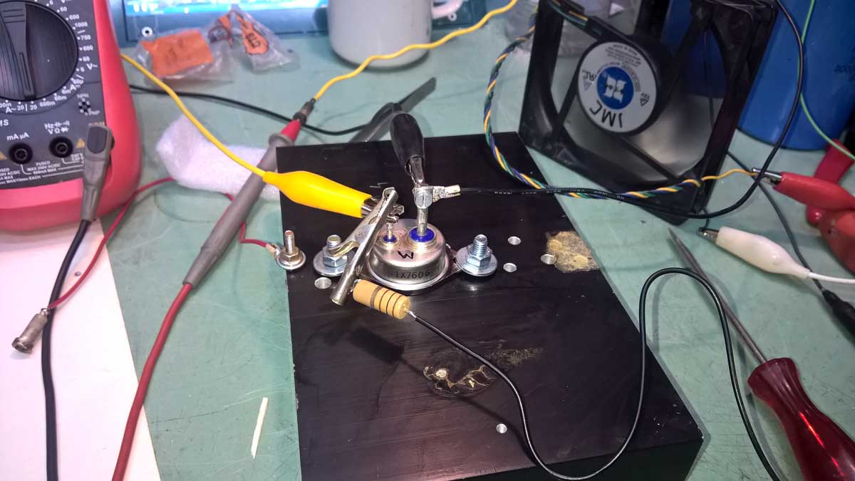

Now , I made Ugs measurements , with preferred condition of 24V for Uds , at 1A8 and 2A for Iq
in moment when I arranged to get 2SK182 from both Pras1701 and watanabetomoaki , I didn't know are they able or willing to send pre-tested devices , so I didn't asked for any matching
results for 2 pairs of 2SK1182ES are :
pras1701 , code 1Y1362 : -2.02V@1A8 , -2.00V@2A
pras1701 , code 1Y1363 : -4.37V@1A8 , -4.27V@2A
watanabetomoaki , code 142338 : -4.06V@1A8 , -4.03V@2A
watanabetomoaki , code 142339 : -4.06V@1A8 , -4.00V@2A
conclusion :
one SIT from pras1701 , with lowest Ugs is perfect for SissySIT test ....bot other one is not
both SITs from watanabetomoaki are border cases for test in SissySIT , demanding chase for mosfets having Ugs in range of 4V5 for 2A Iq , to enable at least 500mV voltage window , for optocoupler bjt nesting in

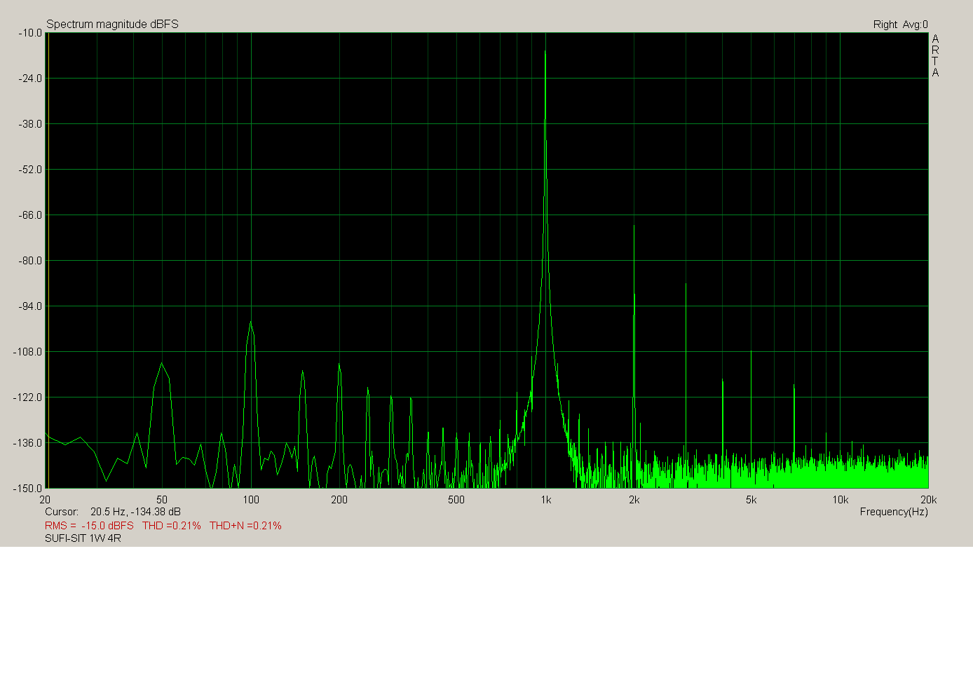

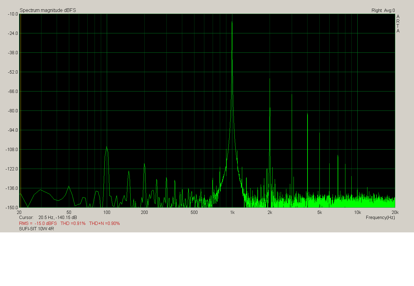

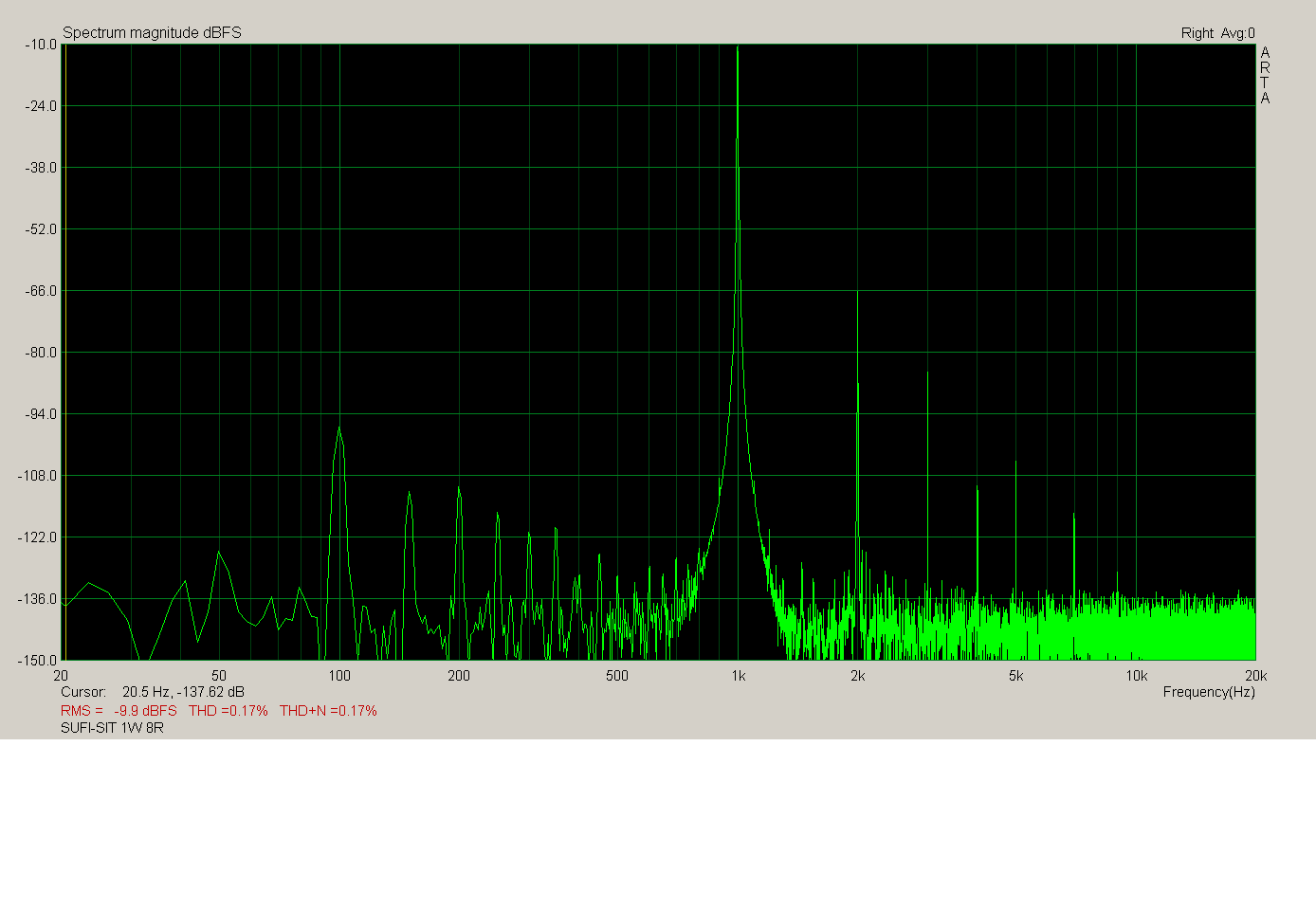

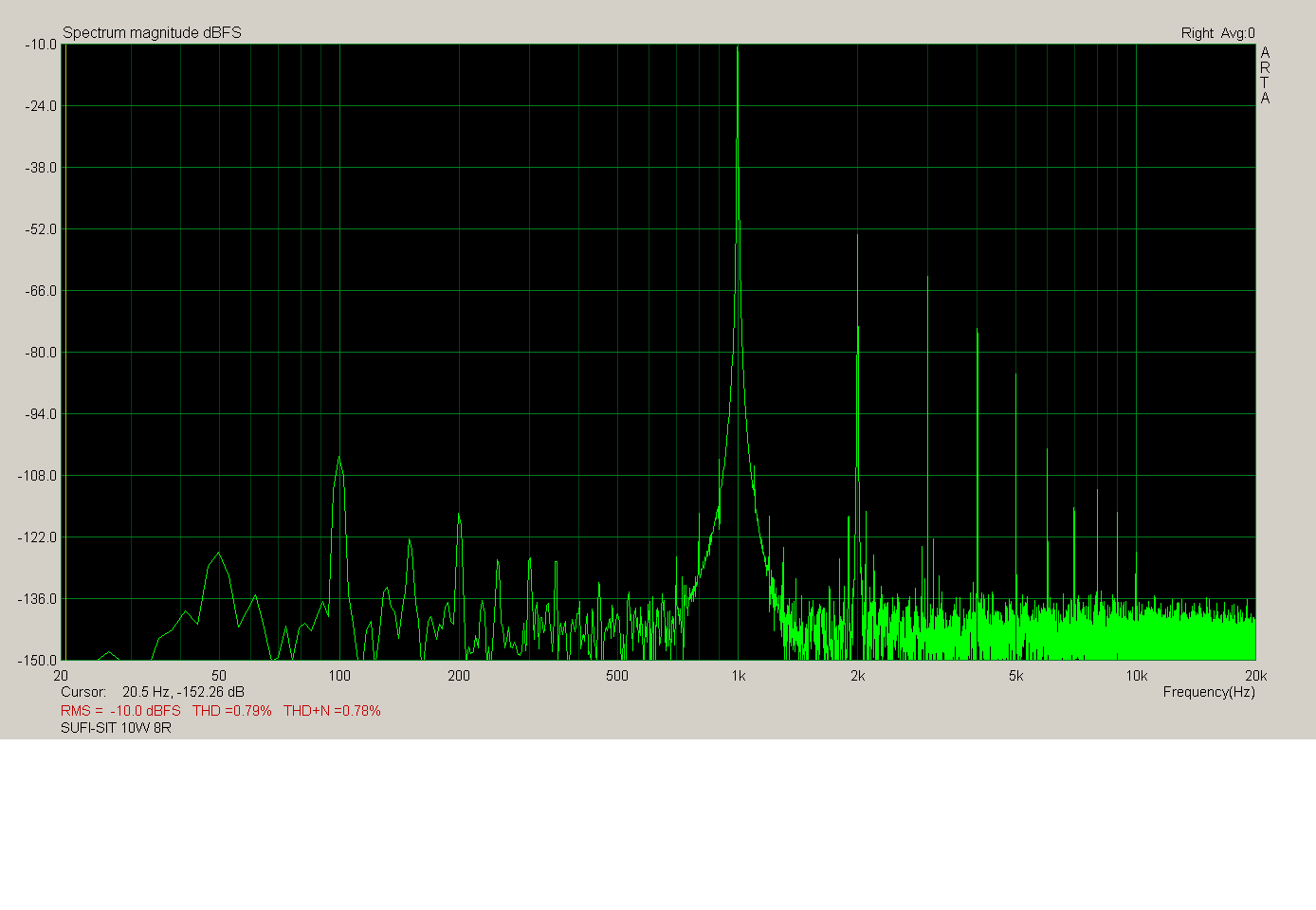

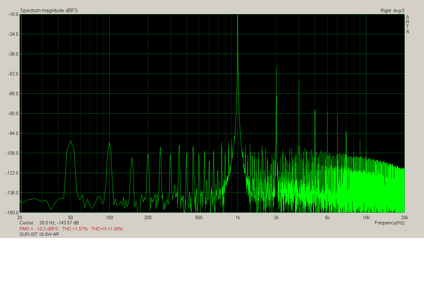

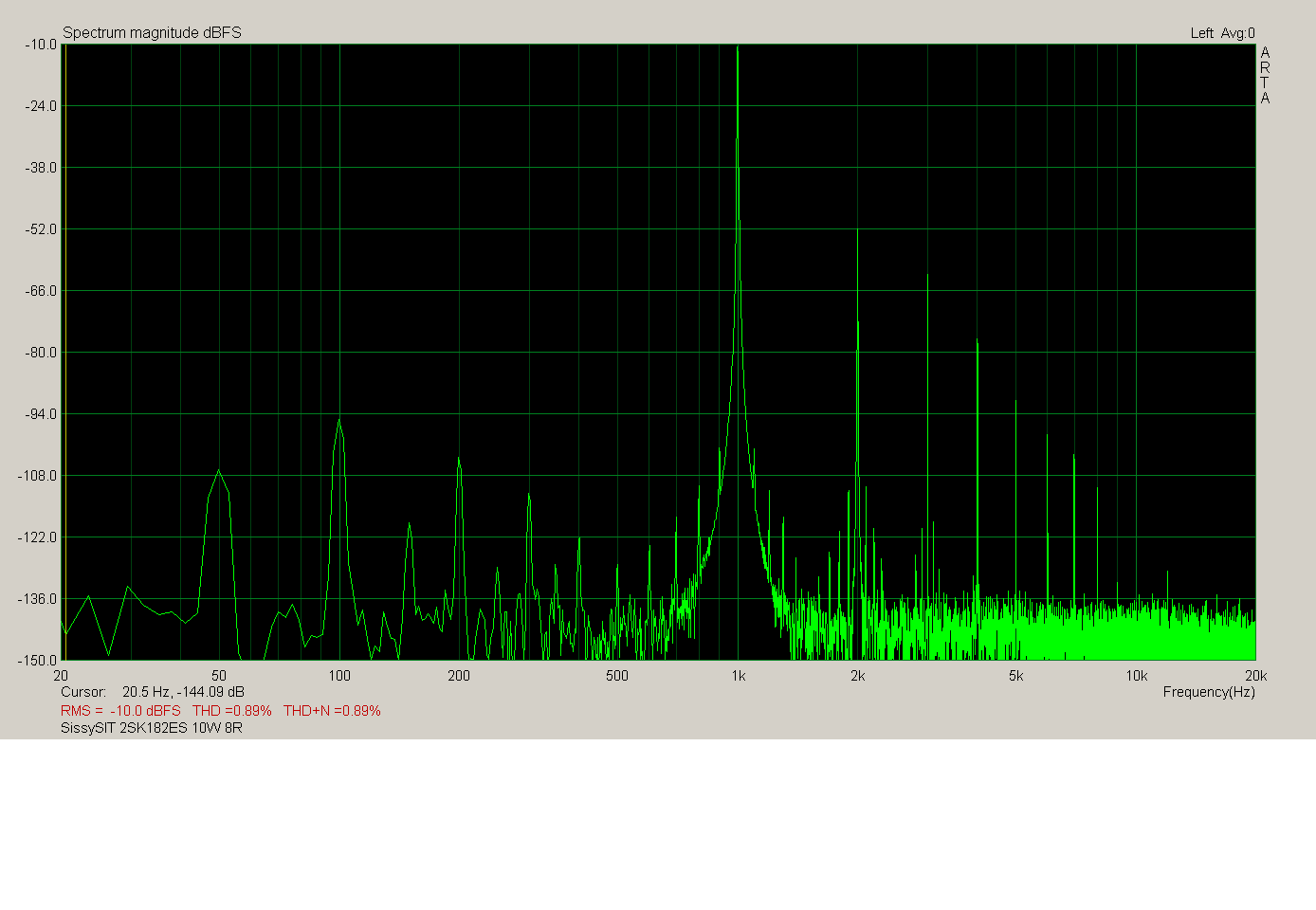

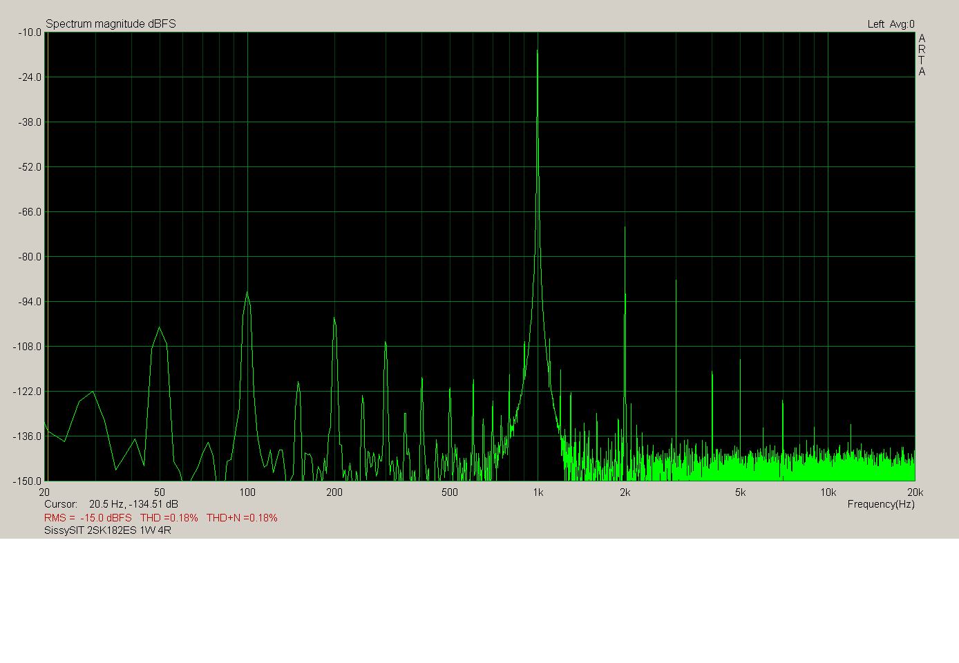

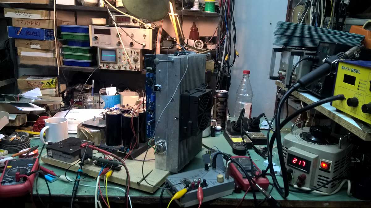

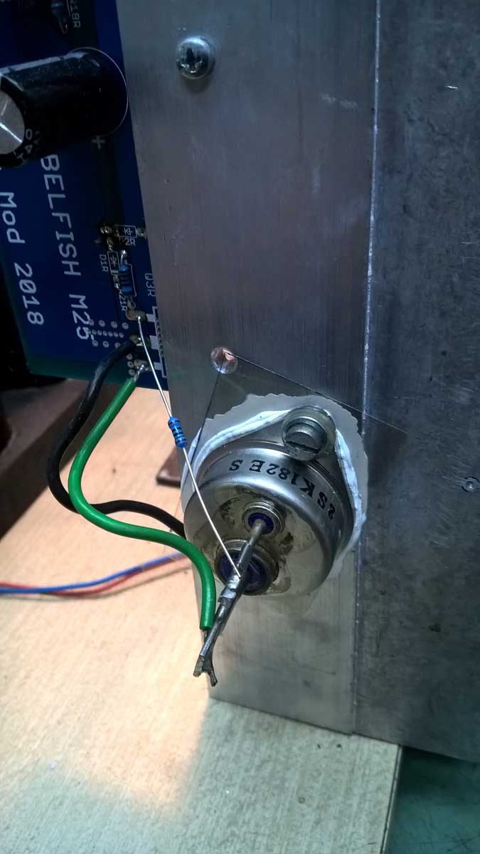

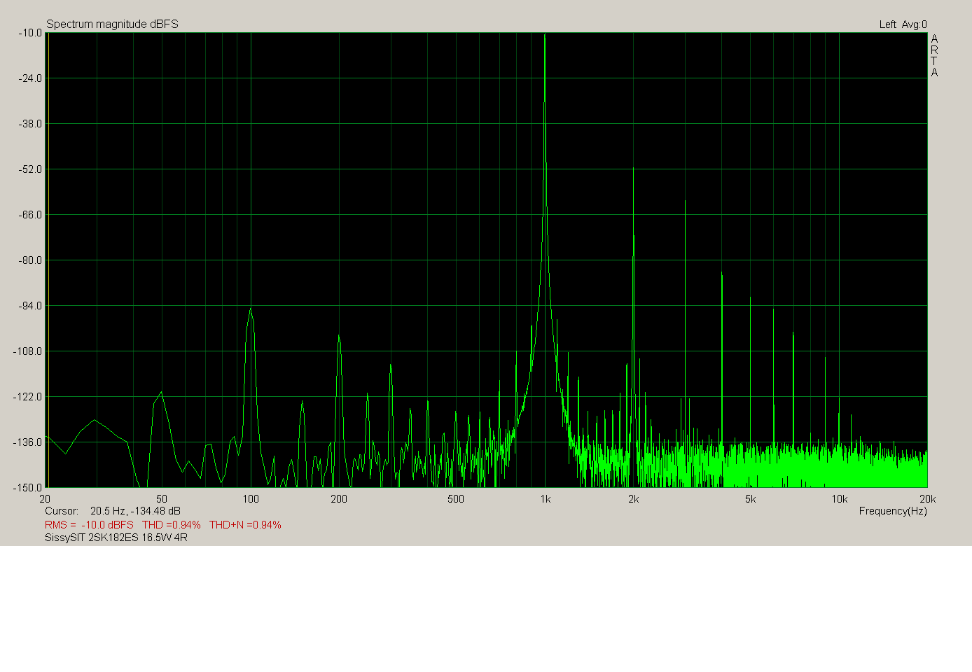

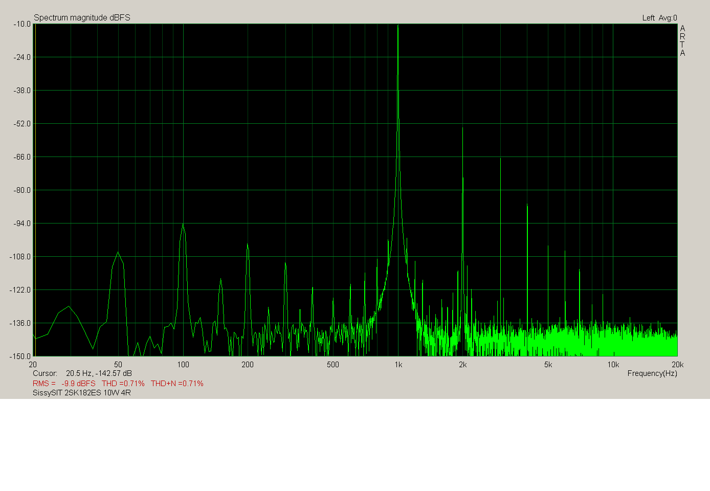

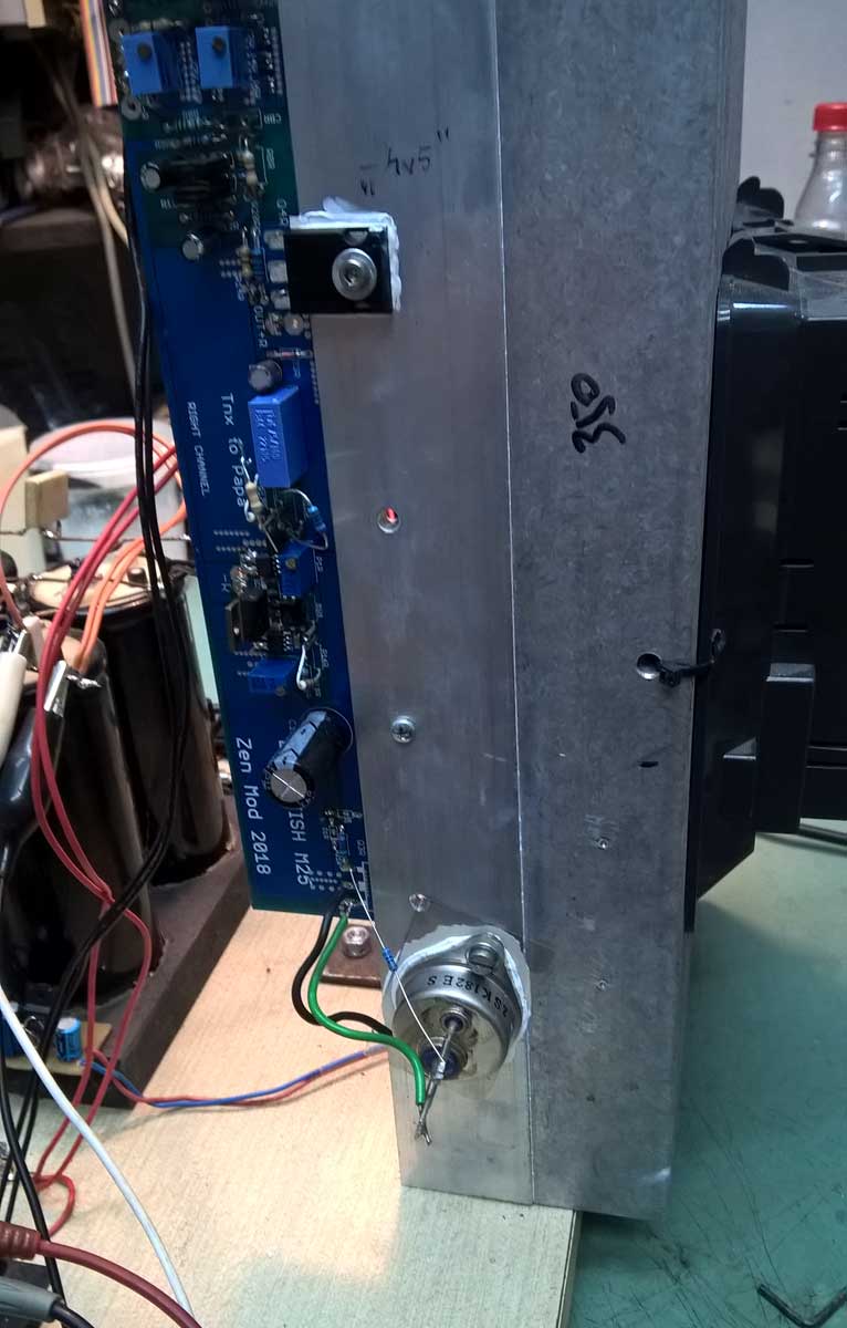

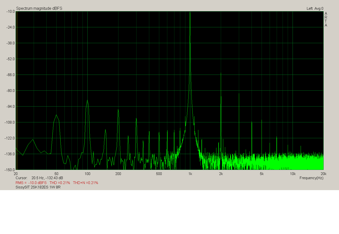

well , time for 2SK182ES tryout in SissySIT circuit .....
chose channel of T-Bed Sissy with mosfet having Ugs of -4V5 @ 2A , backed down with Iq to 500mA , removed THF51S and mounted 2SK182ES with Ugs of -4V0 @ 2A
re-set da Beastie to approx. 1A8 Iq and decent output offset
1W 4R load
read captions on graphs to know which is which
1W 8R load
- SissySIT
