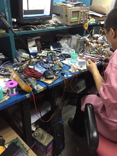

This is the material I prepared (the experiment has not officially started yet, because the voltmeter has a problem, it stays there all the time and does not return to zero. I will buy another voltmeter tomorrow to replace it) : according to # 81
Everybody take a look at it for me, right?
I have not turned on the power, everything is imitation state, has not officially plugged in power
Let's take a look. Is that right?
5 a current meter
9 v battery
10 v voltage meter
1 w 1 k resistor
10 k locator
24 v power supply
24V dc fan

I think that you need to mount THF-51S on some heatsink...
Small feet = G
Big foot = S
Substrate=D
Everyone said: Right?
Yes all is OK 🙂
