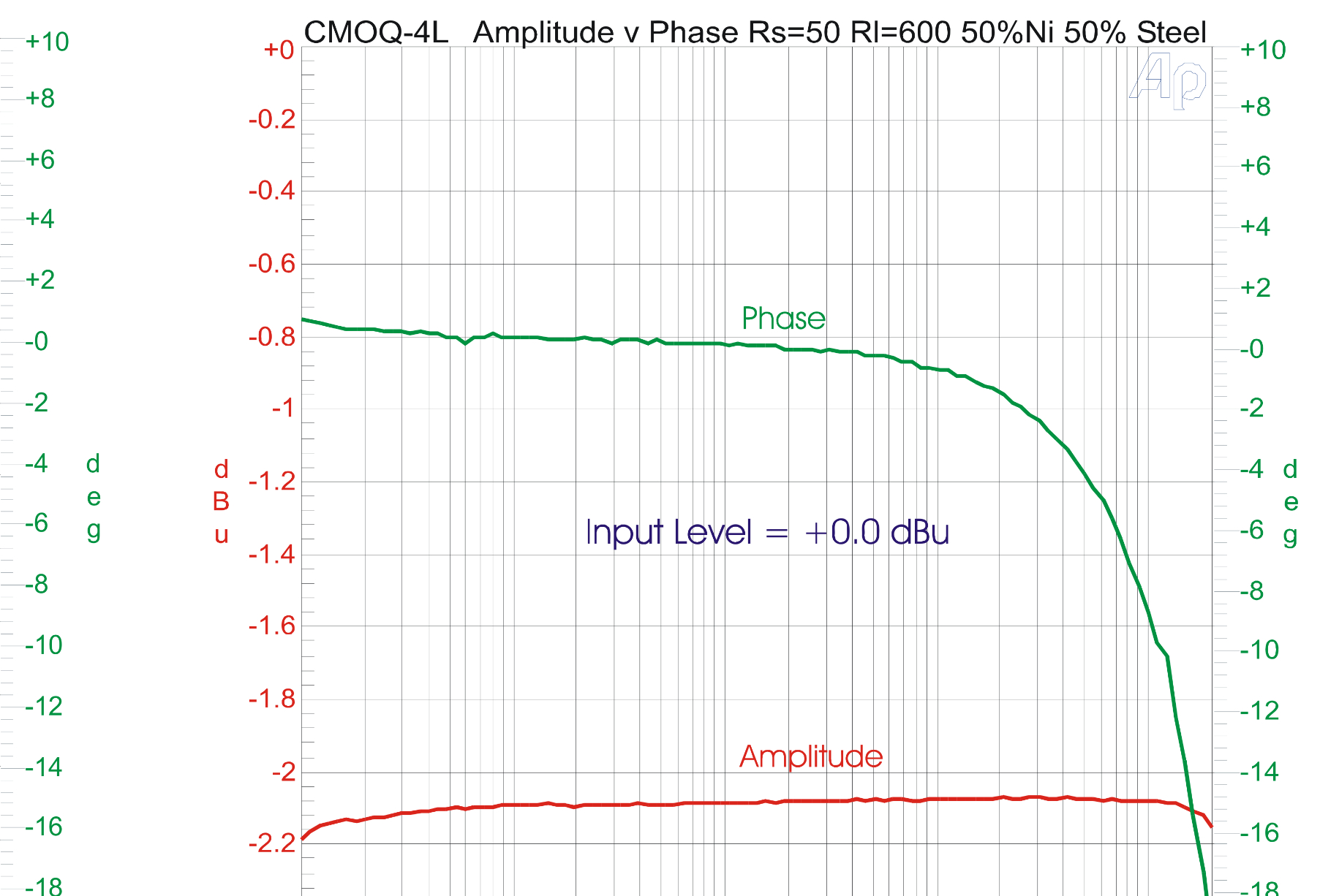

Cinemag CMOQ-4H 80% nickel is on my need a try components list.
http://cinemag.biz/output/PDF/CMOQ-4.pdf
After what I see on datasheet CMOQ-4L is 50% nickel | 50 % steel
Do You agree with me ? Yes some confusion on the web page ?
Interesting how much is price difference and audio satisfaction performance ?

Cinemag confirmed it in email, so i changed my order for the HighNickel version(CMOQ-4HPC), costs about 10 bucks more, they were happy to change the work order and invoice me the remainder.
Excellent Kris0603 !
so now we can build SissySIT "de luxe " with 80% nickel Cinemags.
Good for experiment on M2 etc.

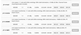

Dropped Cinemag an email. If they get back to me I’ll add the CMOQ-HPCs to my stockpile to compare with the Jensens.
Do You have stockpile with 80% nickel Jensen transformers ?..Dropped Cinemag an email. If they get back to me I’ll add the CMOQ-HPCs to my stockpile to compare with the Jensens.
After prices I see on the web page Cinemags is a good deal
Oh, Mighty ZM!
May you live a thousand years!
I suspect he has already accomplished that.
No just the standard Jensen JT-123-FLCPH with 50% nickel.
Yes the high nickel Cinemags seem like a real bargain. I already heard back from Cinemag via email. They’re going through some server based phone system conversion. That appears to be why I didn’t hear back from them when I left a message. Placed an order for the High Nick Cinemags. They’re gearing up for Pa’s big order. Hopefully they squeeze out a few for us small fish.
