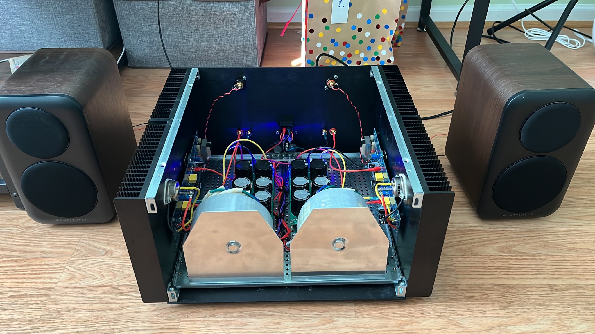

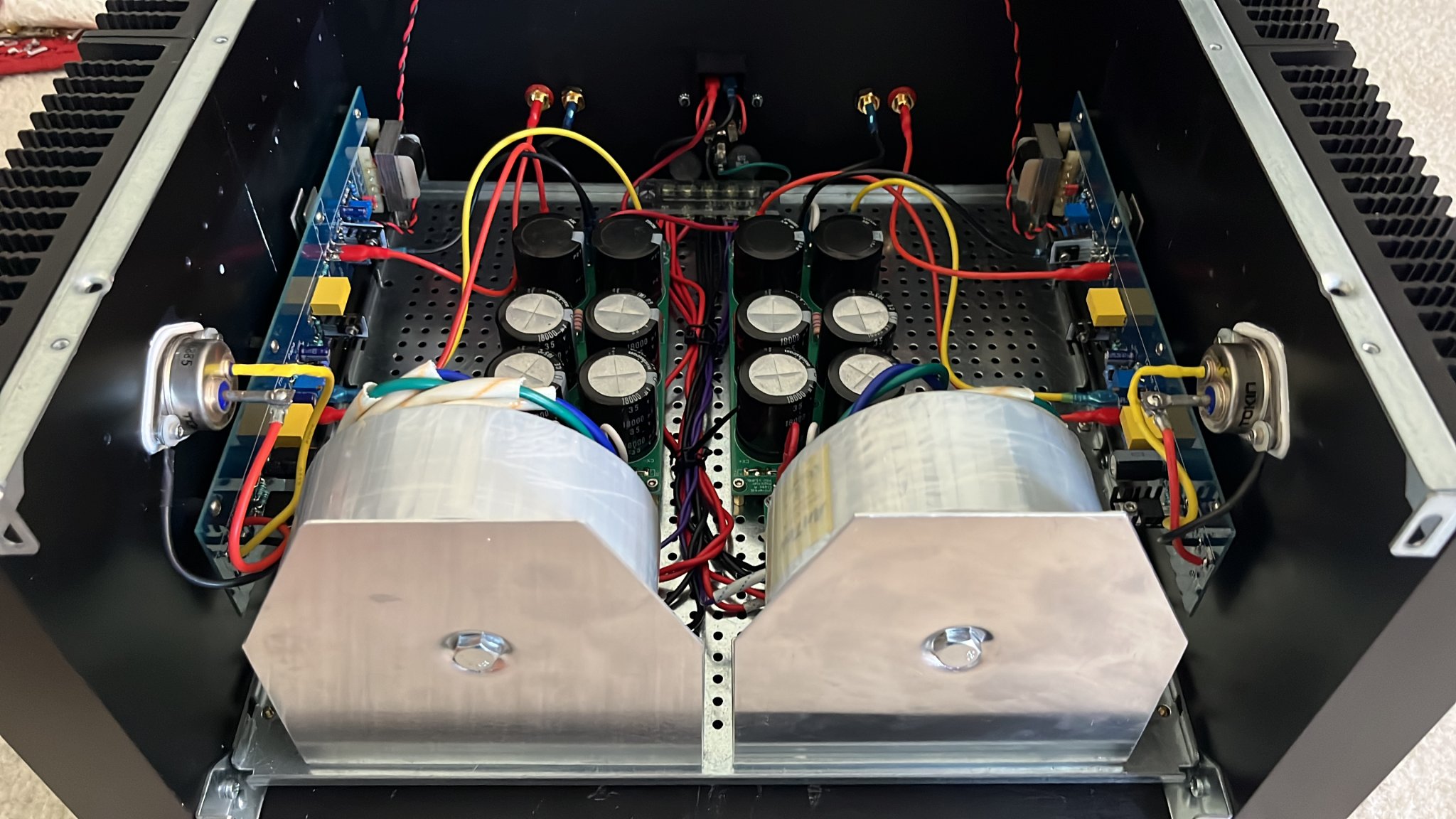

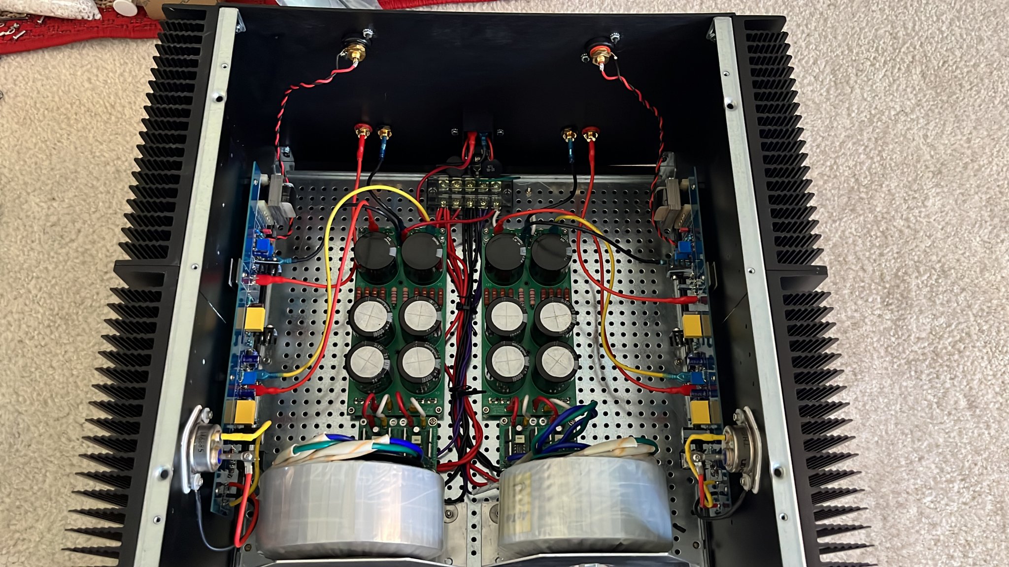

Thanks, and yes I am using the 5U/400mm cabinet so good amount of sinking is available. And I do see that one channel which is ready gets nice hot in my cold winter here within an hour160mV is just arbitrary mid point, on the way to final setting in thermal equilibrium
so, yes, 190mV-ish being goal figure, if you didn't skim off size of heatsink
yadayada, all other conditions must be met - proper thermal interface between output parts and hsink etc
Will try to finish the other channel too today and will give a listen initially with my bookshelf and later to my main setup with Waynes line stage or my HPA1 clone preamp and Klipsch Forte IIIs.
Rgds
Many Sissy owners claim it gets even better after at least 10 hours of operation.First impression of this Sissy is
I found this to be the case, personally, even though I know electrical engineers would state otherwise.
Love my SissySIT.

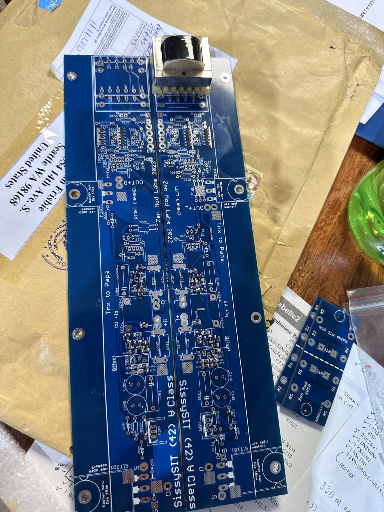

if in doubt regarding appropriate schematic, just buzz
just few teasers, not best angle for pic, but clear enough
finally found some brain to arrange with (one of) my winder(s) to have custom chokes for my concoctions
4mH, 0R15Rdc, good for 4A with no sweat
will use that (CLC) instead of usual CRC (R being 0R1/5W)
caps are 33mF
if CRC was good, this one is going to be goodgood
