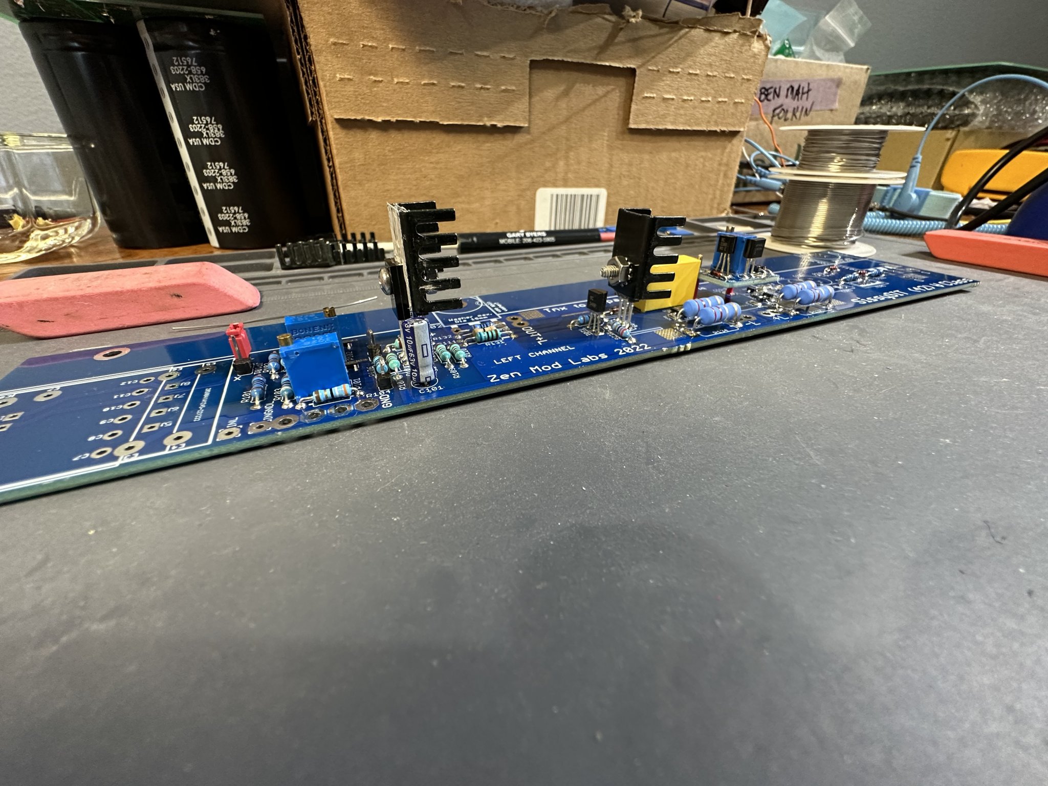

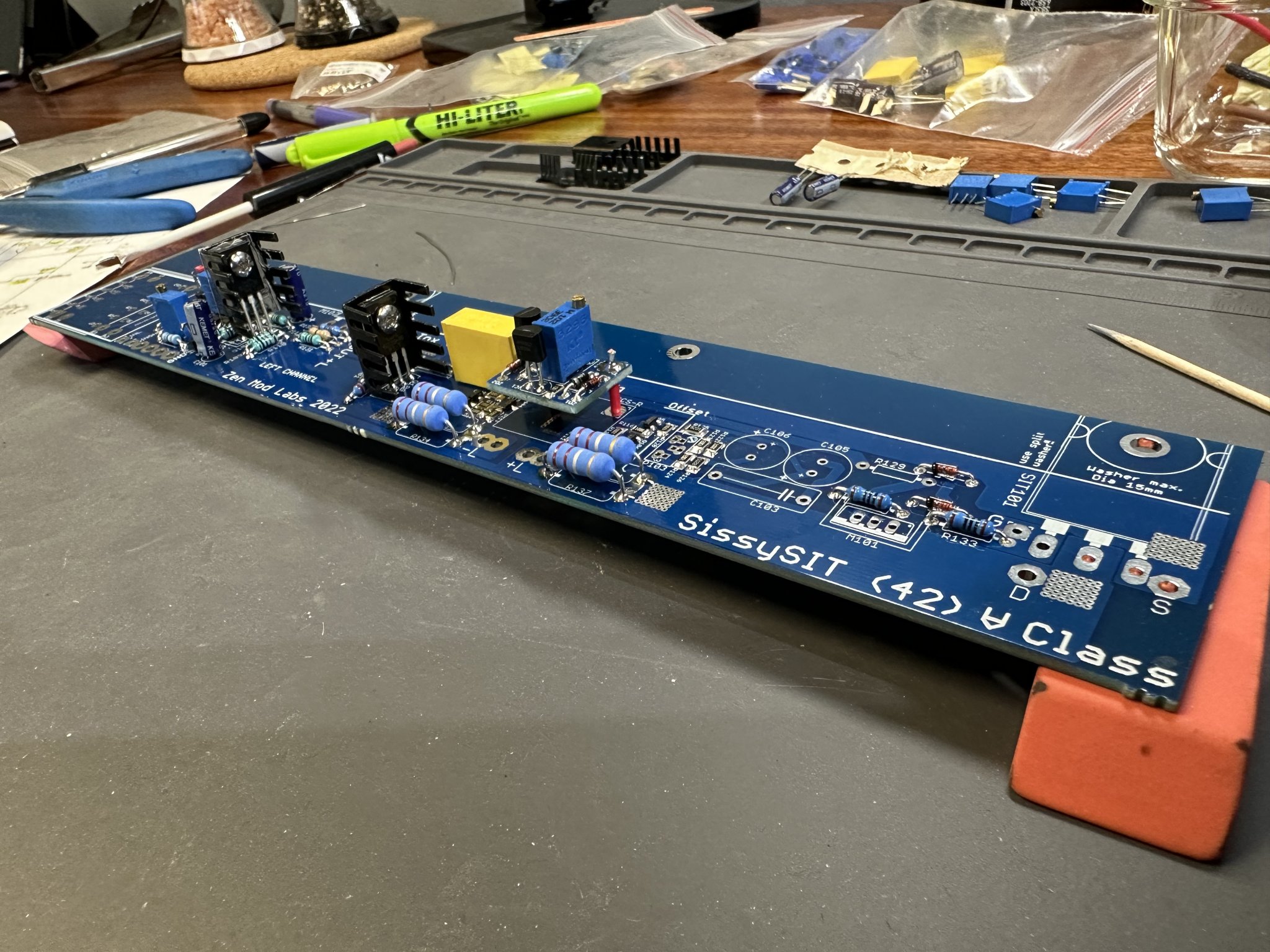

rotate those heatsinks on BD critters to have longer side up; no danger of making short neither to pcb nor to pins
you can mount it that way on IRF510, bigger back, no danger
you did put mica pads and goop, on BD critters couple?

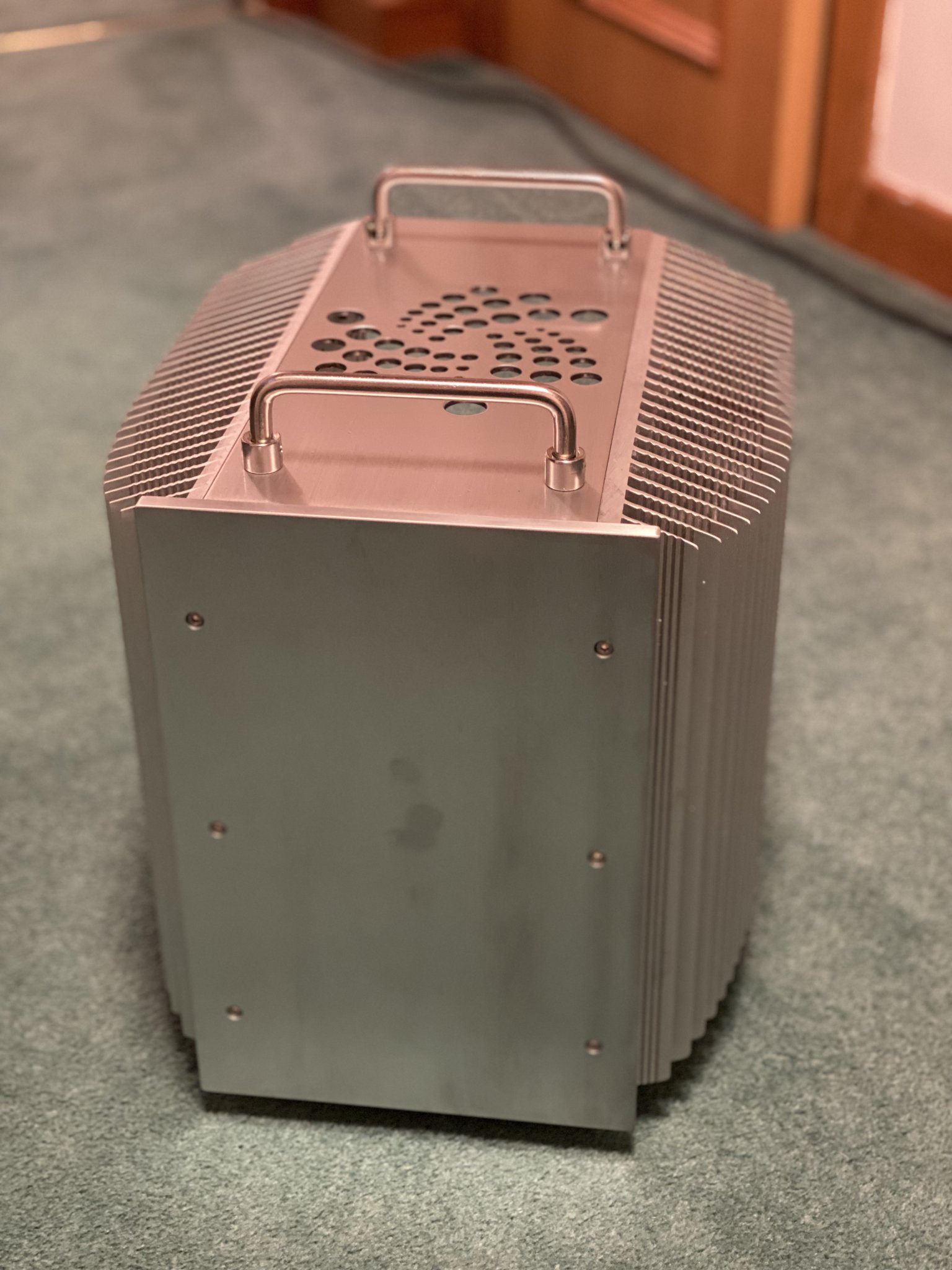

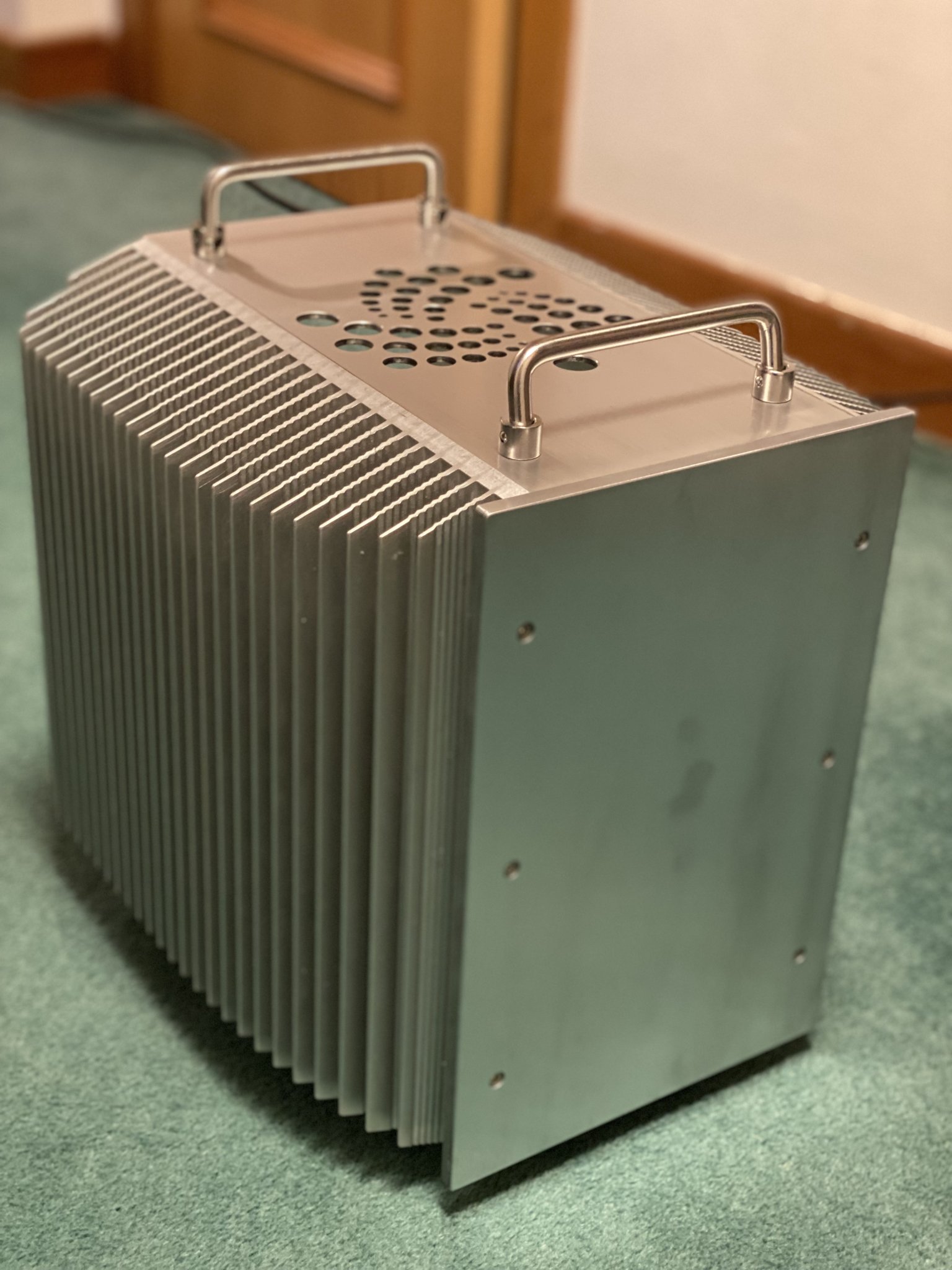

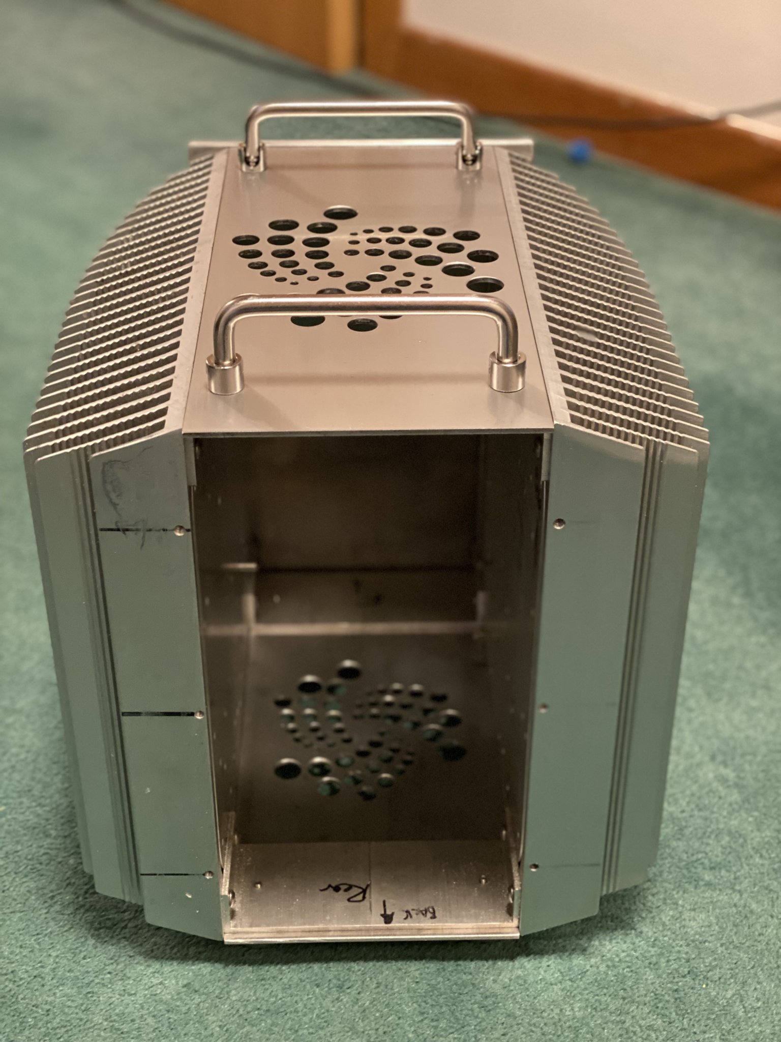

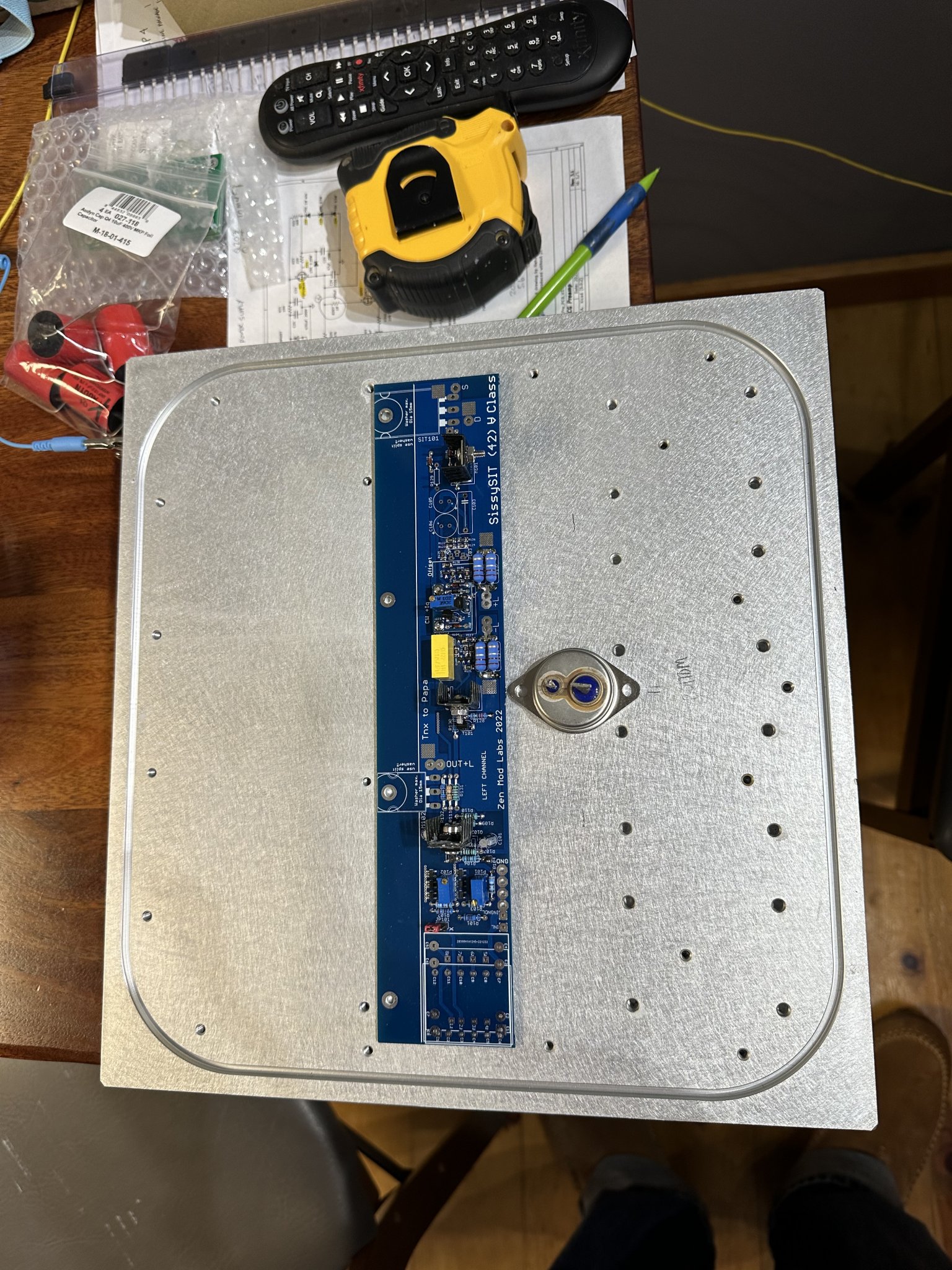

The case is getting there, boards are built but not tested. Taking my time and doing all the fabrication by hand/pillar drill/ files etc.

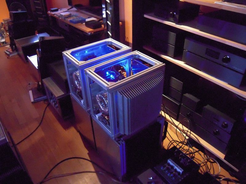

Shout out to Nautibuoy for the inspiration.

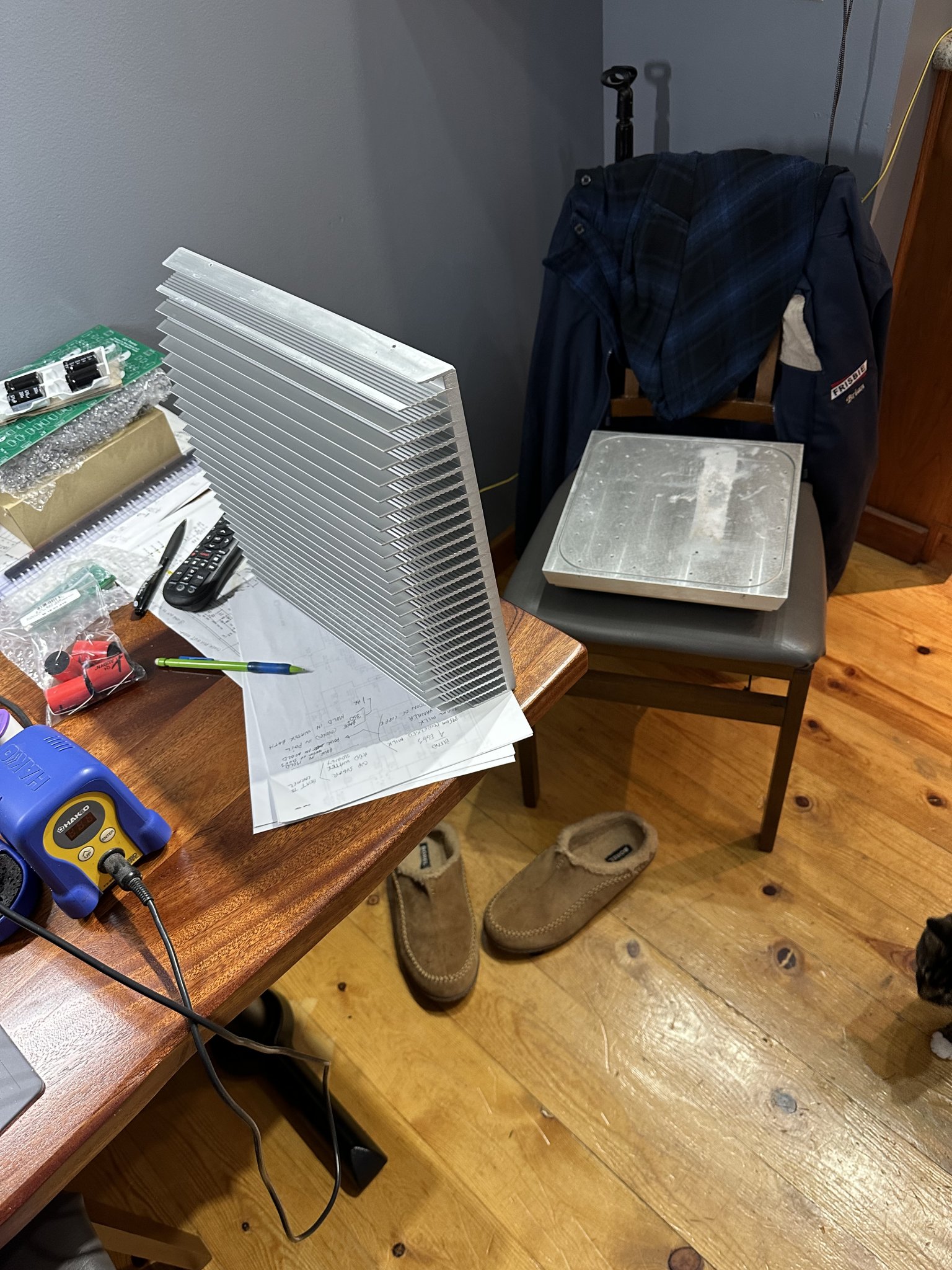

Those heat sinks are beasts, from solar inverters and priced very reasonably if you are in the UK that is.
https://www.ebay.co.uk/itm/13359685...EI5gsRFQl-&var=&widget_ver=artemis&media=COPY
There may be similar in the US.
I purchased 3 a few years ago in the States for $25 each😉
Then recently another 1 from a UK seller, with shipping 😭 Ouch!

Amazing work and considering you did all the ventilations holes by hand you’re very talented.Coming soon.....

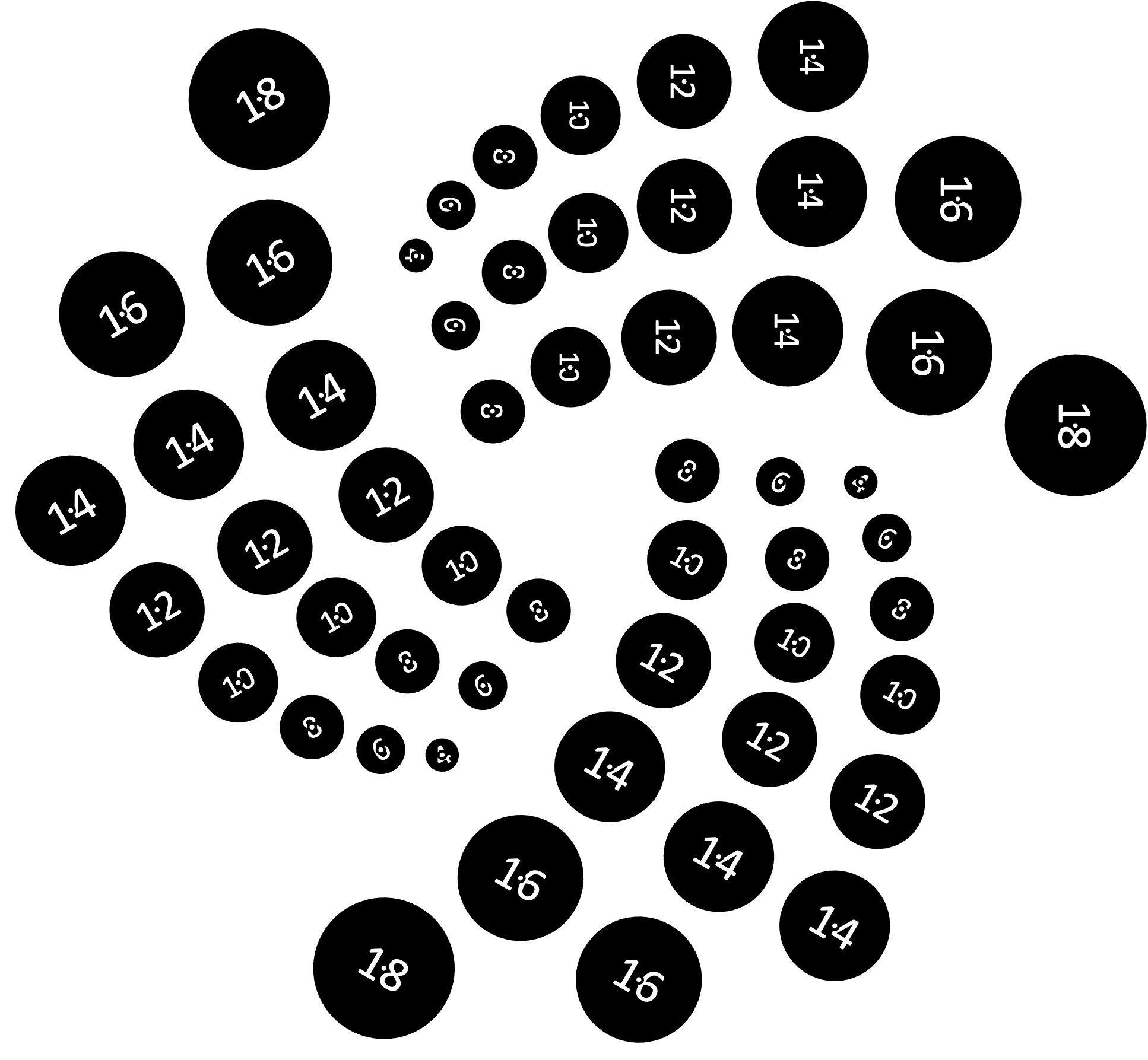

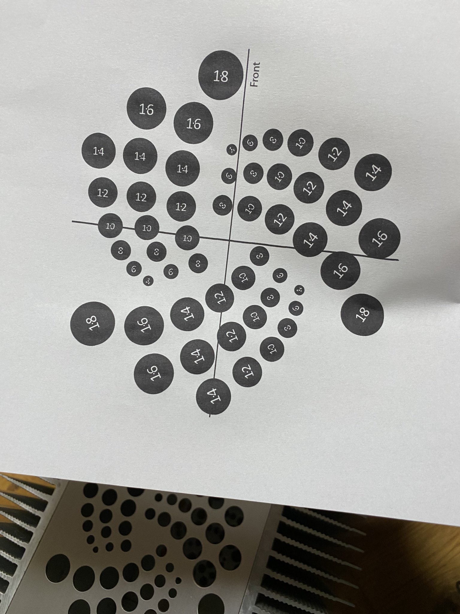

I created a template in Powerpoint, with the centres marked for centre punching, then drilled all with a 3.5mm drill bit. After this it was a case of carefully using a Step bit to drill 4mm, 6, 8, 10, 12, 14, 16 and 18mm holes. I glued the template to the plate so I did not have to guess the hole sizes too much.
