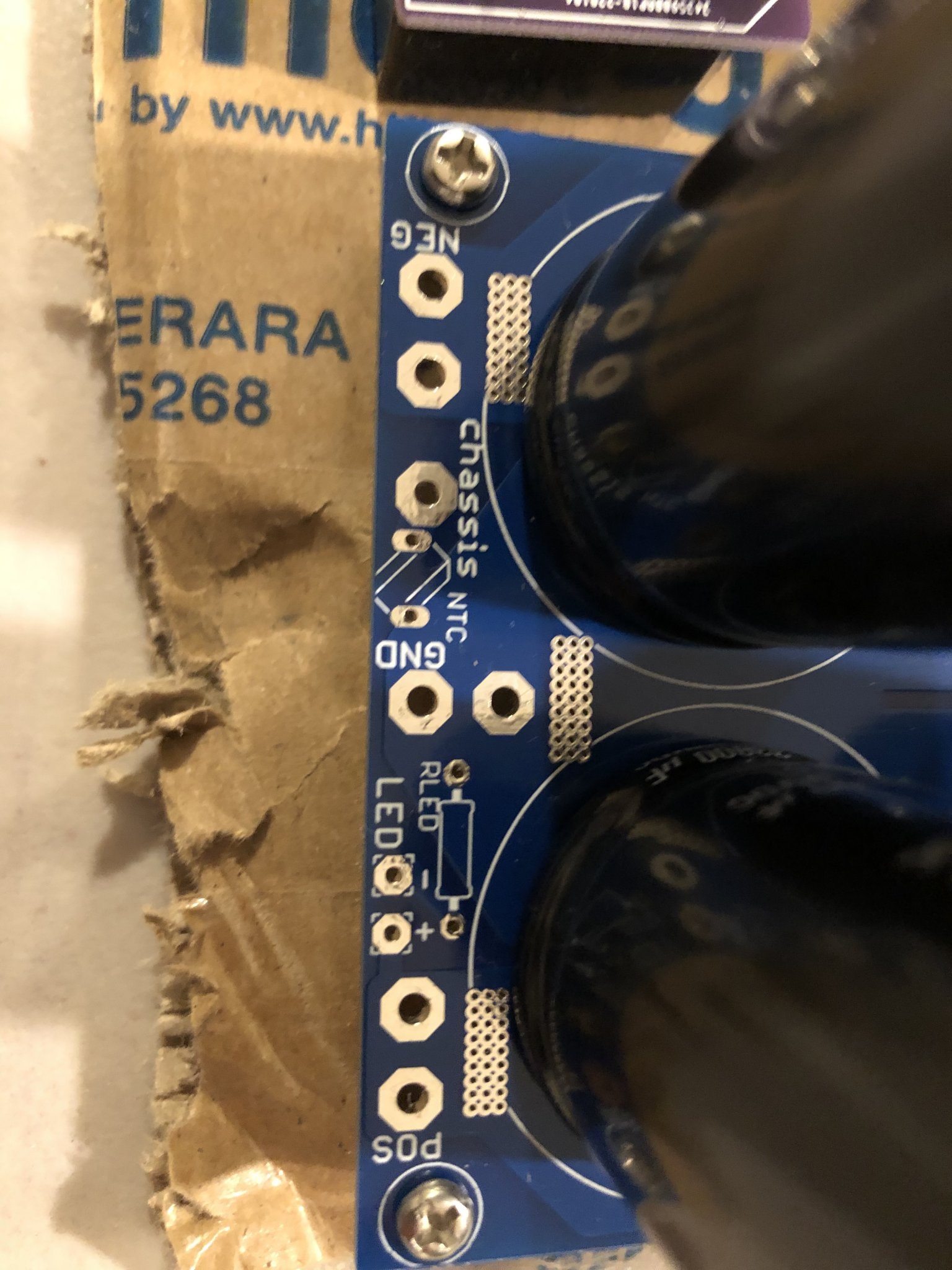

These are the CRC psu boards from @Nisbeth and its meant to be C+C+R+C with on board KBPC type bridge rectifiers. I bypassed the onboard rectifiers and instead using Prasi's LT4320 by shorting the bridge pins to take the +/- inputs from the external rectifier board. Works perfectly well and very stable output voltage.for what I know is better reverse the psu board..... to have diode >18k -R- 18+18k> out

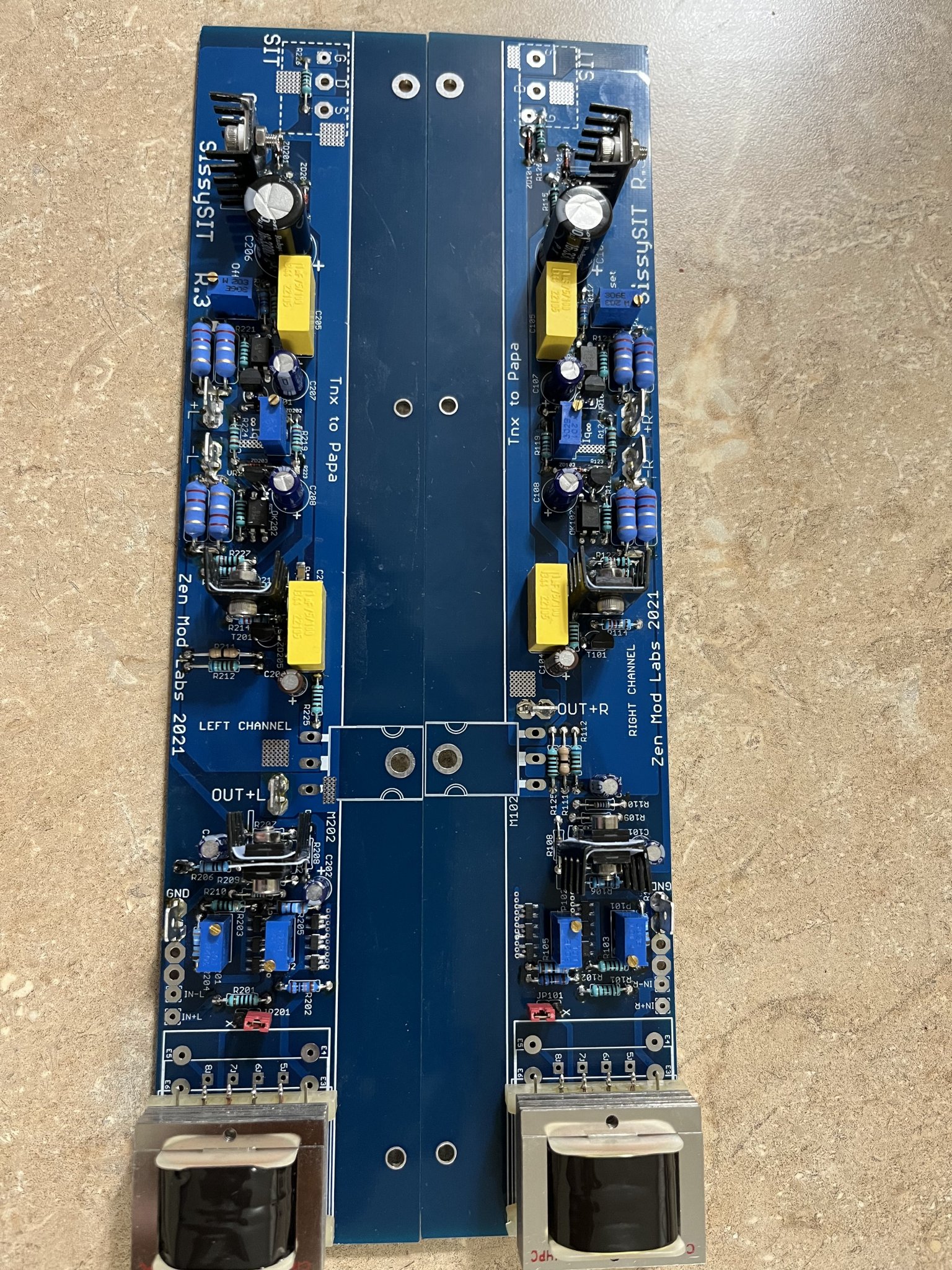

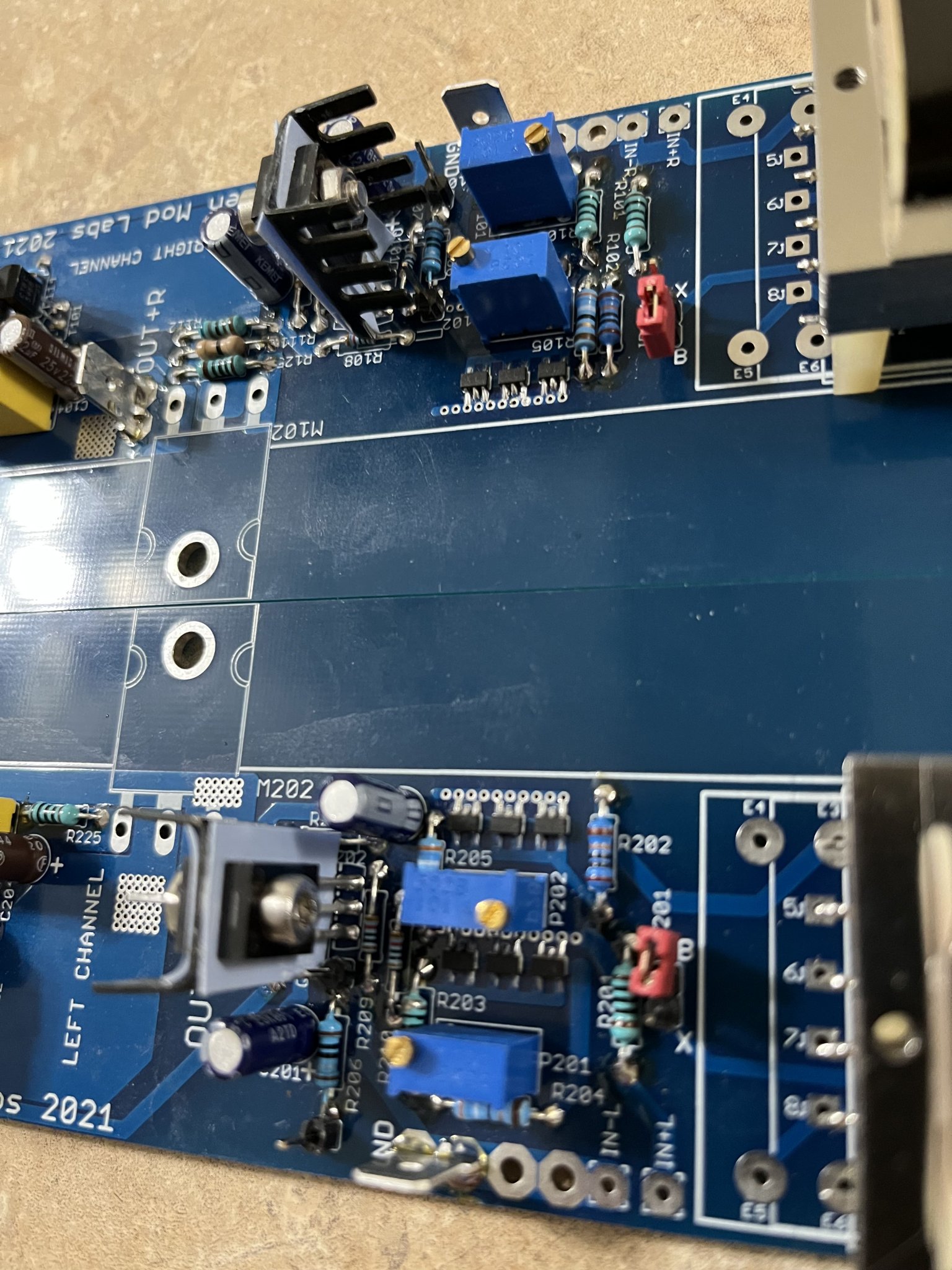

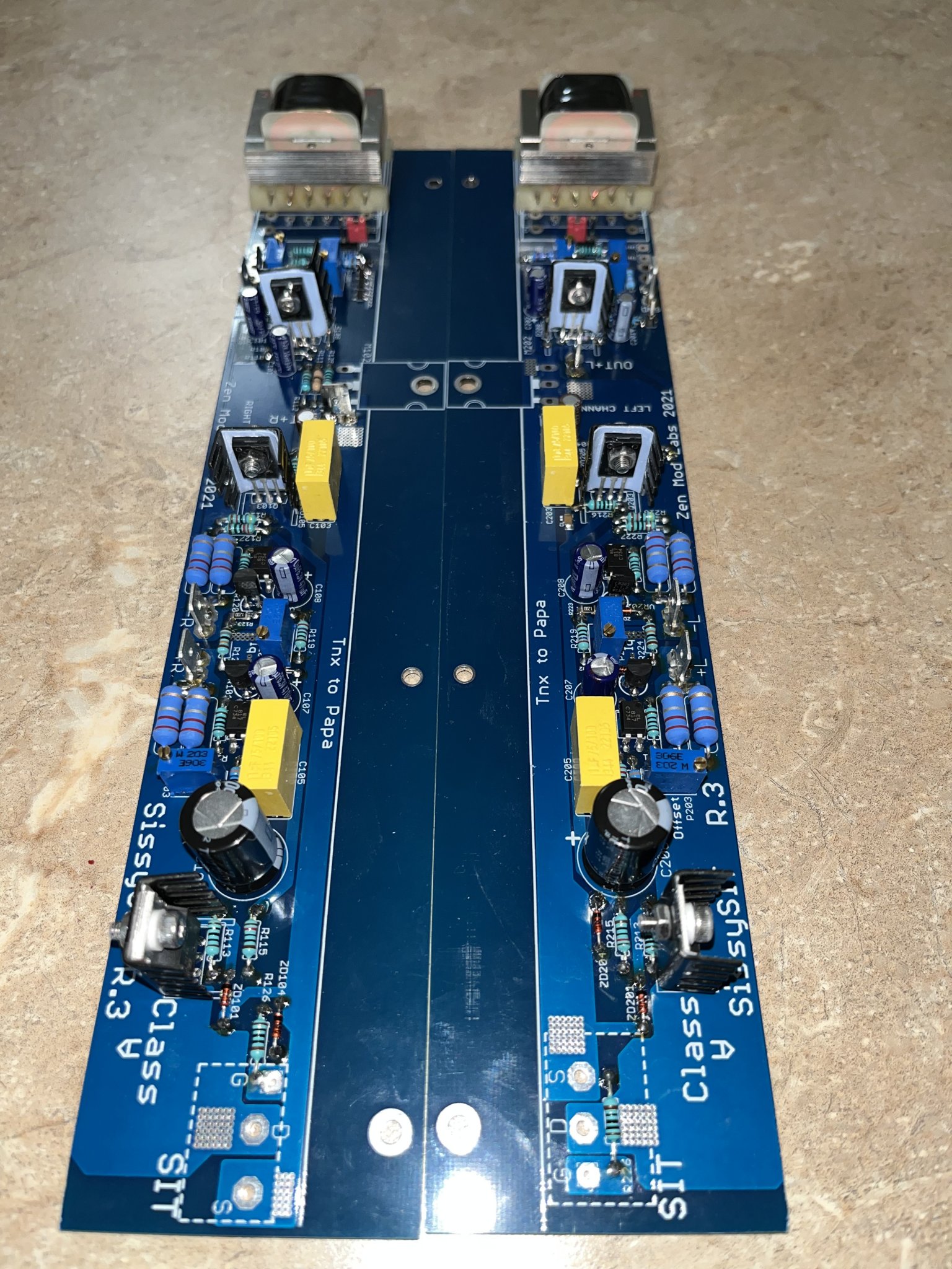

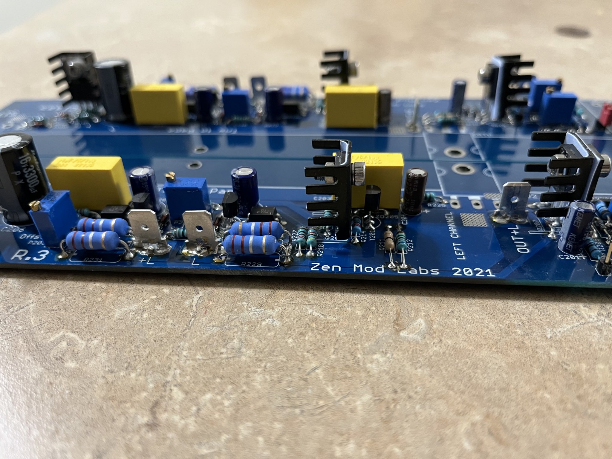

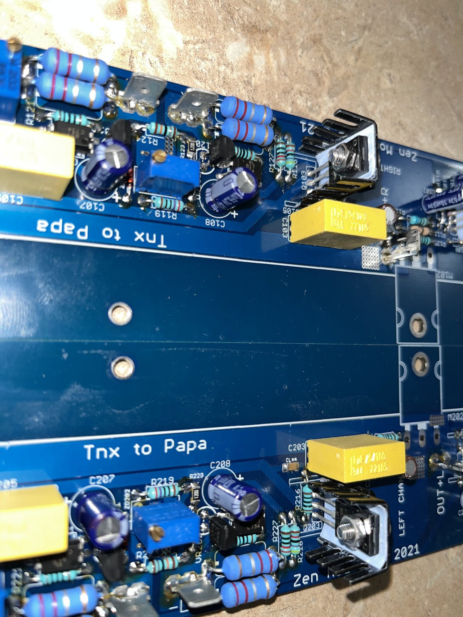

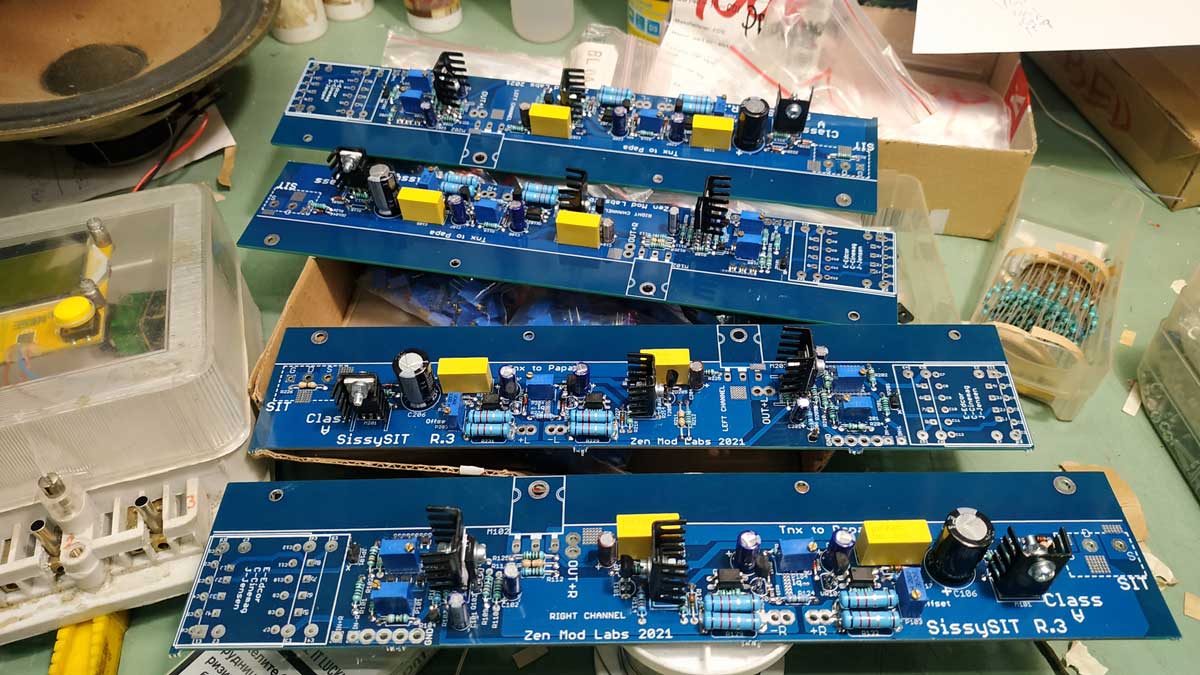

Almost finished the amp boards with some improvisation to cut the small TO220 heat sinks fins not to touch the nearby resistors which are pretty closeby. IRF510 used TO220 plastic bushes along with the thermal paste and mica and no shorting anywhere verified with the DMM. The Cinemag xformer was able to fit only one way with the pair of pins exactly matching on the pcb pad holes.
yep but wok better in CRCC ,the amp see double capacity and half ERS ,,,,quite simpleThese are the CRC psu boards from @Nisbeth and its meant to be C+C+R+C with on board KBPC type bridge rectifiers. I bypassed the onboard rectifiers and instead using Prasi's LT4320 by shorting the bridge pins to take the +/- inputs from the external rectifier board. Works perfectly well and very stable output voltage.
you could see on my pics that heatsinks on BD transistors are rotated for 180deg, so no need for cutting
Mica/isolator needed only for two BDs on same heatsink, you don't need isolator for solo part on heatsink
I thought about it but wanted to go by 'T' with the silk screen and works perfectly fine with this arrangement nowyou could see on my pics that heatsinks on BD transistors are rotated for 180deg, so no need for cutting
I meant upside down 180-deg
BD still being properly mounted/entire tab covered with sink, while rest of heatsink upwards
see attached - it's clear some heatsinks mounted "downward" (on mosfet) some "upward" (on BD)
depending of mood, most likely
anyway, you're good, this just for future reference

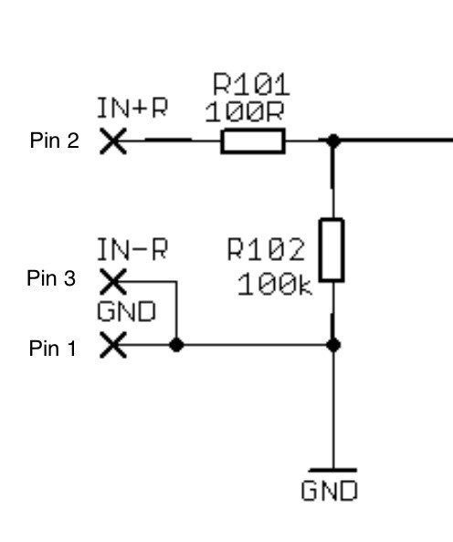

ZM - You got me! 🫢. I will stick with RCA jacks-only. Thanks!nope. this is strictly SE input
IN-R is sorta named just to confuse you
even if it's evidently connected to GND, why not mimicking Papa all the way

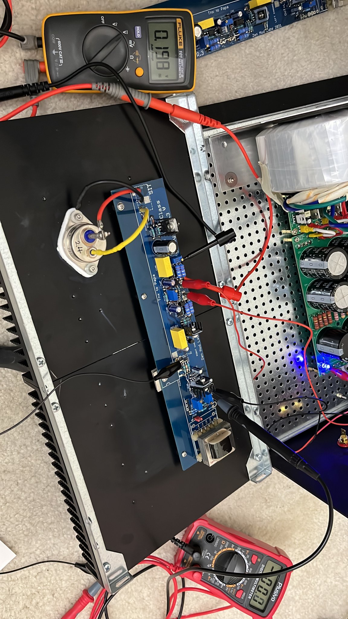

From these notes I was following on my first channel got a bit confused with how much Iq should I be aiming for is it 198mV or 160mV as across paralleled 0.11R resistor for 1.8A Iq I need to set for 198mV right?...... or - Look Ma, with no hands,Beast with thousand iterations!!

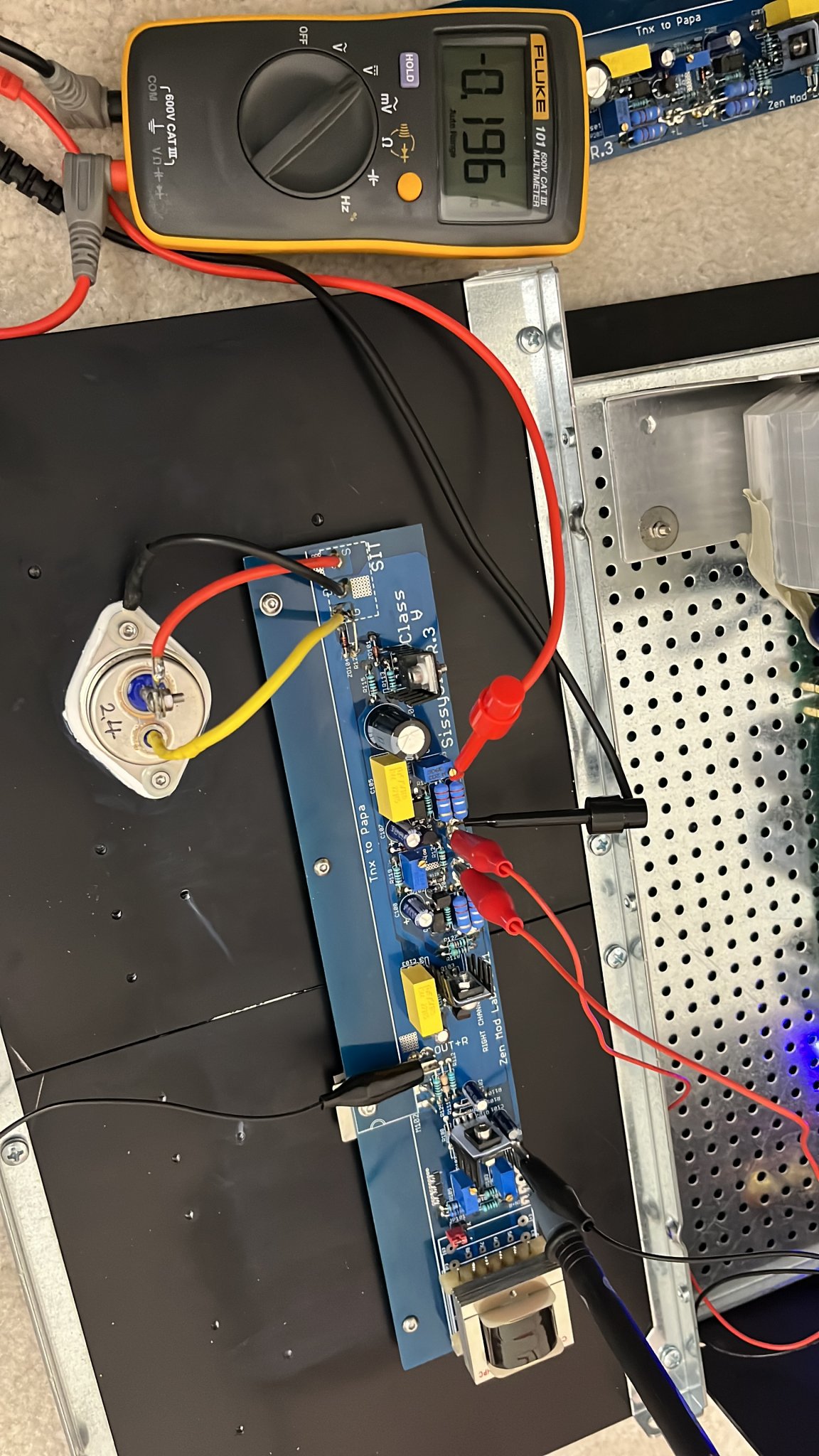

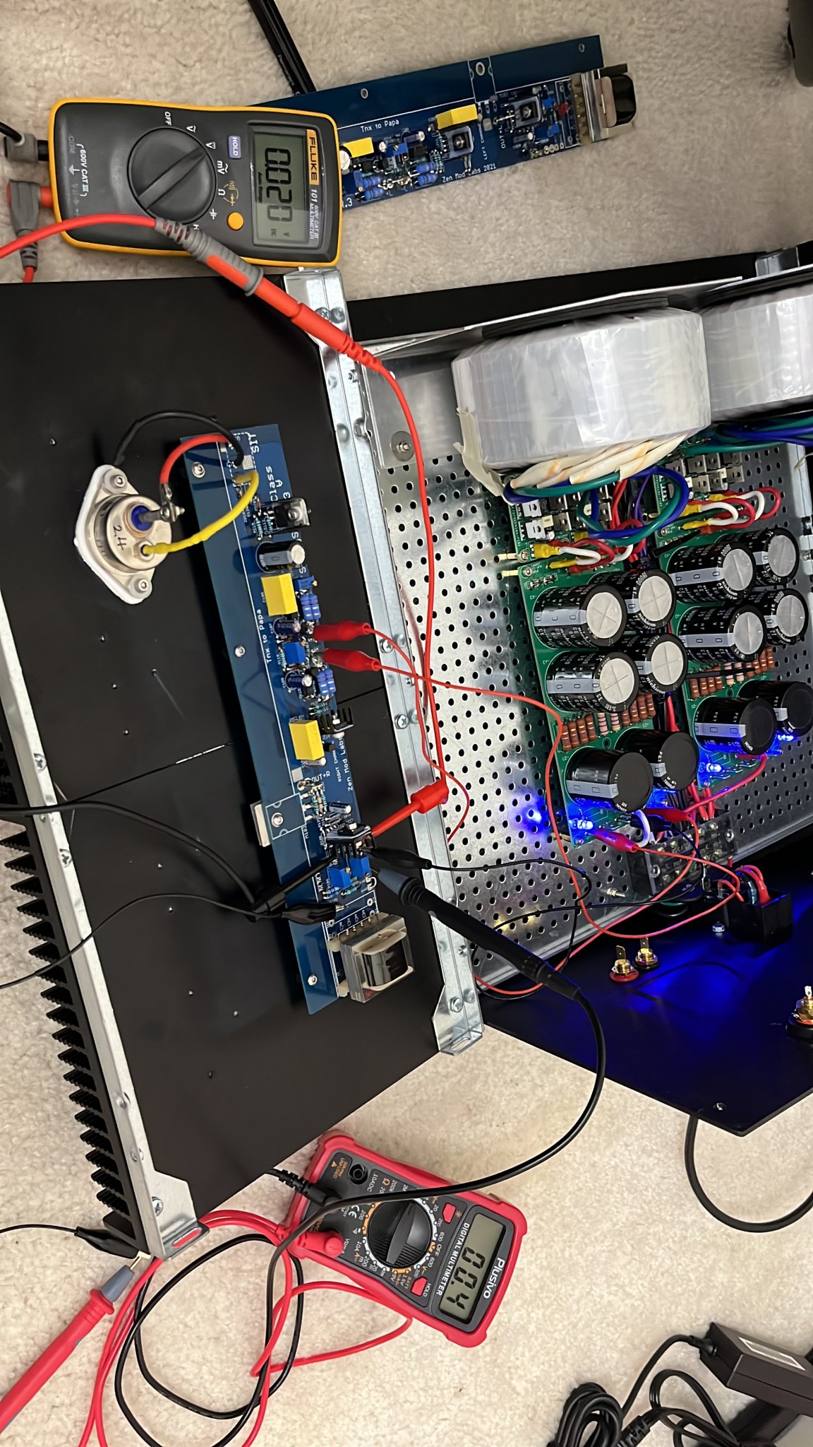

I could complete the right channel and everything worked as expected with the Iq target set to 198mV (1.8A) as I am using a 5U/400mm chassis. Right now the sinks are nice hot could be because of no air gap being upside down but standing vertical and Chicago weather they should hold on nicely. I could get the DC offset to almost 0.00mV and very stable bias too 198mV.
@Zen Mod sorry my question got lost post my picturesFrom these notes I was following on my first channel got a bit confused with how much Iq should I be aiming for is it 198mV or 160mV as across paralleled 0.11R resistor for 1.8A Iq I need to set for 198mV right?
goal is , , say for 1A8 of Iq - 1A8 * 0R11 = 198mV
keep fiddling to get mV creeping up, and once when you see steady rise for each turn, set da thingy to - say 160mV
The above is where I had the confusion from the notes of your first post. I have now set the bias to 198mV based on the above 1A8 of Iq - 1A8 * 0R11 = 198mV and ignored the 160mV comment. As I see all the notes references for the Iq being 1.8A so to achieve that on 0.11R its going to be 198mV.
