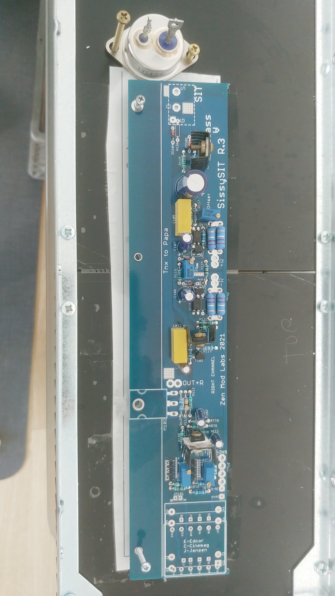

count on rising base plate (if you have it) for 8-10mm, so you can route mains wires underneath
lip up
how to - on any of my builds pics
longer M4 screws for base, risers - usually 3 pcs of M5 nuts are enough as riser, on each M4 screw before putting da plate in place
lip up
Thanks, I have been looking at pics of your builds and noticed you put the plate lip up and used nuts to space it up.count on rising base plate (if you have it) for 8-10mm, so you can route mains wires underneath
lip up
Since I'm in the US, using US size screws, 4-40 and 6-32 size for mounting the PWBs and SITs. Planning to use a #8 size for mounting the plate.

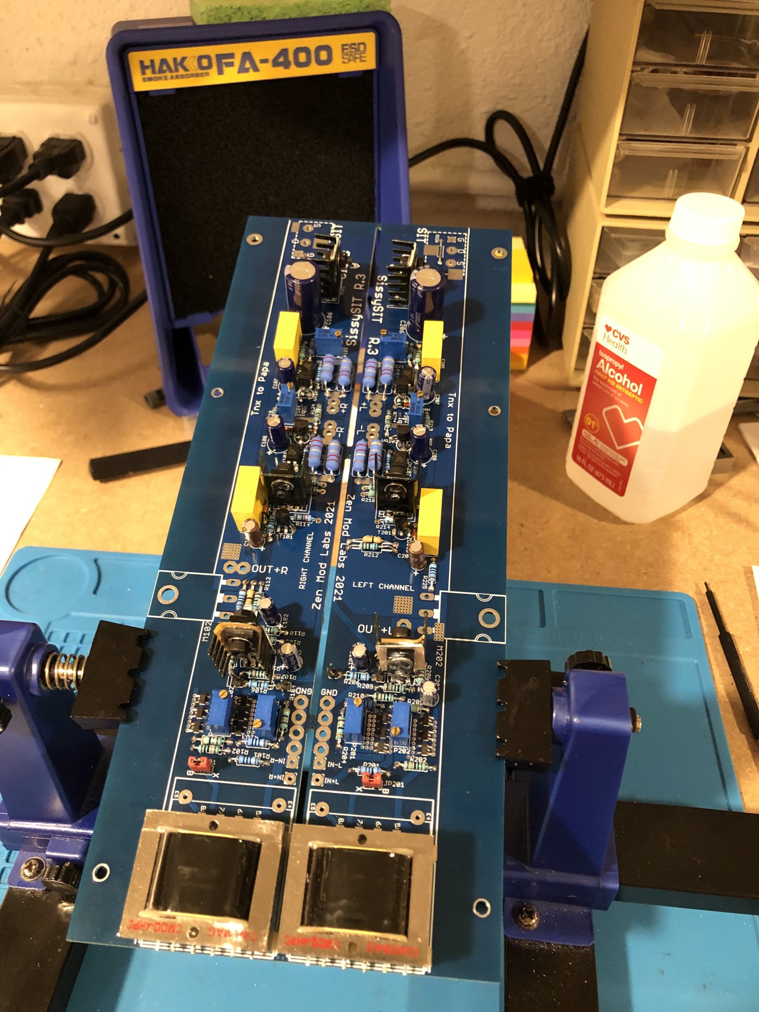

Another SissySIT R.3 coming to life. The boards are done and I have PSU parts and Modushop monoblocks on order...
Got it, thanks! I left them on so I wouldn’t lose them.don't forget to remove jumpers and put them back only after setting input buffers
- SissySIT R.3
