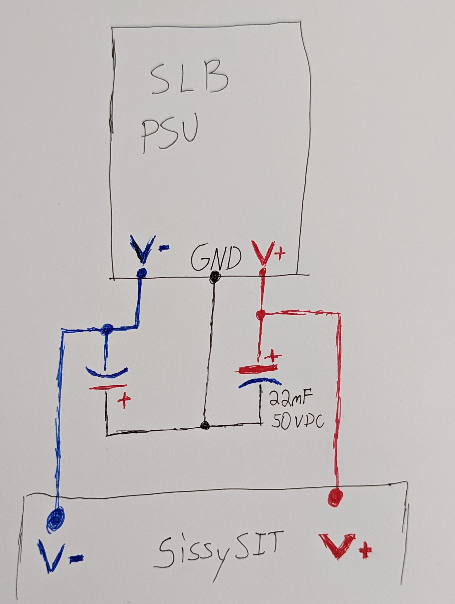

Hi Mightiness,
independent of the amplifier, what capacity should the additional cap bank in the amplifier have?
I have 132mF per rail in the PSU, is 10mF in the amplifier okay?

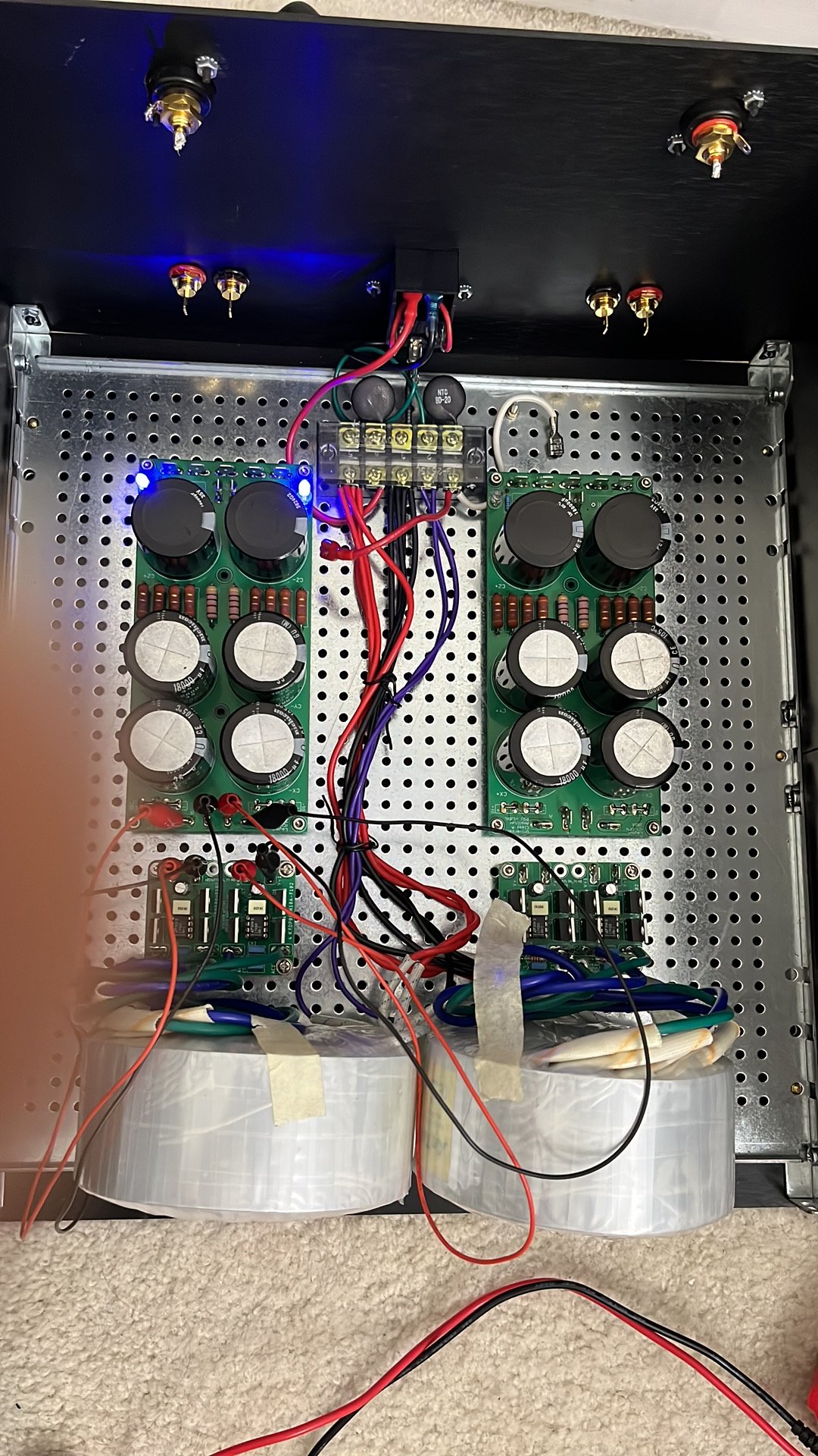

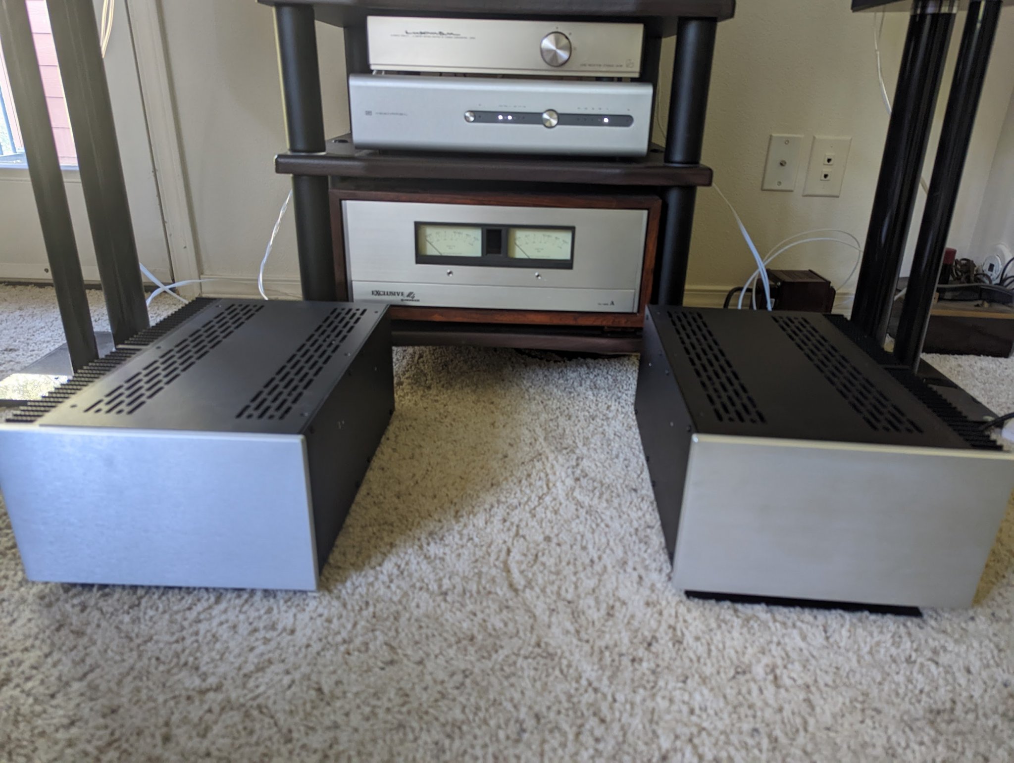

Finally have completed the monoblock conversion of my build...
It's still early for full impressions, and I'm currently using only GR Research modded Klipsch RP600Ms (my weakest link in the system), but boy, oh boy... these are special and more than worth the time and money to build. 🙂

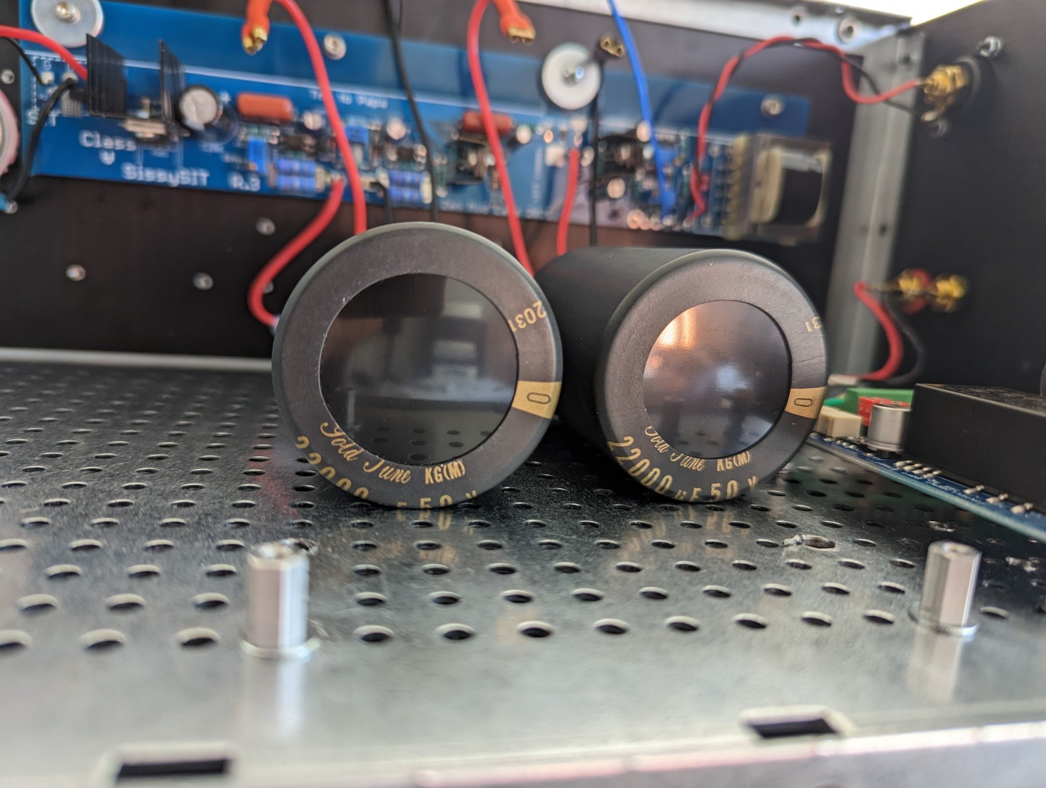

I ended up having to stuff the bulk caps below the PSU PCB.
I also ended up accidentally miswiring the trafo secondaries, causing a couple of fuses to pop. Fortunately, doesn't seem I caused any permanent damage.
I can't wait to hear these puppies sing with some high-end speakers. I wonder how they'd pair with the Spatial Audio X4 (4Ohm|93dB)?
Really appreciate everyone's help along the way for my first, big boi amp build. Ended up learning a lot. Thx to Papa and ZM! 🙂

I used some high-end thermal paste and Alumina pads just to be safer with temps. So far, it seems the temps are all good.everything fine ........... except - OS parts better on lower 1/3 of height, than on upper 1/3
meaning - exchange pcbs in cases
I also read somewhere that it's actually better to have the heat source located towards the top as it creates almost a chimney effect, allowing the air interface to naturally circulate from bottom (cooler) to top (hotter). Don't know if it's true or not, but it made sense to me.
I'll keep monitoring temperature to make sure, tho.
I do find that the internal temps of things like the trafo housing and PSU is a tad (few degrees or so) warmer with the lid on vs without the lid. Probably expected, and likely don't want even more holes due to structural rigidity, but just an observation.
