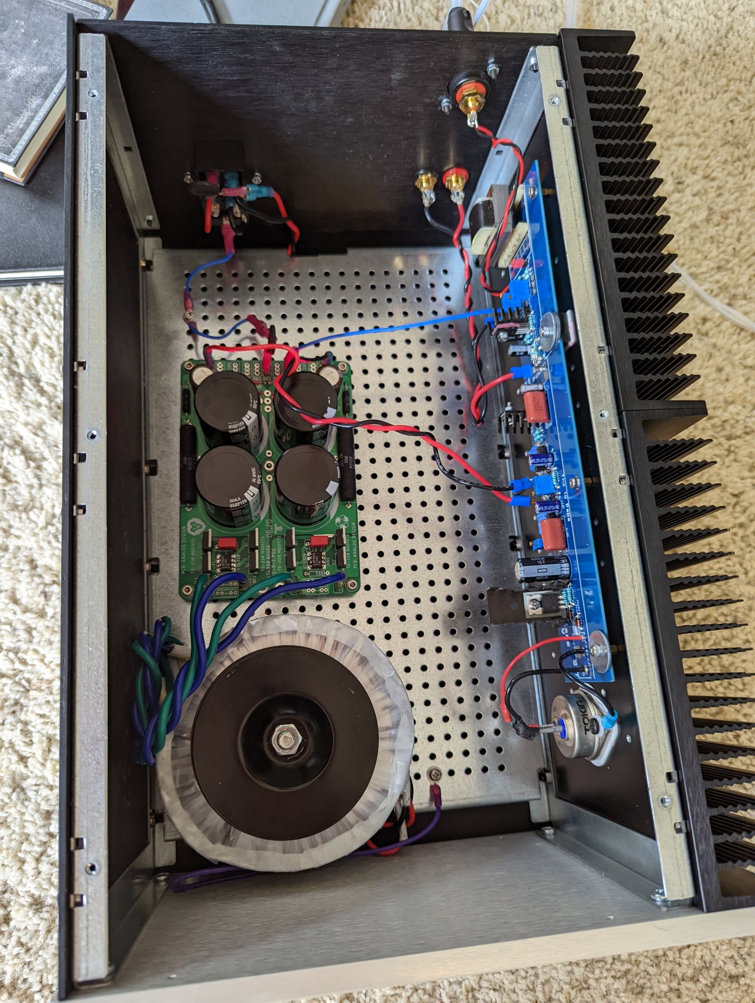

Got the right channel converted to a solo monoblock chassis. Was hoping to eliminate the sight hum, but it's still there, albeit quieter than with everything in the single chassis. I have to have my ear literally right next to the woofer to detect it.
Having the RCA input plugged in or out doesn't affect it. Does that indicate that it's not a ground loop issue? I was going to say, I'm using a CL-60 between my PSU and earth, so it should be sufficient..?
I moved my IEC further away from the amp board to try and aid in keeping EMF away from the input.
Honestly, it's not loud enough to detect from the listening position, but there's that "you didn't do it right" voice in my head. 🙁
well, it's either Donut magnetic field coupling to input autoformer, or it is PSU unit
maybe it's worth trying coax cable from RCA to pcb
one more thing - I'm always tying all wires to chassis on one bolt, near mains IEC; I see that you have one in front, most likely static shield wire
one more thing ...... channel pcb - that one needs to go to other side heatsink ( you swapped them between cases, so to speak) so that output mosfet is on lower 1/3 of heatsink height, not as you mounted it - in upper 1/3
Some suggestions:
- rotate power transformer to find position of lowest noise
- move AC wires from middle of case to far left side against left wall of case, tightly twist wires
- twist PS ground wire with V+ and V- wires to amp board V+ and V- connection, then continue ground wire to ground connection
- tightly twist all wires

Is there enough chassis width to rotate the psu board 90° CW so the wiring is short and direct?

I re-used a 5u chassis from my old Aleph J. See post #720 of this thread. i specifically ran the power wires under the perforated base plate to the transformer, which is at the front of the chassis, and enclosed it on bottom, top, and 2 sides by the perforated steel plates,
I also use the “balanced” XLR plug. I know the negative lead is grounded, but I have no hum.
Most of us put mu metal shielding on M2x amp input transformers, but my SissySIT has not needed it.

I think I'll give the adjustments in orientation a shot, as well as the mu metal. I have a feeling that the IEC inlet is the primary culprit, with the input and input xformer right there.
If the mu metal shielding works, are there any drawbacks (aside from being out some cash if it doesn't solve it)?
I'm hopeful I'll be able to solve it through the combination of everything mentioned above.

donut vertical on front pannel....caps pcb more back
skip ICE only shield wire undergound , safe ground
only on box

I've been playing around by placing the thick mu metal sheet in various spots just to see if I could even slightly lower the hum by doing so. But doing that, or moving wires closer or further from either source of EMI seem to make any real difference in the level of hum.
Makes me wonder if I have something going on with ground and a ground loop as opposed to an EMF issue. But then again, the hum stops immediately after I turn off the power switch -- but the caps still supply enough juice to keep the amp on for a second or so. Idk, sorry, I'm just thinking out loud lol

any other PSU on disposal, to try with?
first thought, I confess - radical one
what happens with hum if you solder short ditto between input pads on pcb, to remove input wires from equation?

I had the same symptoms with my BA-3 PSU. No matter what I did, I could not completely remove the hum. It was like trying to wipe my behind by putting on an extra pair of trousers. Yes, the stench is reduced, but if you smell closely, it is still there. So I dismantled the PSU and swedish craptrannies, and built a new one from scratch. Took 6 months. Indicating how pissed off I wasHmm.

old one, including trannies, are expecting being crushed by sledgehammer.
