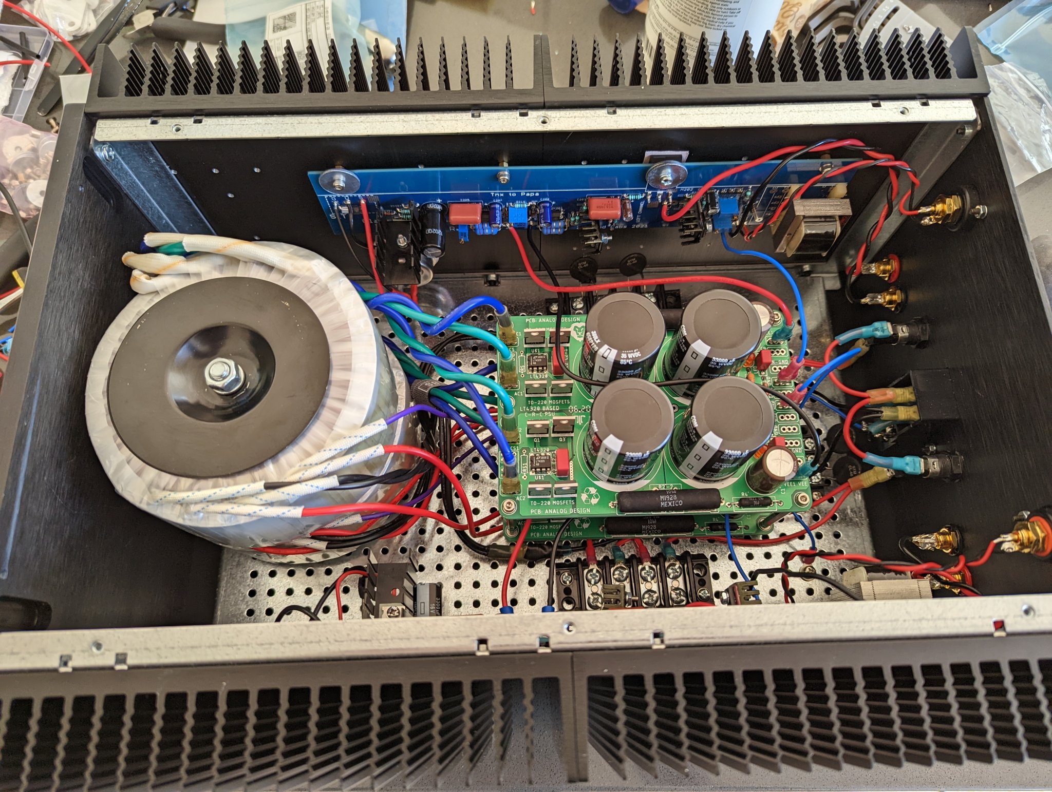

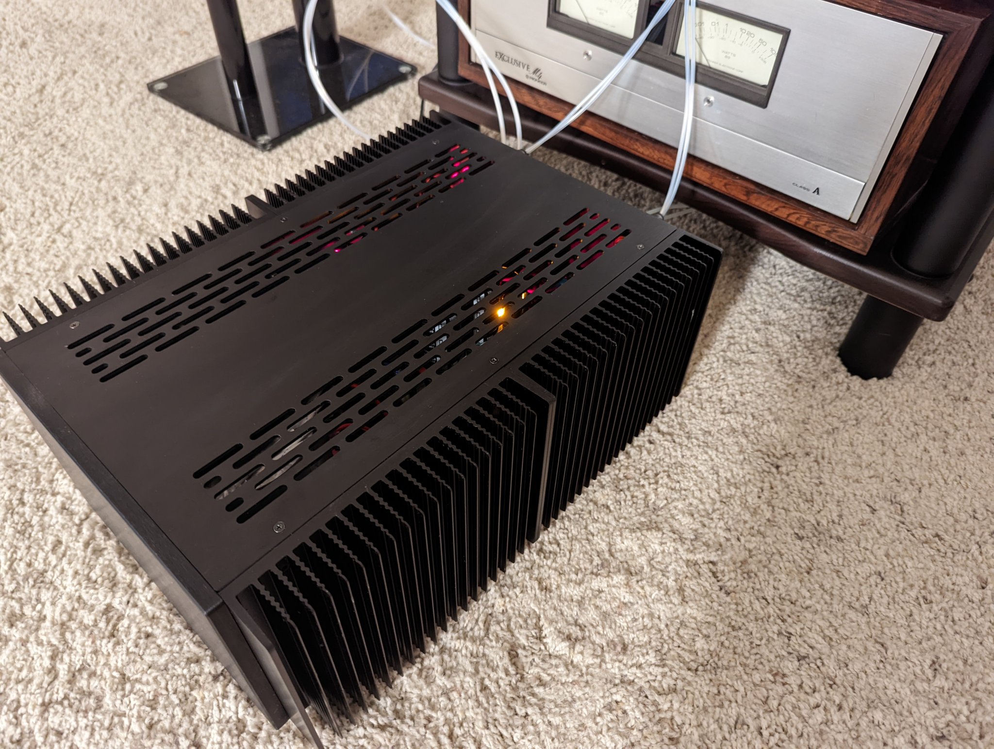

Really nice build sp33ls 👍Well. First impressions are that this this stupid spooky. :0
Honestly, setting the pots went without a hiccup, tho trying to access them with my super tight monoblock build was challenging. Managed to hit 199.5mV & 20mV without a problem. Let amp sit for 15m or so before setting offset. The LT4320 PSU boards deliver +/-26VDC to R+/R-.
I can only hear a faint hum with my ear right next to the woofer (both channels). Honestly, I'm surprised that it's not more noticeable given my small chassis. I'm glad I went with shielded donuts, tho I'm wondering if I may be able to almost eliminate it completely by moving some wires around?
Also, I'm currently using a 3A fuse in line of each donut (as well as 2x 6AT at IEC). Was wondering if I need to bump that down to 2A5?
I'm very impressed with the bass out of this thing given it's 'only' 20-30W.
The organic tone and spooky realistic nature is reminiscent of some SETs, but with the added benefit of solid state bass. 🙂
Thanks for answering my numerous questions, as well as the creation of this beautiful beast Mighty ZM! And, of course, we must blame Pa for our greedy addiction. I'm super grateful that this community exists.

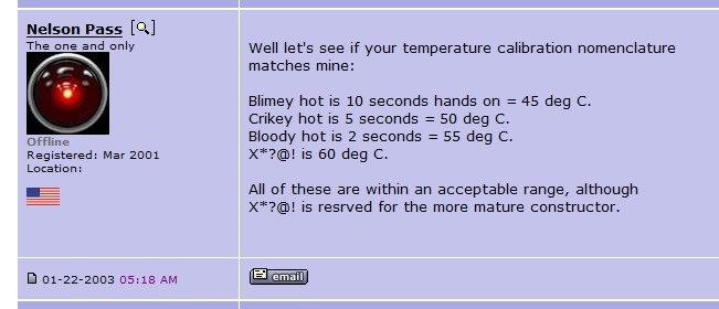

just wait, you are still not pi$$ing full (destined) amount of Thinner
all graphs you can see are delivered with amp in temp. equilibrium;
I don't care how they are looking when amp is cold, but as I said oomphteen times - I'm not waiting to enjoy my music until amp is fully warmed, I'm enjoying my music right from the Switch On - try doing the same, life is too short to be wasted on irrelevant rituals ....... besides - music is already there, recorded, take the spirit and just go with the flow
now, SissySIT is, intentionally or not, proper PoorMenSub for SIT-3, meaning - it's brain-obliging THD Factory, 2nd dominant, negative phase
ahem, slight difference in sound of amp being cold vs. full hot - most likely culprit is increased thermal distortion ..... meaning - distortions invoked by minute temperature changes in part itself are, by logic, much greater in system not yet reaching it's temp. equilibrium
I reckon - absolute value of these changes is not changing in two extremes, but its relative value is much smaller when everything is Bloody

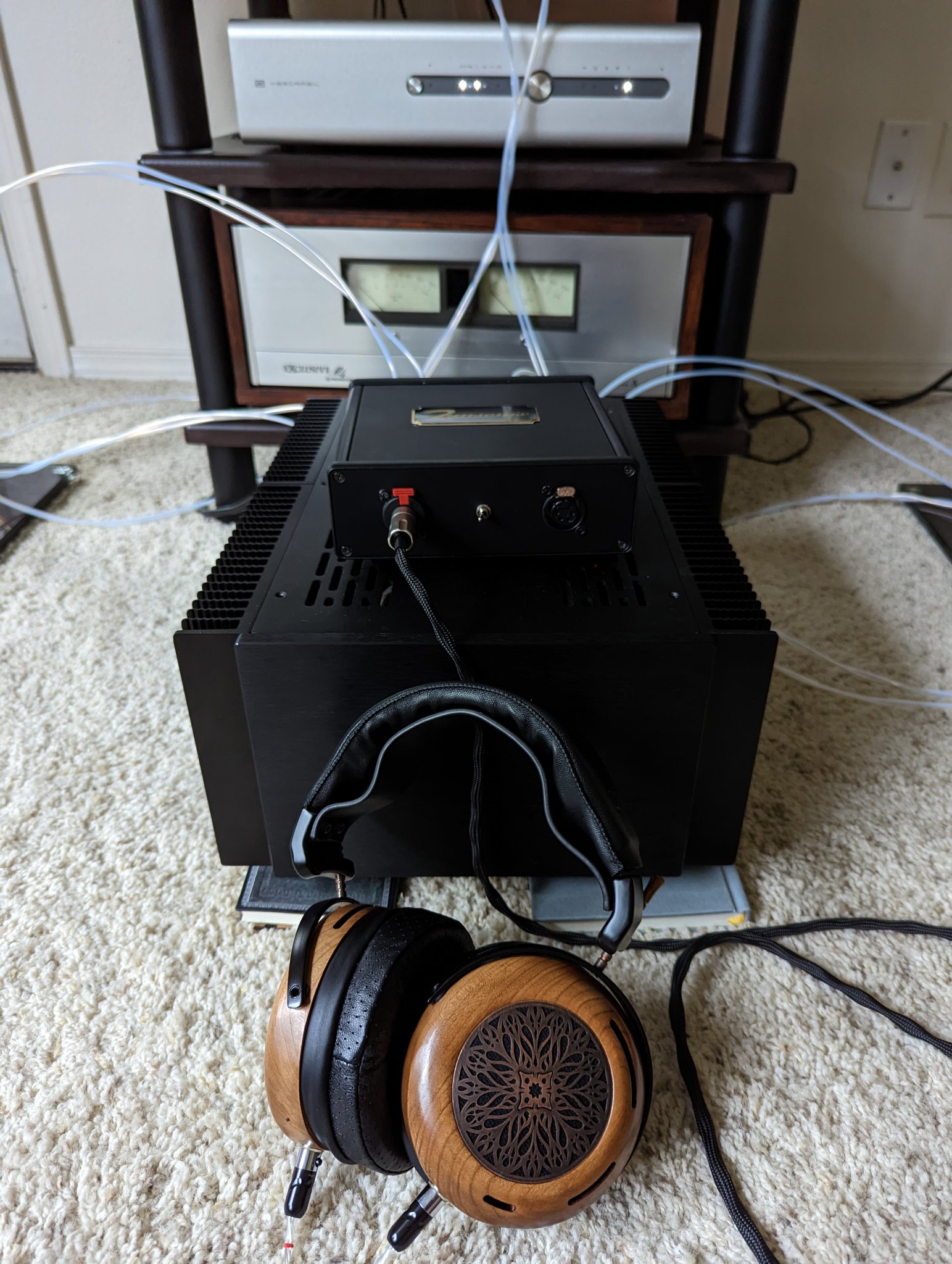

So, I'm trying the SissySIT with headphones (ZMF Atrium) right now and it's laughable how good it sounds.

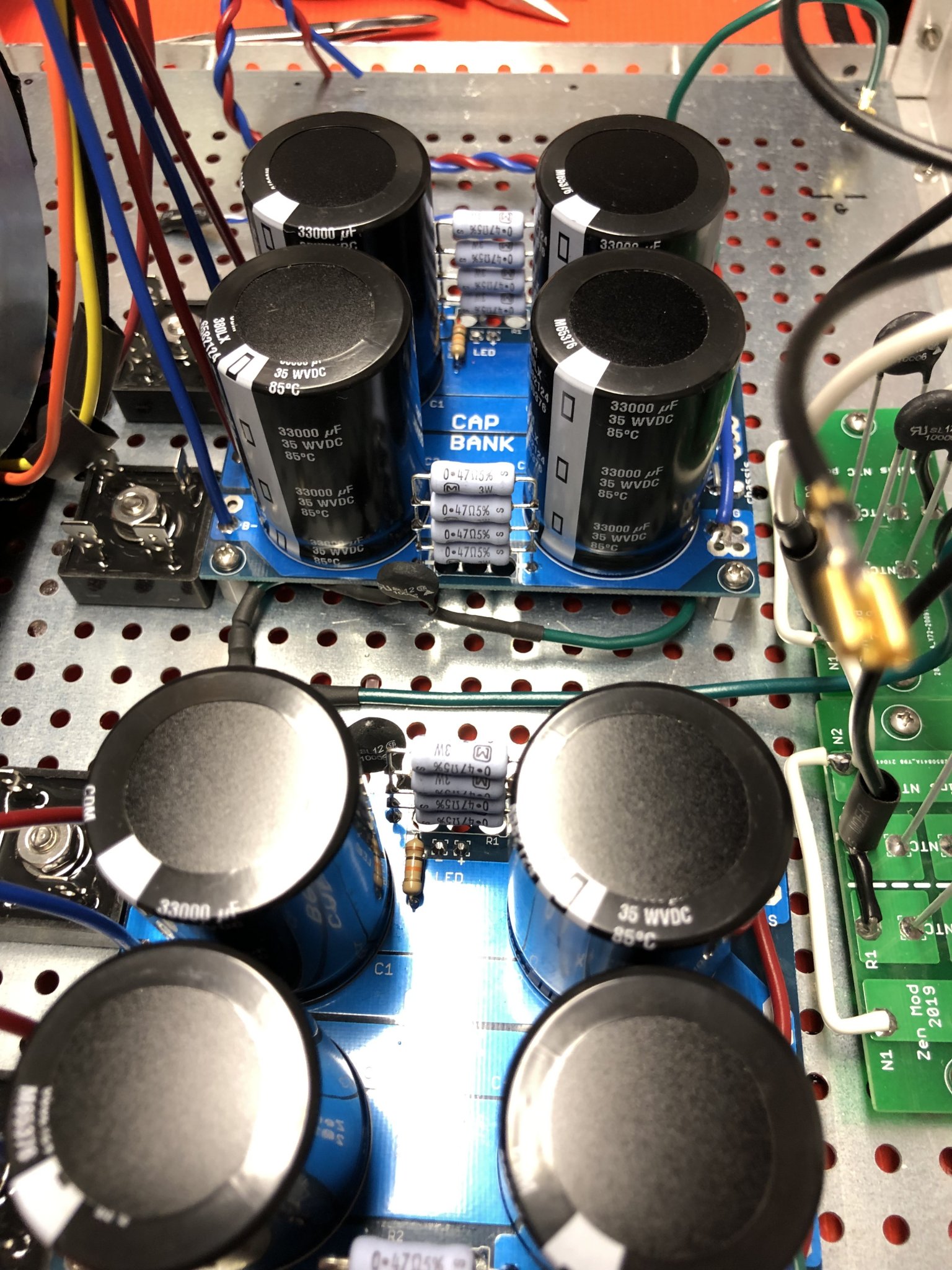

I plan to build, for my SissySIT, a dual mono CRC power supply with 4 capacitors per channel ( 2 caps before the R and 2 caps after).
Which of the following options would you choose?
- 4 x 47000uf caps per channel
- 4 x 33000uf caps per channel
- (2 x 47000uf) + (2 x 33000uf) caps per channel
