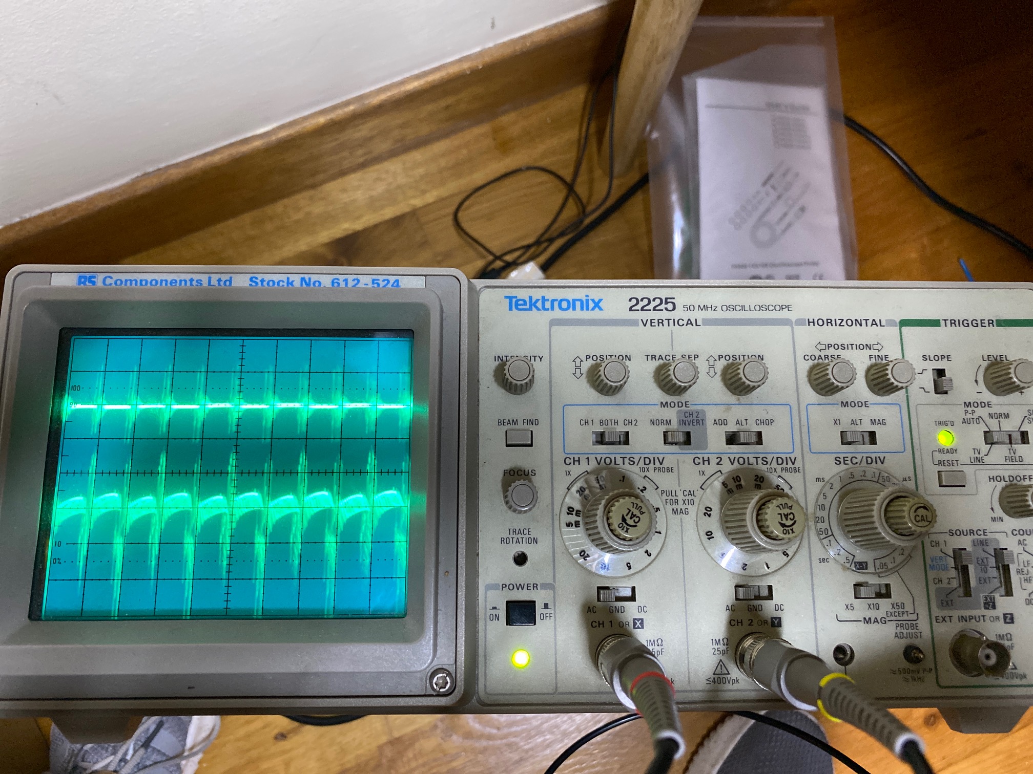

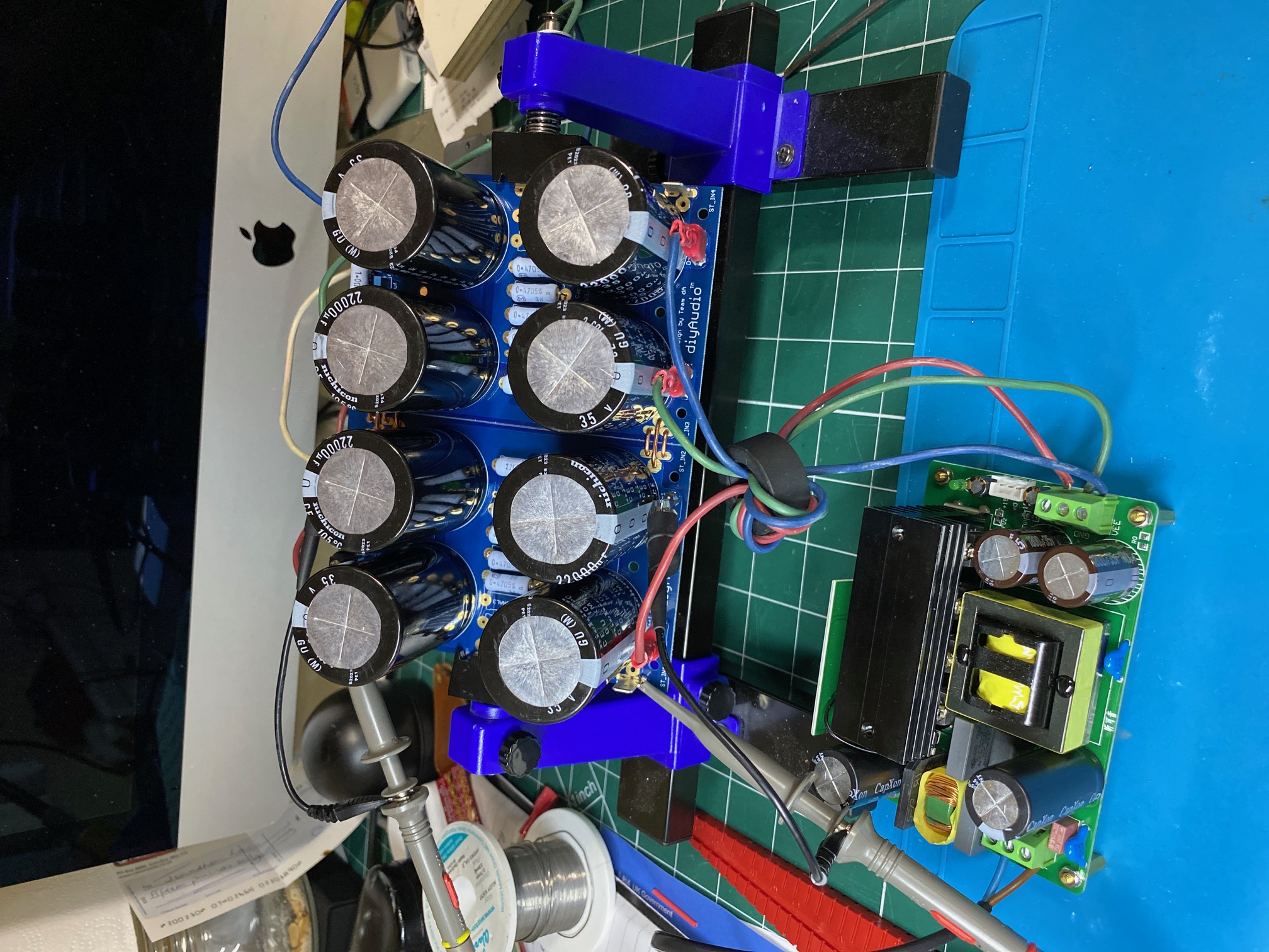

DC supply noise spec
I am looking at my power supply and testing out a few options. First up is a cheapo SMPS driving a DIYAUDIO CRC board with 88mF per rail.
I am seeing around 10mV of 50Hz noise bleeding through from the SMPS. What is the supply noise spec for the SissySIT? Should I keep looking to reduce/ change to iron or is this low enough?
Top trace is output from CRC filter, 5mV/div.
