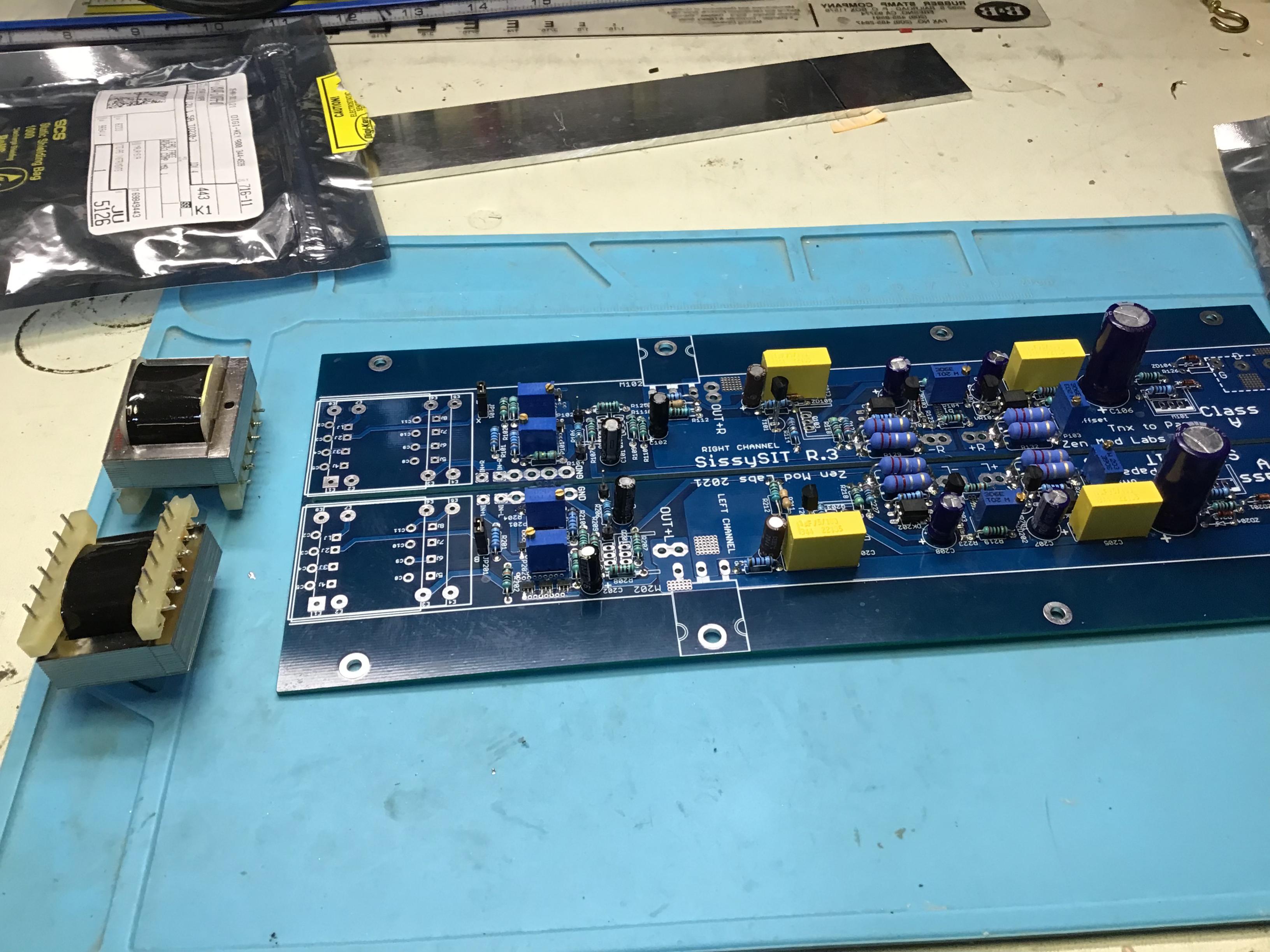

Don’t want to make an assumption - Cinmag transformer has no indication of primary or secondary, does it matter witch way you install it? Pretty little guy, also has 4 extra pins w nothing wired guess just cut them off.

Thanks good think I asked , I guess the definition of assume still applies . I guess along that line the mica insulators are needed for the transistors mounted back to back on the heatsinks.
Also I think I remember you mentioning the mosfet disparates more heat than the sit , should they be thermally bonded to each other?
Bill
mica is for BD transistors, pair of them having common htsnk, one mica per BD transistor
no need for plastic bushings, holes in BD are isolated
mosfet dissipates same heat as SIT, but mosfet is smaller physically, so heat transfer is more critical
bonded - you probably mean - do they need to be on same heatsink?
not exactly, but they need to be in same, hopefully at least semiclosed case, thus presenting one closed thermal unity
example - Modushop cases 400deep - having 2 heatsinks (of 200mm length) per side - are not exactly thermally connected ; but - due to fact that case is one thermal unity ( closed lids etc.) no problems at all
