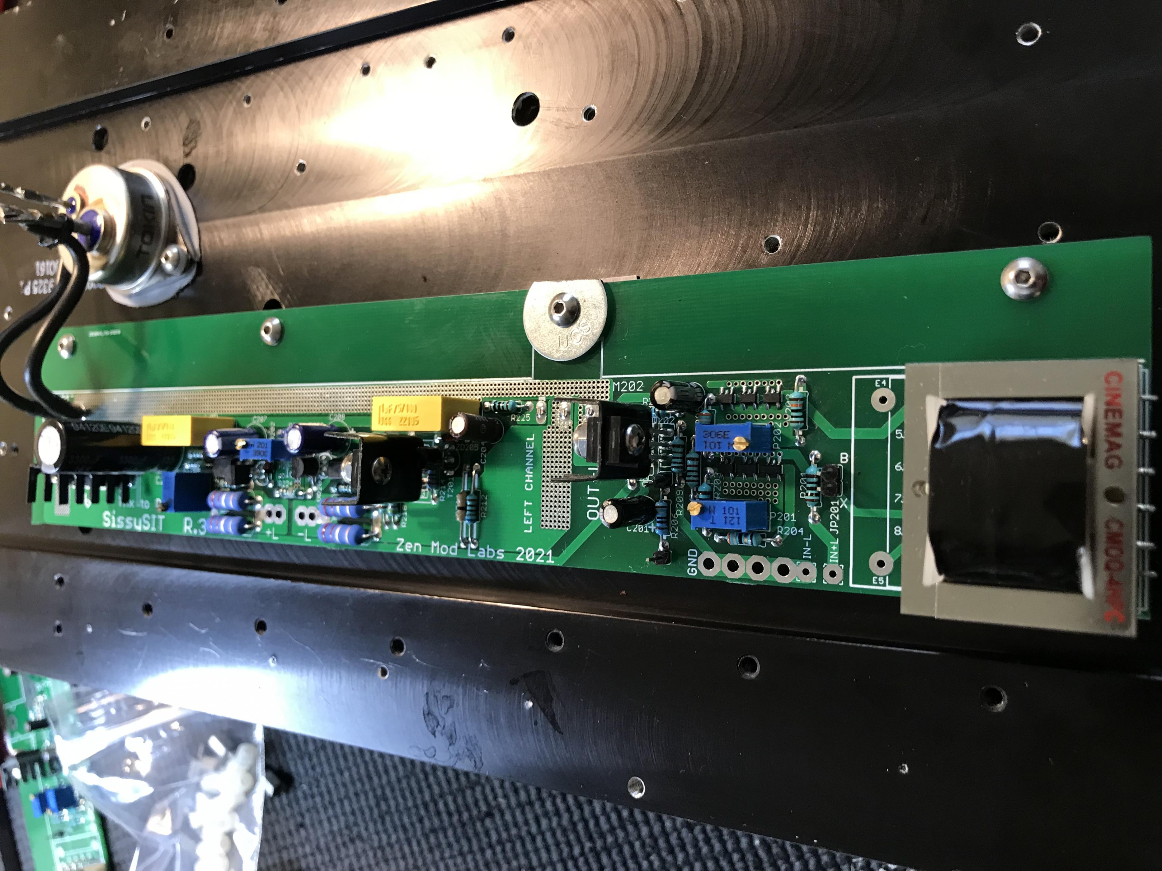

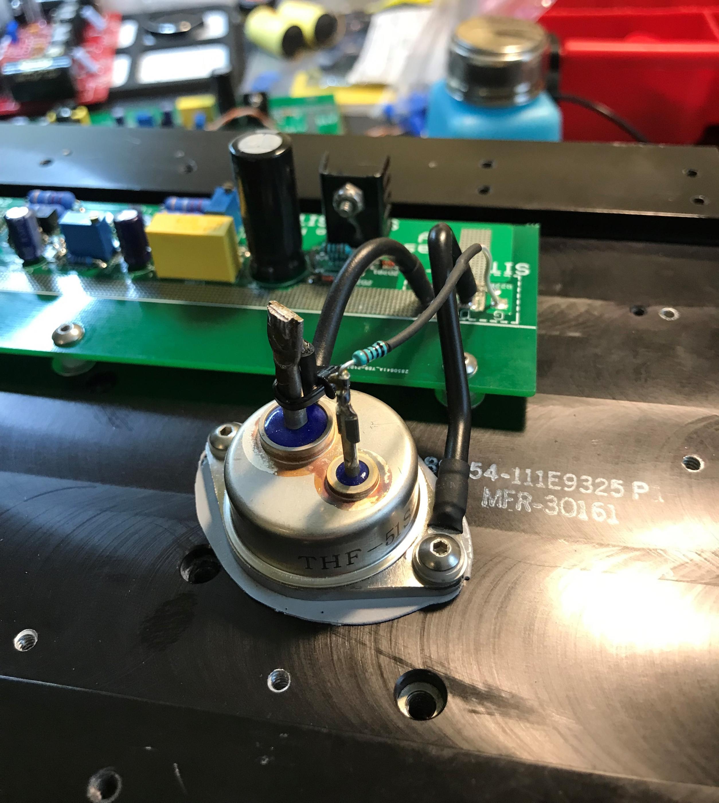

Taking a short break and thought I might show some progress. Out with the F4 and on to the SS R.3. About to start final wiring on this first channel. Then to power up and hope that careful, slow, patient assembly has paid off.

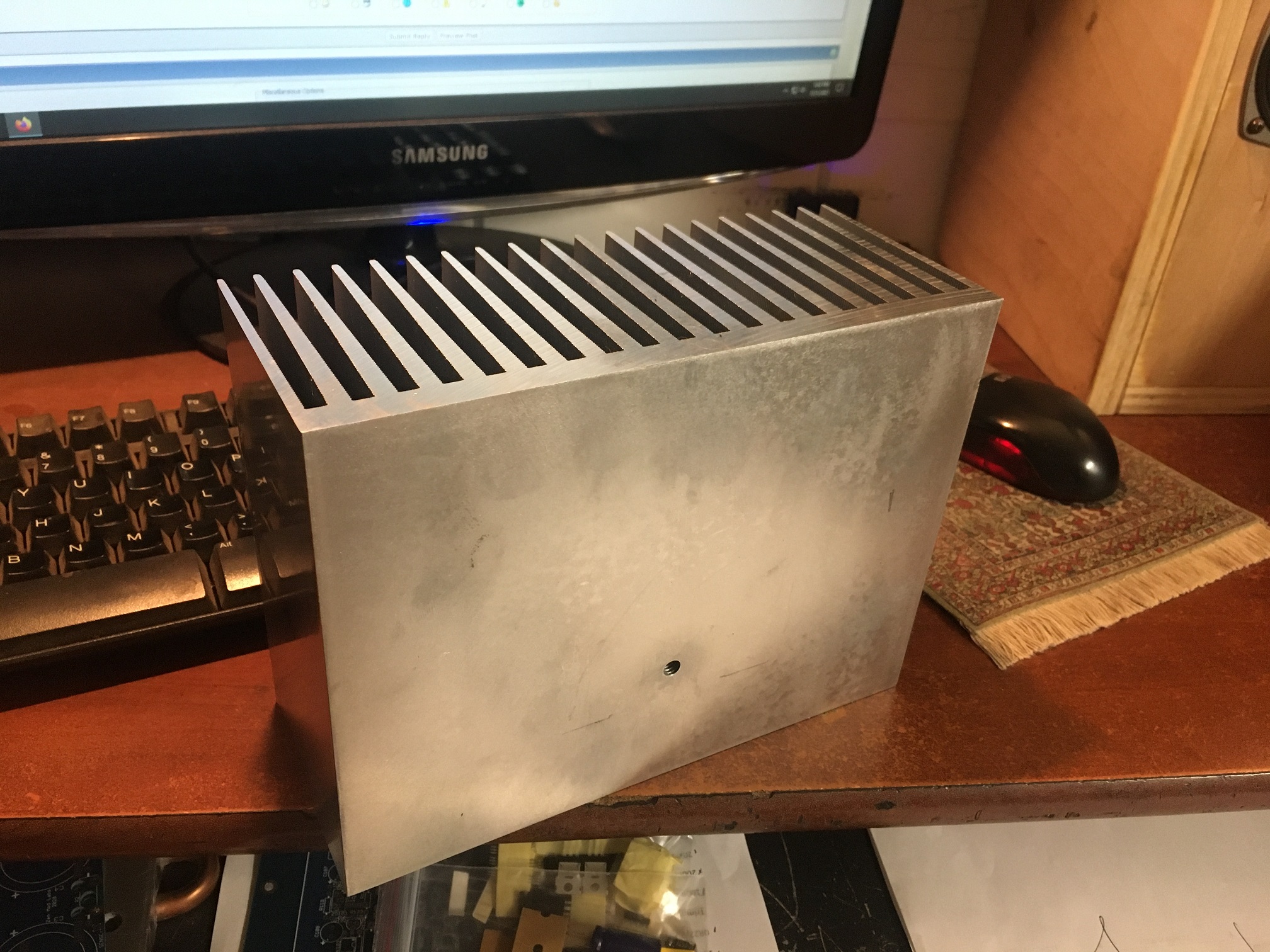

I am looking at using 2 Heatsink USA 8”X3” serrated fin heat sinks per Channel and trying to figure how tall to go. The spec from Heatsink is .66 C/W/3” , ZM says the heat output is about 80 Watts per channel, My ambient max will be 26c. Not sure of formula for calculating how many watts .66 C/W/3” dissipates and how to scale that up to Heatsink height . My ideal would be 2-6” tall per side.

I ran a FAOW at 23V rails, approx 40W disspation on those exact sinks, 6" height as well. It got a bit toasty; with 25C-ish ambient, I'd say they stabilized around 50-60C, so I'd say you should be OK. Maybe go for 8" height to be a bit safer.

80Watts x 0.66 = temperature rise of 52.8°C so if your ambient temp is 26°C the 3inch tall heatsinks will get to 78.8°C (in a perfect world!) - I suggest the three inch heatsinks are too small. The 6inch heatsinks will not achieve double the performance of the 3inch ones but might be OK if you're OK with a temperature around 60°C - personally I would go bigger.

two of these per side , so ending in sink 3" tall and 16" deep should get you in ballpark
Babysitter in Summer and that's it
of course - if you still didn't bought them - pony up for 4" tall
I appear to have two properly functioning channels now. The delayed OS bias start up time caught me off guard a bit, but I was patient all seems well. I guess the filaments had to warm up first.. Haven't had a chance to get a proper impression yet. I've only run one channel at a time for setup and testing so far. I need to throw together some interconnects for the pair (monoblocks). If this amp sounds good I'm sure it's because of the Cardas Eutectic solder I used...😉

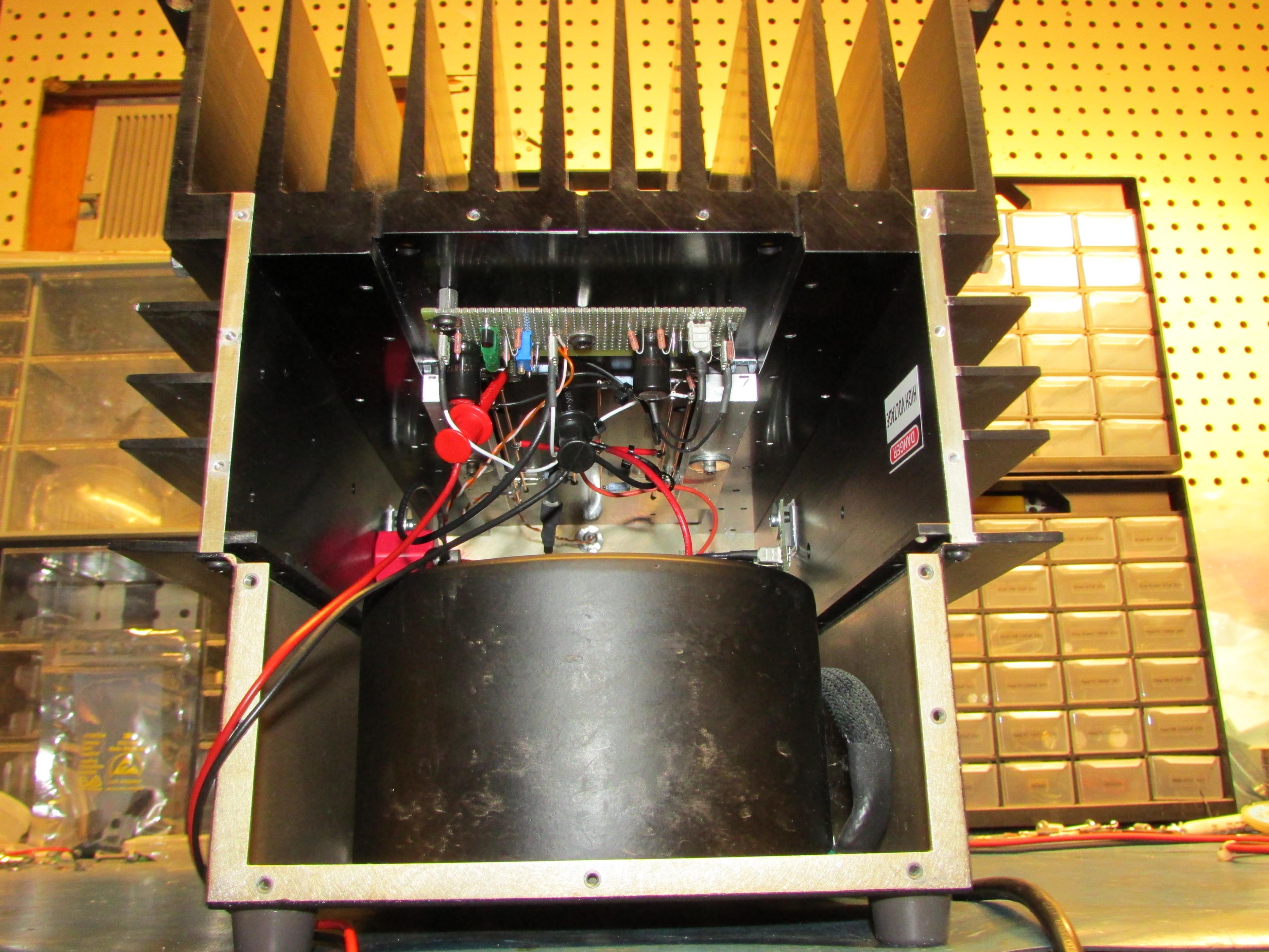

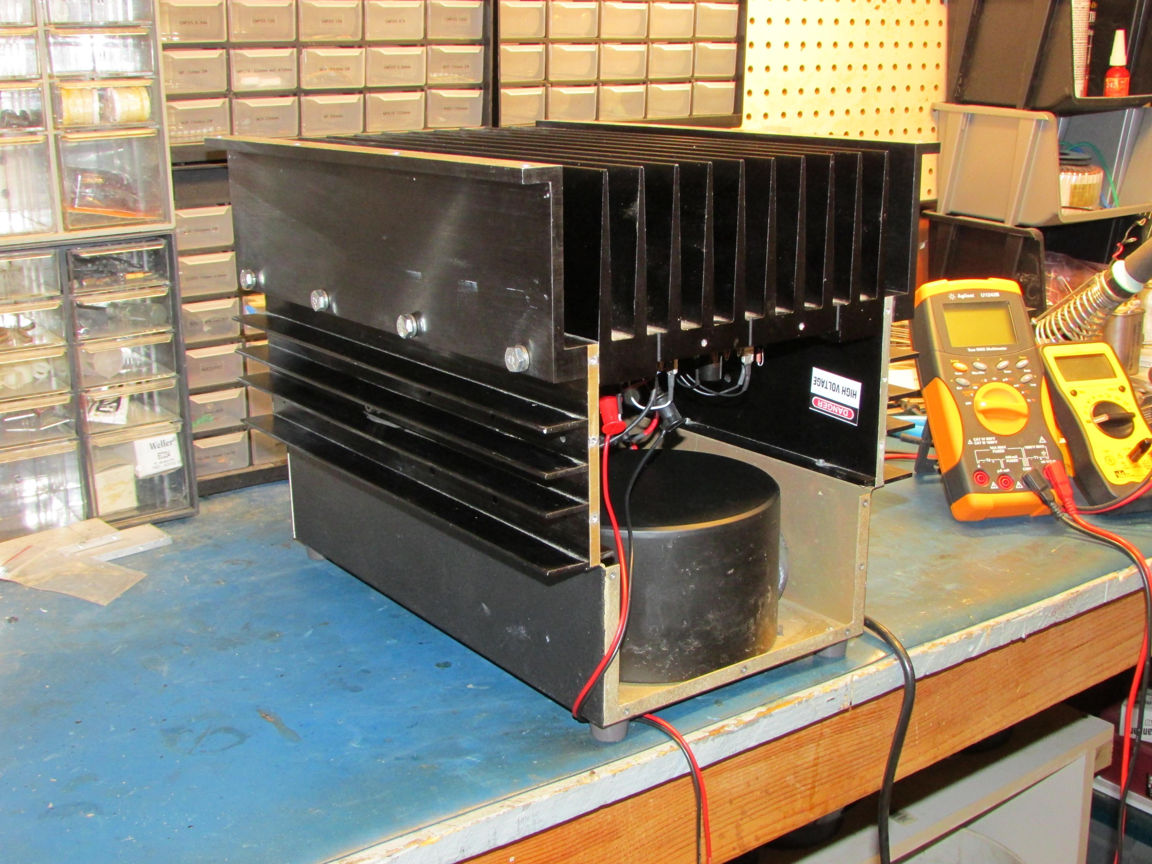

My chassis's are not sexy like most shown here. More suited for a locomotive which is where they came from. These chassis's were destined for the scrap heap where I'm employed. I've built 1.21 giga-amps in these... BA-1, F4, F5, F6, Aleph J, etc., etc. I did make some mesh front panels to make them slightly more presentable. Each weighs 45 lbs. Working in these is difficult. Like playing that old classic game called "Operation". Slip and get buzzed. Maybe I'll try to get a family picture of the Sissy brothers as it "SIT's" now 🙄. Pictures are one of my old veroboard / point to point wired BA-1's with Semisouth where it counts. SS R.3 dropped right in with that UMS designation, and only had to drill and tap a single hole to get the welding drek Tokin mounted.

Thanks for the help, I will go with 6” then. I have decided to go with SMPS power supplies so this one will be a bit pricey. My plan is power supply in separate case and extra set of caps in amp case. I hope the SMPS will not struggle with the slow start up time and extra caps.
