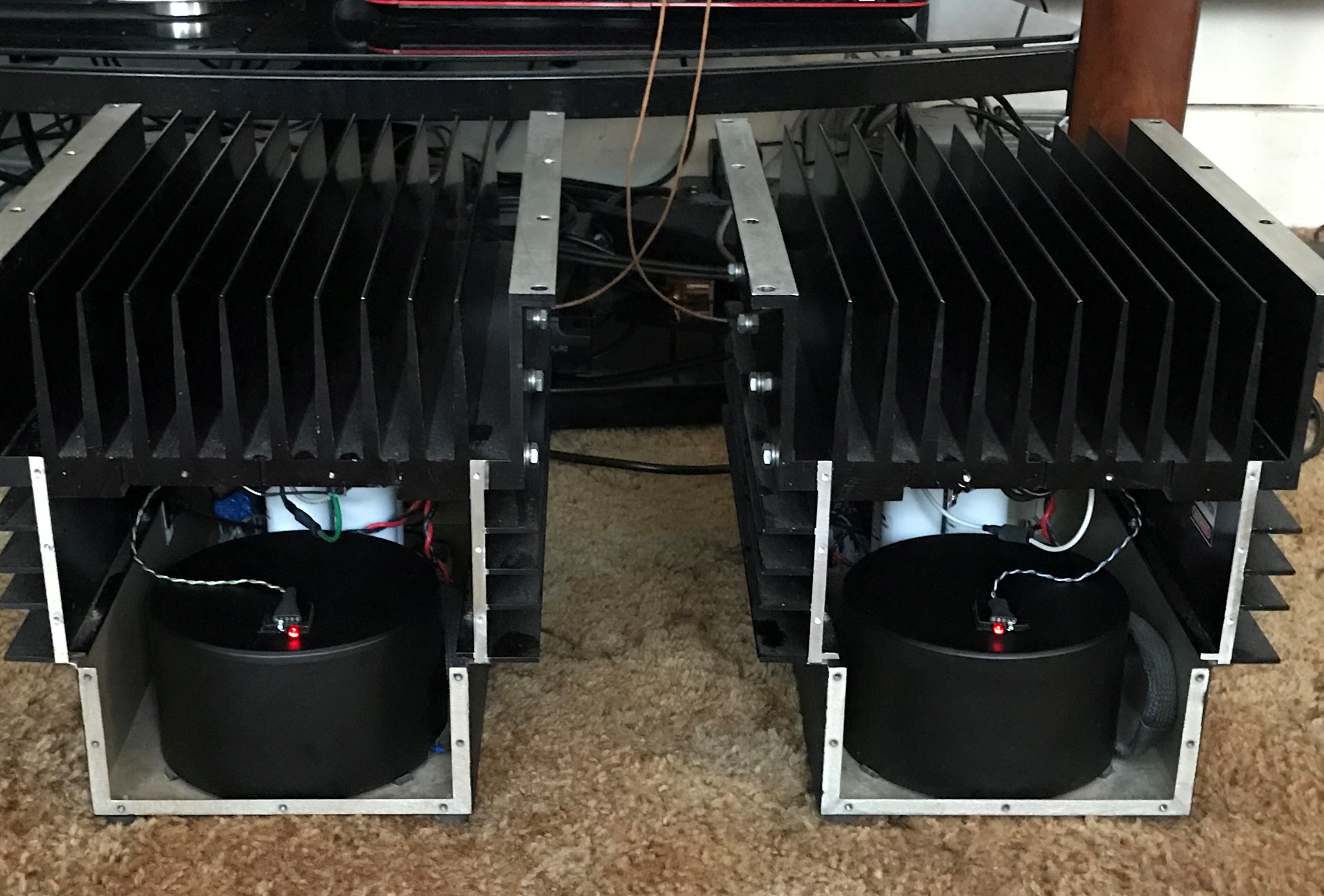

Just a few hours in but first impression is :spin: Is it the DEF OS without degeneration? Triode curve SIT? Excellent buffer properly driving HQ Cinemag iron for passive voltage gain? Zero feedback? If this is a poor man's First Watt SIT-3, I guess I have no problem enjoying it while wearing my burlap feed sack... 😛

considering that Pa most likely already sold all his SIT-3, I can freely say that you're having something pretty much in same league
proper DEFiSIT is still slightly lusher and even more dirty pleasures oriented, but with price paid with lower power and drive capabilities
so , you're happy camper ....... as anyone having any of Revisions
and yes - blame Pa

as explained in - indeed several - DEF/DEFiSIT/SIT 3 threads, SissySIT is made along same concept - as Poor Men DEFiSIT and , I can say - it got closer (in SQ) to origins than I expected
not exactly much of my achievement there, all Kudos to origin circuit and Wakoo brain behind

I was hoping to find some quality 300VA+ toroids @ 18Vx18V (USA 120VAC), but seems Antek's are sold out.
Still -- I'd imagine the SS can get by just fine with a single 250VA donut, right? So, I'd have plenty of headroom going with two donuts @ 250VA?
I'm looking at 2 of the Avel Lindberg 250VA 18x18V.
Thanks again, ZM!
How closely should the Tokins be matched?
Do you think there's an advantage to the THF-51S for audio usage compared to the 2SK182?
as close possible, hoping they will have closest transfer charactersistics; though, do not loose sleep about that - OS being follower, not so critical as with SITs used in arrangement having voltage gain
same for THF vs 2SK - in SInging Bush ( SIT having voltage gain) all measurements are showing that life is easier if using THF
in DEF OS ( SissySIT) , differences between THF and 2SK are lesser, and after some listening tests I made - exactly to determine possible differences - I didn't even bother to make measurements with 2SK
