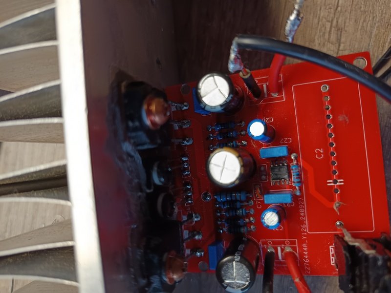

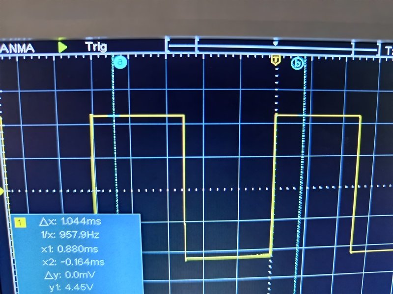

Hello after a break caused by personal matters
I had to suspend my DIY activity for a few months
I am slowly coming back and will continue the projects I started

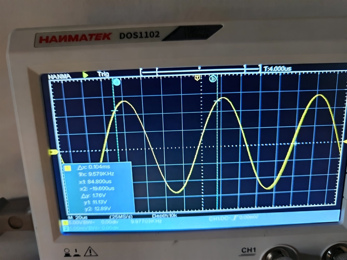

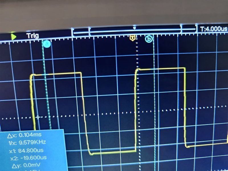

I launched 1 channel today
It was not without problems and a small BOOOM - one capacitor on the PCB has reverse polarity The board has not been cleaned yet ;-)
After correction it seems to be working properly Checked on a dummy load of 8 Ohm
Offset below 2mV
Power supply +/-23V
Sin and square waveforms are correct
As soon as I find the time I will launch the second channel and see what listening impressions
Distortion measurements in the future

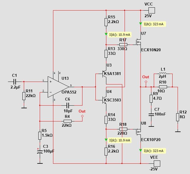

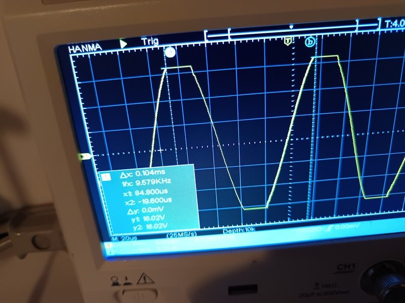

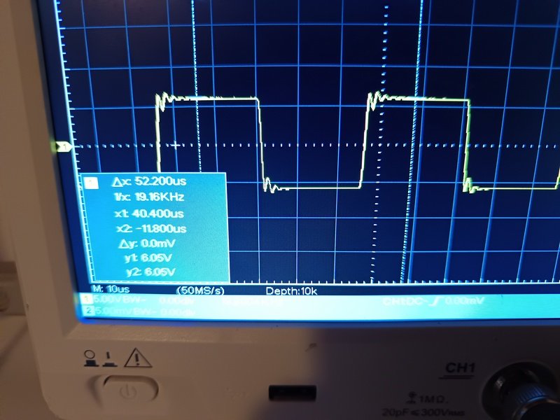

Looks like peaking in post 97 and is ringing in post 98 already at 10k
Was decoupling added? or was the simplified schematic built as is.
Is marginally stable. Anybody check stability.
Circuit could use bootstrap for current sources. Has been mentioned many times.
Have driven quite a few Diamonds with opamps in sim. usually need small series resistors on the power pins to stabilize.
Tina Ti seems to show this, not sure about other sims. I add internal resistance to the voltage sources so decoupling becomes needed
in sim to stabilize. Better not to test with " ideal" voltage sources.
