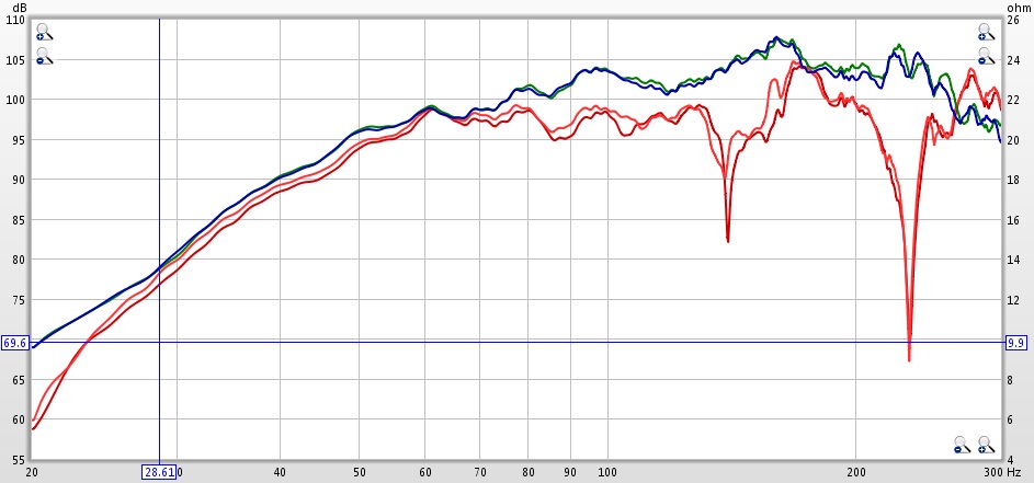

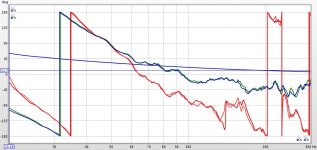

Testing method:
Outdoor measurements in a park, no buildings within 100 yards
Amp output set to 28.3V at 100Hz with no load other than the meter.
DBX reference mic 1' off ground at 10 meters distance from cabinet.
Allen & Heath mixwizard used as Ref mic Preamp. REW loopback also passed through A&H
SmaartLive and REW both calibrated to match Radio Shack SPL meter at same position as reference mic
Results of 4 sweeps 20-1KHz on each cabinet averaged as single trace.
Tested: Both JBell SS18, Dayton 460-8, red/orange traces
2 Cerwin-Vega T36-750 as a 'control', blue/green traces
Frequency Response and Phase plots attached

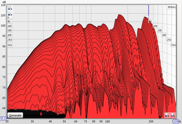

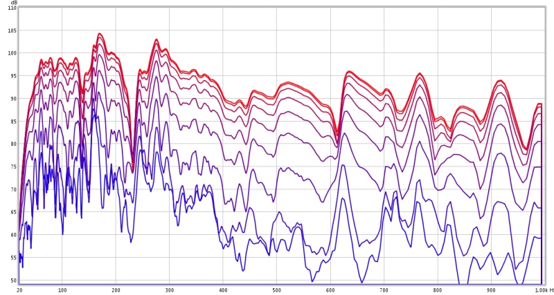

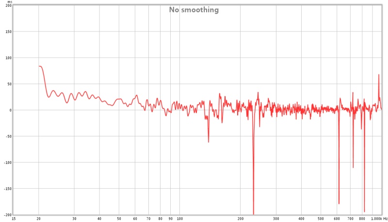

Each trace is a single cab.
There is no EQ, no filters, no nuttin 'cept signal, power amp, speaker, mic.
I suspect my calibration may have been off by a couple of dB as I was using a borrowed Rat shack meter (couldn't find mine) and repeated previous tests with the CVs as reference show the peak between 90 & 100 Hz to be in the 108-110 range they advertised for those cabs rather than the 104ish I got here...So I bet we can safely assume that I'm slightly under the actual performance.
thanks for posting measurements -- appreciate it.
BTW -- for anyone wondering, no this is not an 18" driver stuffed in the typical ss15 cab.
The request for this cabinet design was cheapest/simplest/most output possible. (emphasis on cheapest) It's basically an up/back singlesheet TH with a dayton driver. Better drivers give more output, however I think this driver/cabinet hits the original target quite well. (hey it hangs with a T36-750 without the T36's rising response you have to eq flat)
