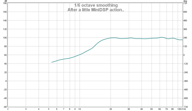

After my last post I realized that I need to get these measured up now so I know what I have to start planning with.....if they are even worth it.
These will be either a third sub with 2 drivers or my 3rd and 4th subs in the room. I just want to use them for smoothing and I always wanted to try Tapped Horns.
To answer your question though, my current subs in the front of the room have an f3 or 29hz.
I don't fully understand what is going on (big lol on the fully notion). Is the 5mH coil to do some kind of zoeble thing smoothing the impedance of the driver curve?
I'd be curious to know the DC resistance of the coil and the voltage across the coil and driver in a sweep.

Yeah the series coil didnt seem to have much smoothing effect for you at all ... It did however seem to smooth the phase at the very extreme bottom end, not sure if that means much, or if it is at all useful ..... I wonder if an outdoors measurement would also show the same insignificant amount of effect in the desired range?
Do you suppose the sharp dips centered around 30hz , 60 and 75hz are caused by room modes or are they just actual features of the horn's response? They are deeper dips than what show in the sim...
Its possible that the lack of cone compensation could contribute to those deepened dips at 60 and 75hz, or perhaps even ceiling height or a nearby wall causing a cancellation .... The deepened "saddle" at 30hz seems to defy the typical trend of a smoothed out or flattened saddle with sim vs measurement results ...

I'm reasonably sure they are at least partially room modes. If I scoot them around the dips move a little bit, because the cabinet is large and changing the orientation when they're in the corner makes the distance between the mouth and the nearest surfaces in each direction change by ~2 feet. One of these days I'll build a better room that occupies more space in the basement 😀
I've been wanting to do an outdoor measurement, but I need to get up the ambition to do it..they are quite heavy.
With the MiniDSP though, it's quite a bit better.
