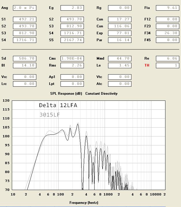

I've convinced myself that building a bunch of SS15s is the way to go, but I want to see if this makes sense to those in the know:
I have 6x Delta 12LFA on hand, bought for dirt cheap after coming accross plans for some tall horns starting with T. After procrastinating for a while and reading around, I've been swayed away for a few reasons, and my goals have changed a bit.
The new plan is to build a battery-powered sound system, that is moderately portable and versatile. A couple of hand trolleys/sack trucks, with a stack of batteries (low for balance), a few subs, then tops above head height, would make the stereo pair that can be used as portable system on the move for parades and the like. When stopped and set up, the subs can be lumped together and the trolleys are kept as speaker stands for the tops.
Probably sounds silly, but we have some pretty good street/laneway/park parties here (Newtown/Marrickville) every year, Reclaim The Lanes being the biggest and that's in February - giving me a goal to work towards...
I'm set on the SS15, not because it's the "best" for my purpose as a few reflex boxes would probably work really well for my bass duty... but how cheap, light and simple this design is makes sense for expanding the system in the future when it becomes more than just a rig on wheels.
The gains from "barn door" additions as made by r23d (posted here) is a big appeal, the panels could strap on the sides of the system when it's being wheeled around and when it's parked in a park, they can be bolted together for something bigger and louder again.
The limitations of working with 24V battery power outdoors means I'll only be putting 24V max (probably ~22V) in to the drivers, and only need response from 60ish up, pursuing anything lower is futile.
When I modelled the D12LFA using DJIMs numbers shows the driver seems to perform OK in an unmodded box, and runs out of xmax at 22V. Happy coincidence!
It all seems to be a good idea so far...
Long winded intro, sorry, I'm bored at work and full of ideas... the point this post is to ask:
Are my numbers for simming the D12LFA close to accurate? It's the first time I've used HornResp
Would I gain/lose anything by making the box slightly narrower, perhaps 19.5"?
And are there any other mods to the box needed for running the 12" instead of 15", ie, does the driver mount off centre on the baffle or anything like that?
I'll try and build a test box in the next month or so to see if it works out, and if there are any small changes to make I'd like to factor them in...

the data looks okAre my numbers for simming the D12LFA close to accurate? It's the first time I've used HornResp
if you narrow the box you wil always lose low end and/or efficiency.
mods are not needed ,but you wil gain a bit round 60 hz by making s2 a bit smaler.
(try s1 300 and s2 350)
i would put the driver as far back as posible (shorter s1>s2 and longer s4>s5)
if you just rotate the speakerbafle (fixed to the front) ,so s1 becomes 2,5"instead of 3.5",
and put the driver as far back as posible,you get this.
