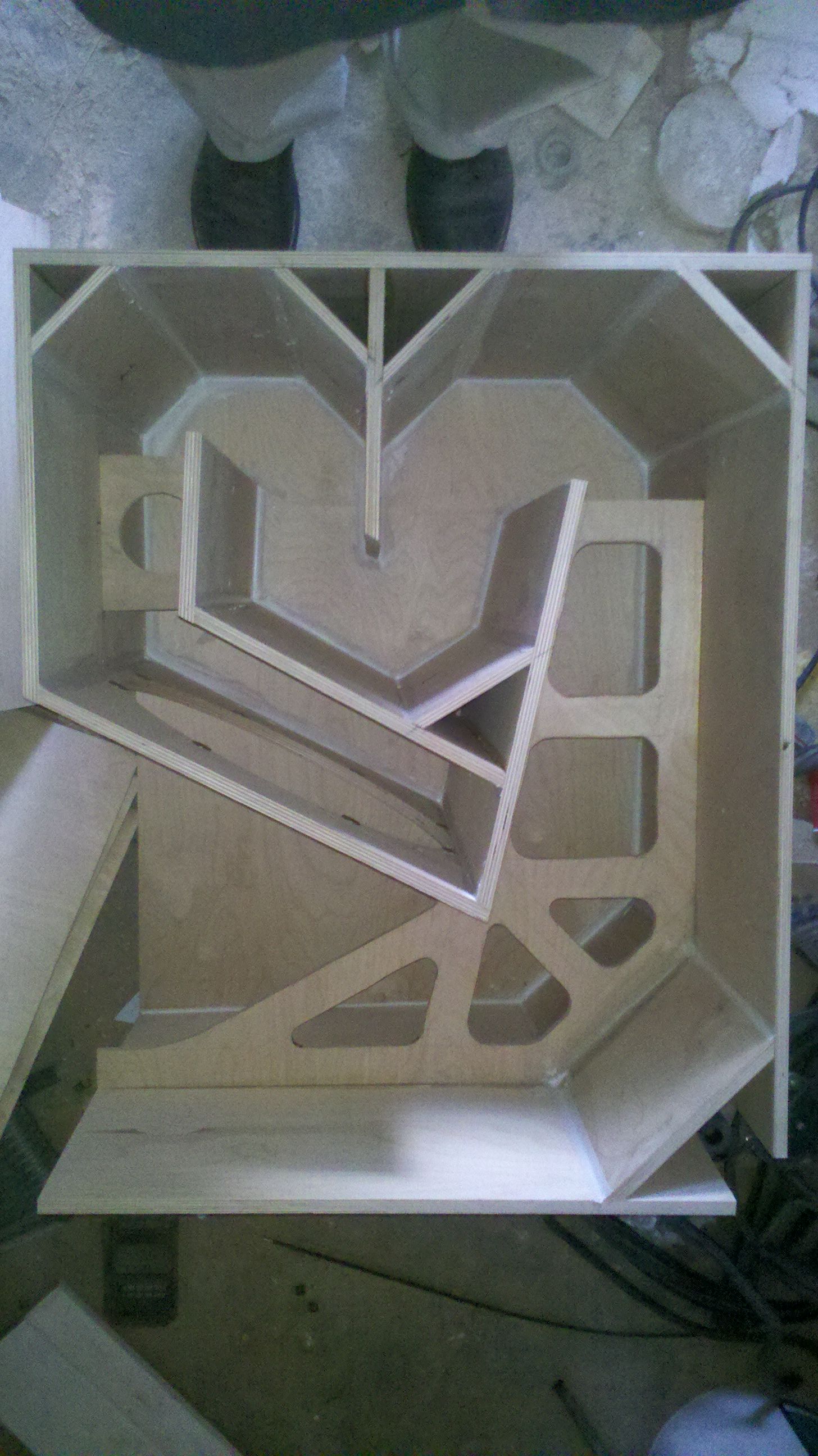

Finally got some time to finish up my 2nd SS15... but this time, I built one with corner fillers in the "critical" areas and a bit more extended bracing. I'll tell you what, this one was FAR more difficult to assemble than the original! Maybe I just suck at putting in corner fillers... but some things didn't square up very well and was a real nightmare. Regardless, I got it done, just took a lot more clamping, screwing, pulling, etc. to make it work right. I think my issue was using screws to secure the fillers, or perhaps I didn't get a good 45* angle cut on them... who knows.
Anywho, attached is a pic. I'll be doing a direct comparison as soon as this weekend using REW (computer to Firepod interface to Dayton calibrated mic | high end sound card to xti1002 to subs), my multimeter, my yard, measuring tape, and a good beer. I look forward to the comparison. Whichever one "wins" will get a twin built soon.

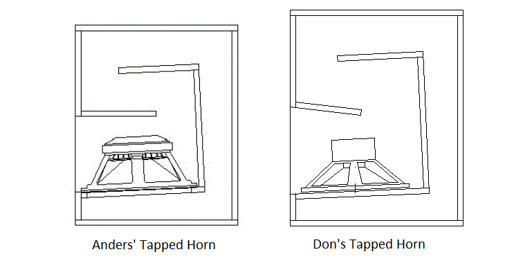

I tried to beat Jim's last cabinet, and failed. I did come up with a modification of Anders cabinet scaled up to match the size of Jim's cabinet. It's max
output is down 3dB from Jim's but it goes 5Hz lower.
If you want 40Hz in a single box, it may be your best choice.
Post 158 of this thread.
Any more information on angles and distances for the inner folds to turn this sim into a buildable version? Thanks.

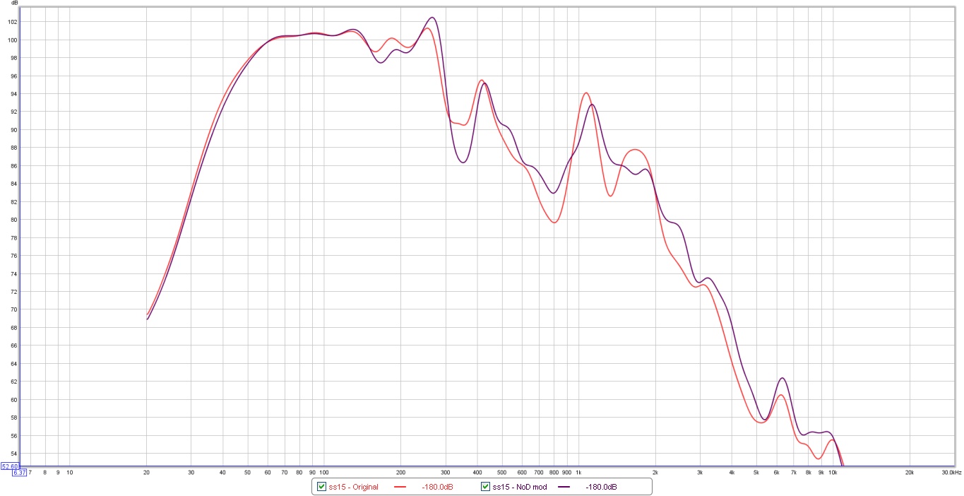

Set everything up yesterday and was ready to measure, but then a storm hit hard and heavy and we had to rush to put everything away... though it never did rain, better safe than sorry. Plus, the winds were strong enough to skew measurements. Luckily, today was wonderful.
I used REW (roomEQwizard) to compare between the two. I set my calibrated mic ~1m away (39 3/8"), used a rat-shack meter on slow/C weighted and tuned in 2.83v @ 60hz. Then, ran REW and calibrated the graph to the output of 100db @ 60hz. Here are the results. All this done on my lawn... I have about an acre of property out of city limits, so it was pretty noise free.
I can say that the extra corner fills and bracing was, as jbell predicted, was definitely not necessary and wouldn't benefit. I'll let you read the graphs to see the difference. From my experience, it was a real pain to do the extra corner fills. Sad to see the extra work put into it not pay off, but happy to build my 3rd and final version to the original, much easier to assemble version of this great design.

The corner fills and bracing are to keep the panels stiff. Maybe not a problem in a cabinet that takes 500-600w RMS. but in one that takes a few KW...I'd say it becomes necessary not optional.
Ahh, yes -- you are correct. I've stated several times that everything all 'falls apart' (meaning power compression, out of xmax, cabinet at limit of what it can take, etc..) all at about the same time on the ss15 -- I call that good engineering..... or maybe just getting darn lucky...
This is designed as a 500 watt class sub, using cheap eminence drivers, that can be knocked together in an afternoon, that weigh a fraction of a kilowatt class commercial sub. Where I hang cabinets... My back likes me better.
It also just happens to put a smile on my face when I crank up a pair...
