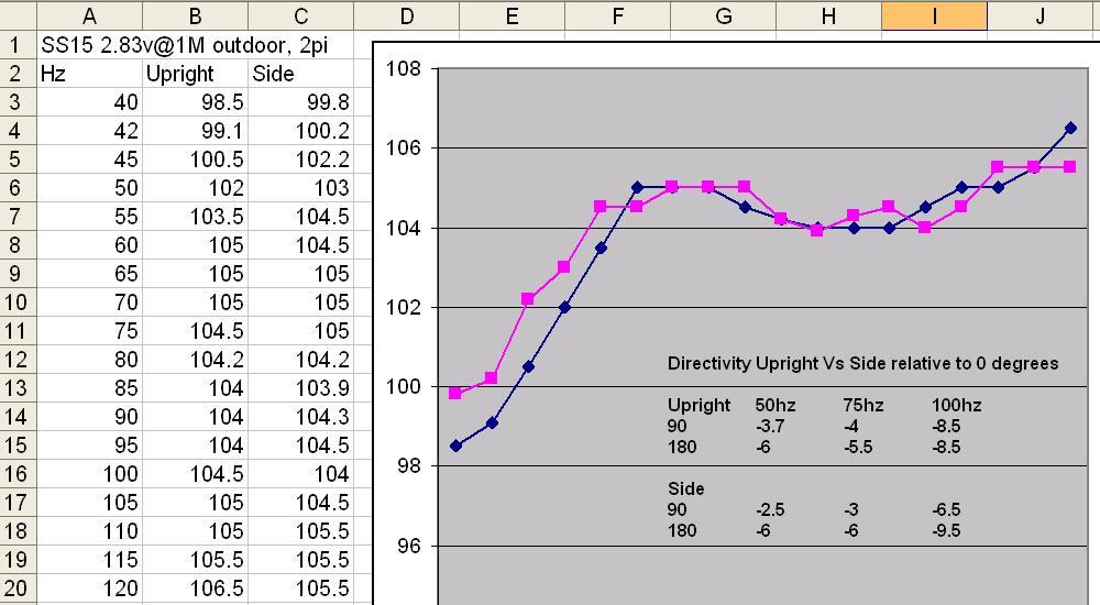

Finally had a chance to do a bit of testing outside. I also tried to put to numbers some of the things I knew, but never documented. (like on side vs upright)
I also did a quick 'directivity test' where I drew a 10meter circle, started a sine wave and then walked around with a spl meter.
Pretty interesting stuff (at least to me....)
Nice results Jbell. But before you make a conclusion between horizontal and vertical position, remember that you are measuring trough a tiny microphone membrane and nobody puts his ear to the ground (not meant as critic but as a reminder ;-).

Distant surroundings can have significant impact on LF test results, as I found with my outdoor directivity tests.
What was the distance between the SS15 and the nearest building ?
What was the direction of the SS15 in relation to the nearest building?

Jim; I would like to do my testing as close to yours as posible. Did you set your level to 2.83VRMS using 60Hz? AndyPretty interesting stuff (at least to me....)
When I do my sine wave tests, I just leave the meter connected. If there is a bit of drift off of 2.83v, I make fine adjustments.
