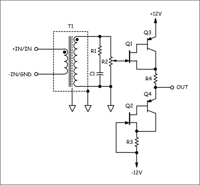

hitsware said:
>Watch out, thought I saw some NFB stuff there. Might be contagious.
For a common drain (output stage(sorta attractive for swinging up (and down)to the rails)) I don't have a way to do 0 feedback (short using xfmrs) .......... any ideas ?
Why stop short of using transformers?
How 'bout something like this:
hitsware said:
OK ....... Do you have a description of exactly how your circuit operates .... The bottom half is particularily non evedent to me.
........mike 🙂
Sure. The transformer provides the circuit's voltage gain. R1 and C1 are a damping network for that particular transformer, giving it a smooth Bessel rolloff. R2 doubles as the transformer's secondary load as well as volume control. The output is a JFET/bipolar Sziklai pair (a complimentary version of the Darlington pair) used as a voltage follower. The bottom half is the same pair used as a current source.

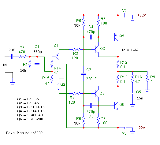

PMA said:
I am sorry but I do not understand. So many posts talking about inherently very poor circuit designs (horrible THD and IMD, high output impedance, low linearity, low power). Simple does not necessarily mean very poor, but most of the circuits shown here do. What's the reason? Just for fun? 😉
You mean like this one? 😀
se
