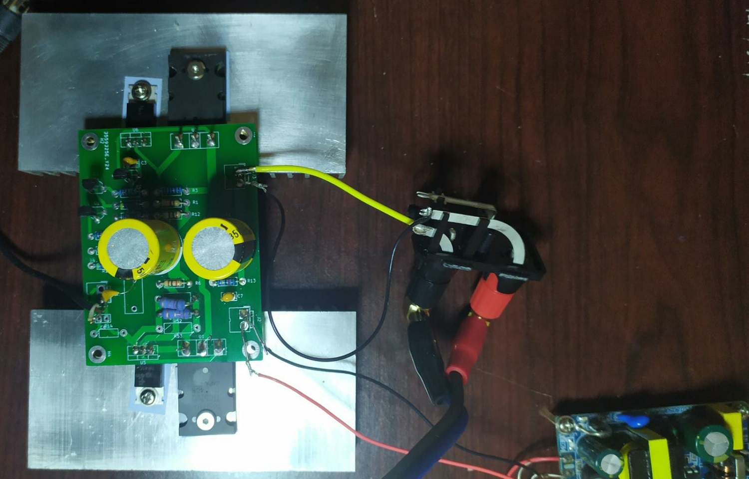

OK guys, I know, this is just dabbling with audio, not really Hi-Fi at all. Oh I aim to get there finally. So what do you suggest, what are you trying to tell me?
Start with the LM1875 project and then what speakers should I get / build? Open Baffle? What sort of budget are we looking at finally? Maybe a chip amp. I mean show me the Holy Grail so I can maybe drink from that cup one day.
I am probably looking like a go-cart builder to a Ferrari owner. I respect your concern and your advice, so go for it. Tell me what I should do (if you have not already). And I won't try to teach you about Hi Fi.

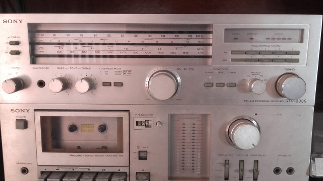

My goal is to replace a Marantz 2226B with a DIY integrated amp. So far I have had good results, but not enough to beat out the Marantz ( it may never happen). I have 90db speakers and can blow go too loud with 4-5 watts. Personally I like lower watts.
My goal is to replace this: Sony STR-333S Receiver:

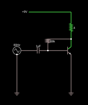

The amplifier on one transistor passes the DC through the speaker. You can blow your speakers faster than you like 🙁

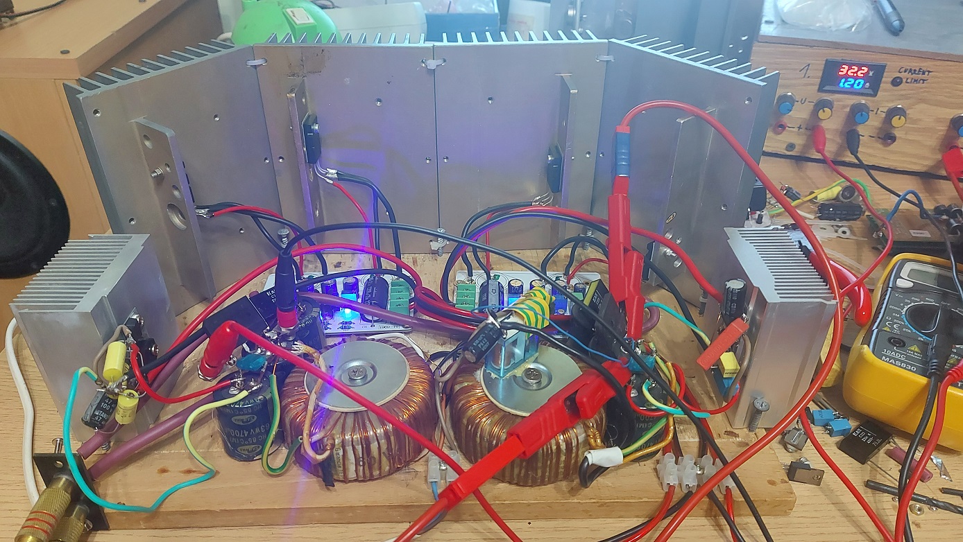

Heavy, hot, expensive - this is class A. Especially SE. You will need a powerful power supply unit (100 watts or more) and large heatsinks (several kilograms).

You can buy JLH1969 mini PCBs for $ 2. The power supply, heatsink and case will cost $ 100.

Yes, so I can add a capacitor in series with the speaker or a transformer that will take care of that. John Audio Tech uses a capacitor in his circuit.The amplifier on one transistor passes the DC through the speaker. You can blow your speakers faster than you like 🙁
I do no plan to go hot, heavy expensive. Thanks for the warning but I want to run this off a 5V to 9V power supply and 1 Watt output. Small heatsinks.Heavy, hot, expensive - this is class A. Especially SE. You will need a powerful power supply unit (100 watts or more) and large heatsinks (several kilograms).
I have run the class D PAM8403 before it met its untimely end, these things are very sensitive to incorrect wiring. Class D is an option, so are chip amps. Right now I am running the dual LM 386, and need to get some nice enclosures built.You can see a kit of a 50 W class D amplifier with bluetooth and control from a smartphone on Aliexpress. This is a 50x50x16mm board for a few dollars. You need a laptop power supply.
In addition to the 2200-4700 uF capacitor, you will need an 8 ohm 20 W load resistor.
The efficiency of such a cascade is less than 10%.
To get 1 watt you need to spend more than 10 watt. The output voltage should be 2.82 Vrms with a load resistance of 8 ohms. Supply voltage 12 V current 0.8 A.

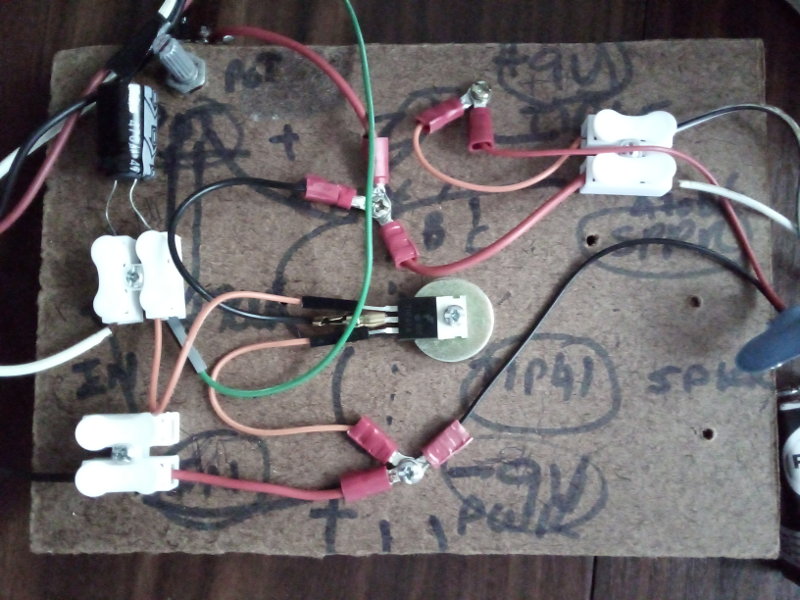

Working...Proof of concept.
It is working. And it is loud, and a little distorted.
Initially configured on a board with terminal blocks, I had little success, initially with a lot of distortion, and then now working at all. Some continuity testing revealed some loose connections and a defective mini stereo jack, these were then replaced.
I decided to use crimped ring connectors screwed down to terminals, these are sure to provide a good connection. Crimping was not completely foolproof, but it worked very well. To speed things up, I used some spring loaded connectors for the input signal wires as well as the speaker outputs. Some cracking was heard over the speaker when testing, this was encouraging, before the input was set up.
Input was connected this morning and it worked, loud and not so clear. The potentiometer is set to adjust gain levels, and works well. The unit was connected to the S333 speakers before I remembered that there was no output coupling, no transformer, and a capacitor at the output end simply broke up the sound.
So what now? Well, it works, and does have surprising bass. The distortion has to be somehow filtered out (running off a battery now) and the output transformer has to be put in place. The transistor as well as the battery both get quite hot after 5 minutes of playing.
It is satisfying to build a working transistor amplifier instead of using a chip. There are some example circuits that I will post, related to this.
