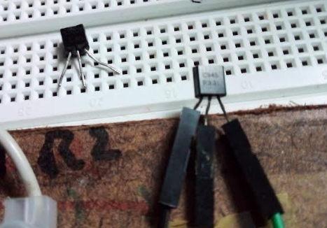

What went wrong in the beginning? I assumed that, like the diagrams showing the base connection of the transistor was the middle pin. It was not, according to the datasheet, the 13001 has an E-C-B pin layout.

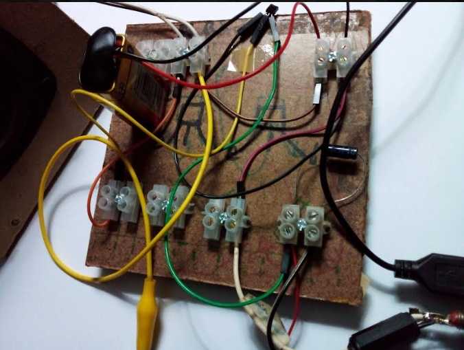

Some notes on changes to the circuit: the input capacitor is a 470 uF that makes a slight difference to the output. The 2k Ohm resistor was actually a variable resistor, carefully adjusted to around 2k. There were no other changes to the circuit.
Sound was measured at 50 dB at 10 cm from 4 Ohm speaker without the amplifier, that is, direct PC headphone output to speaker. With the amplifier the output went up to 60 dB at 10 cm.
The sound is fairly clear at low volumes, and using the PC software volume boost at greater than 100% improved things quite a bit. The music player matters - Audacity with bass controls was best, followed by the Clementine music player.

The transistor is too hot to touch. Do I need a heat sink?
As someone suggested, I checked the battery, and it is putting out an healthy 8 Volts, this for a 9 Volt battery. I can go up-to 12 V or use a power adapter but heat damage is a real concern.
My first class A amplifier ! Just to get it to work is good enough.

The battery is getting warm and also is down to 4 Volts in operation. Running off USB power is not an option I suppose due to the high power draw.
Current draw is 0.09 Amps that is 90 Milliamps. Voltage base to emitter is 0.8 V.

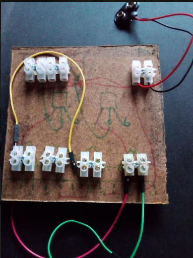

For a start, connecting the components using a solderless connector system. This is just a rough prototype:
Updates at this site:
The thing is working now, with its rough and ready state. Many questions arise. Right now it is running off approximately 5 Volts which does not help distortion. Gain is adjustable via a variable resistor across emitter and base, adjusted for minimum distortion.

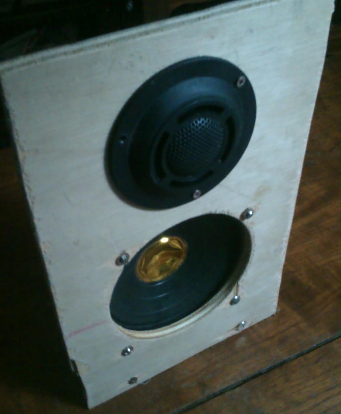

Testing with my Desktop Open Baffles was disappointing, hardly any sound to listen to. That consists of a woofer and tweeter with only a capacitor on the tweeter.

Switched Transistor to C945
Replaced Transistor
The 13001 transistor was replaced with a C 945 by simply removing the old transistor and inserting the new one into the makeshift holder. It was a case of plug and play, and it works fine. So now I have the transistor for the second channel of the amplifier.
Replaced Transistor
