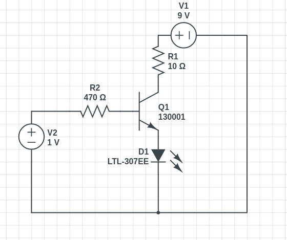

OK so back to the extremely frustrating project. I connected up the 13001 as a switch, powered by 9V on the main circuit and by a 1.5V battery through the base. I used the circuit shown here: (under "Cut Off Mode")
Working of Transistor as a Switch - NPN and PNP Transistors
An LED was hooked up in series with the Emitter, Collector, resistor and battery. When the 1.5 V battery was connected to the base, the LED lit up. I used a variable resistor as well to dim the LED by varying the base voltage. I took some measurements:
Input values : 0 to 0.5 mA
Output values: 13.2 to 16 mA (max) . 13.2 mA was measure by removing the 1.5 V and connecting those terminals to each other.
There is more than one scheme on your link. All are correct. Base current must be limited to permissible values for this type of transistor. For example, using a series-connected resistor. Direct insertion of a 1.5 battery can cause the transistor to malfunction.
A fresh 9v battery will provide up to 300mA current. Discharged - how much it will turn out 🙁
Transistors 13001 are high voltage with low current gain.
The Transistor as a switch
Here is the circuit in Circuit Lab ( CircuitLab - Editing "Unnamed Circuit" ). The 9 V battery was connected across the emitter and collector, with a resistor of 10 Ohms to reduce the current to the levels safe for the LED. The LED in this case anyway shows about 600K Ohm resistance so that explains the low current across the emitter and collector.
The 1.5V battery was connected to the base and the collector with a 470 Ohm resister to reduce the current again. In any case, the circuit worked, reducing the current in across the base caused the LED to glow less brightly.
I may have got the plus minus connections wrong, however the reason for the low currents is now apparent.
The next step will be to connect an audio input ( without a capacitor, I can use a 1kHZ tone to make sure the input frequency is reasonable, and keep the LED in the circuit, or maybe a light bulb, with a variable resistor in series for protection of the LED and check for variable brightness of the LED. If this works, I can work on getting the voltage swings on the output large enough to drive a speaker.

Used a resistor to limit the current to the base. (see diagram). Using an input variable resistor should take care of this, what is output current from a laptop headphone out?
EDIT: shows 1.2 mA approx on music output. This music output is enough to drive a speaker to output music that is just barely audible. So this means that 1.2 mA will drive the speaker. 2 mA using the 1000 Hz tone from Online Tone Generator - Free, Simple and Easy to Use.
Given that the output was measured at 13.3 mA, this looks very promising.
Will have to check the 9V battery.
High voltage low current gain means this is not the best type of transistor for this application?
