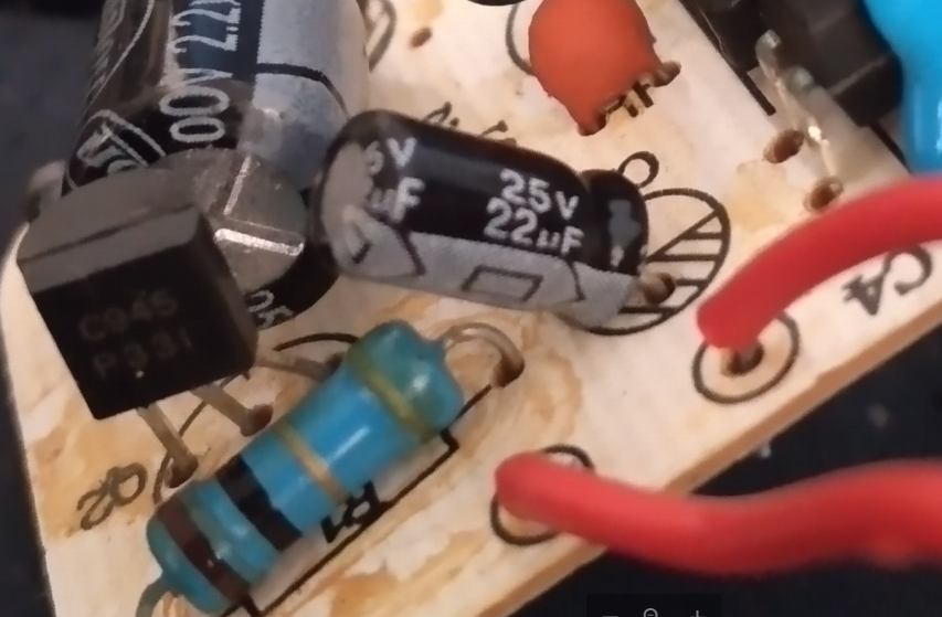

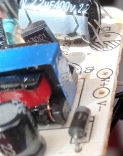

Transistors are very commonly found in phone chargers and other things. I opened up a phone charger to find two of these:
C945

13001

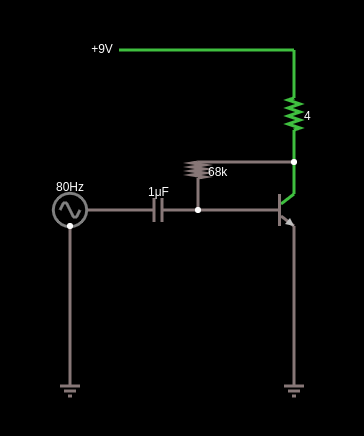

The circuit in this video works, but there is no increase in sound. What could be wrong? I could not get the required 95K resistor, could that be the problem? Using a 10 Ohm.
How to make mini amplifier use c945 transistor,diy amplifier - YouTube
Here is the circuit in a circuit simulator:
The feedback resistor is just forming a voltage divider with the output.
A 10R cannot be used instead of a 95k, there won't be any voltage gain.
What is the DC voltage from the base to emitter? If not 0.6VDC, the transistor is not working.
Did some testing : 9V connected to collector, and only an LED connected in series, the LED lights up. Current passes through the 13001 transistor even without any base current applied.
Next: c828 same thing.
This means these transistors are defective, right? The datasheet for the 13001 says it can take 400V at the emitter. Removing these involved a lot of heat and a soldering gun.
Time to try brand new transistor sealed new.
This is really getting to me now. I really would like a simple transistor based amplifier, what could be simpler? The transistors I am testing are all coming out bad, even the sealed one from 30 years ago named NTE123AP from NTE Electronics New Jersey.
All of them fail this test one way or the other:
Transistor Test For Identifying Terminals,Type & Condition - All About Engineering
The mulitmeter shows high resistance when it should not and low when it should not.\
As a last resort, I will set up the following simple circuit to see if the current passes through and lights the LED without any base current input. If the LED lights the transistor is bad.
+ 9V o-------- o Collector Emitter o-------o LED o-------o -9V
Then I go out and buy some new transistors. By the way the middle pin is not always the base. I had to find this out the hard way,
