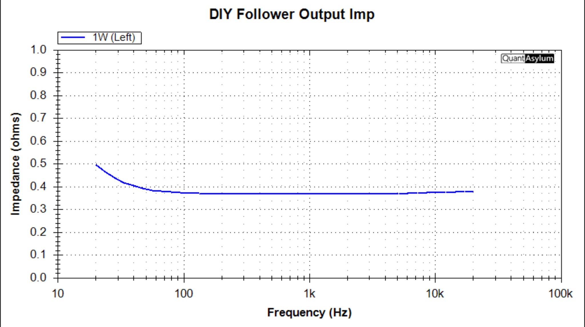

I also did some LTSpice simulations to determine output impedance. The Mu follower THF-51S was 0.35 Ohm and the 2SK180 choke load follower was 0.60 Ohm.

As for the output impedance, see attached actual impedance sweep. The sim is very close. What about the THF-51 choke loaded?

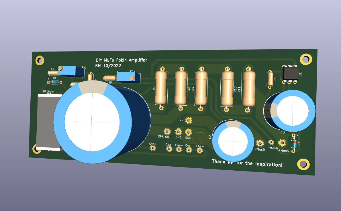

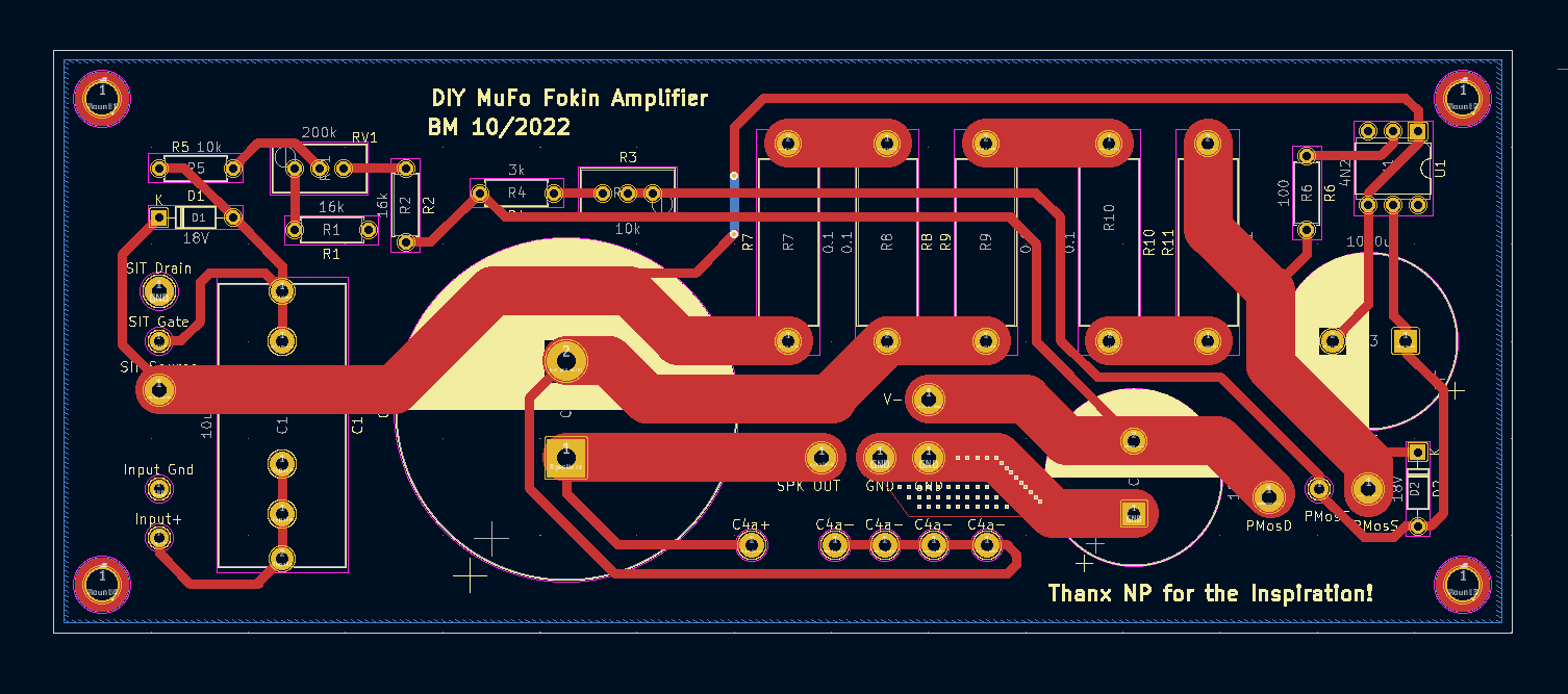

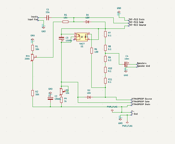

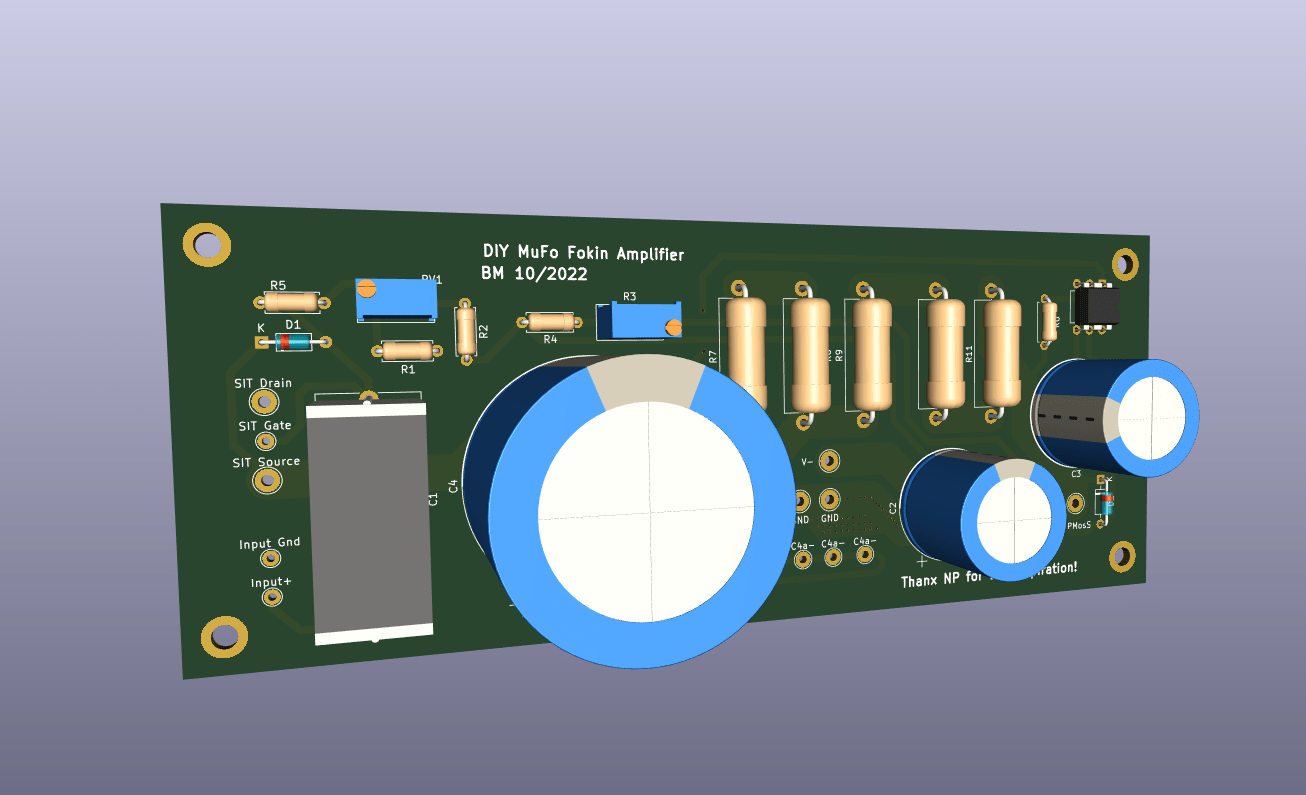

Looking for a diy electronics challenge, I downloaded KiCad the other day and gave it a try. I've always used perf board for building amplifiers that I concocted but with the availability of low priced pcb manufacturers, I thought why not give it a try.
So after a few days, this is what I have. Being a complete newby, I hope there aren't any errors, fatal or otherwise.
Wow! Now you've got me considering trying it. Just 'considering' at this point. Heck, Mark Johnson got me to order my own PCBs (using MZM's Gerbers). I've played around with LTSpice, so why not KiCad? Well, lots of reasons, none of them valid...
Well done Ben!
Well done Ben!
