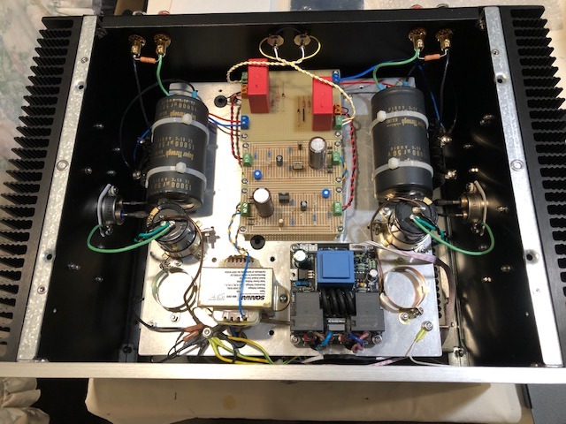

This is great news. I built the 25W choke loaded source follower SIT amp a few months ago using THF-51S, Hammond 195T chokes and Modushop 5U/400 case, as I had these to hand. Without question, it is the most transparent and musical sounding amp I've ever heard in my audio system, driven by Aksa Lender preamp. However, a bit more power would be nice to have on occasions, so this new design has much appeal to me. I used perf board in the 25W amp with success, but the prospect of PCB's for the 45W version is enticing. Should a GB eventuate, please count me in.

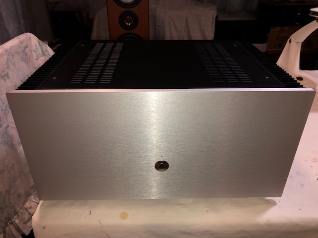

Here's a couple of photos of my 25W choke loaded source follower amp build.

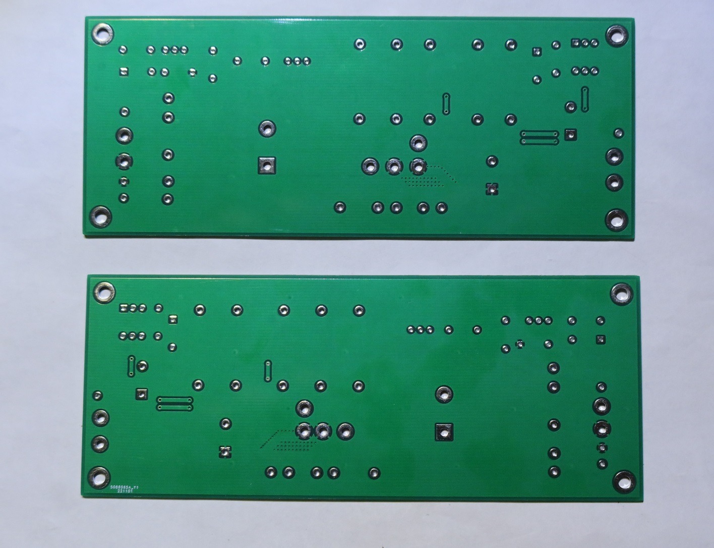

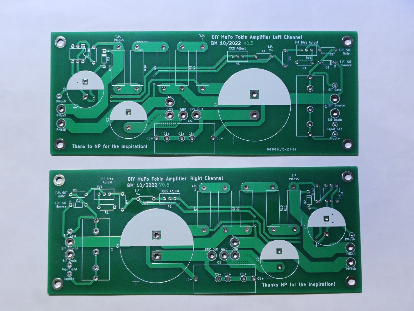

I received the amplifier boards yesterday. I went with the cheapest shipping option and it was air mailed. I ordered the boards on October 31 and the boards arrived 10 days later.
This was the first time ordering boards so I received a new-customer discount. The cost for five each of two different boards was $28.02 total, shipped to my door. Shipping was probably only a few days slower than by courier, but without the hassle of dealing with extra courier customs clearing costs.
With the boards in hand, I can see that the footprint I chose for the 1/4W resistors are a bare minimum in size. I will tweak that and move a few things around to give the components a bit more room. It's not absolutely necessary as the components should fit, but on the tight side.
I am going to order some parts from Mouser and hope to have a trial run sometime next week. If it goes well, I will order another test set.

Here's a couple of photos of my 25W choke loaded source follower amp build.View attachment 1107798View attachment 1107799
I can see you heatsink is one piece so it must be a 300mm (not 400 mm)?
I dream every night about 400 mm heatsinks 🙂 so chassis is a 5U 300mm not 400mm as mentioned at top?
Apart from that a nice build!
I have not read the full thread so how much power do you burn in those THF-51 and how hot does the heatsinks get?

You're right, heatsinks are 5U 300mm; my mistake. Thanks re build. To fit it into the Modushop case, I made a two level chassis with AC wiring, Meanwell SMPS's and chokes on lower level with bias and input boards on upper level. Re power, I'm running the THF-51S's at the operating points suggested by Ben for 2SK180's. That is, 35V and 2.5A respectively so dissipation is around 87.5W per channel. Heatsinks don't exceeded about 60-63 degrees (measured by infrared thermometer), even on a warm day. The SIT's measure less, around 52-55 degrees. I haven't run power or distortion measurements as yet so I don't know precisely how much power its making, but it sounds great in my system. I've tried it at 38V and 3A and apart from producing more power and running hotter, it doesn't sound much different.I can see you heatsink is one piece so it must be a 300mm (not 400 mm)?
Ok, if heatsinks gets about 60 degrees at about 88W it is a bit hot but ok.
Probably what I should expect for 100W at 4U 400mm heatsink. Will be interesting to see how good my heat spreader works.

There is something not right about those temperatures. I assume they are in Celsius. The heatsink measured hotter than the SIT does not make sense. I run my choke loaded 2SK180 at that dissipation (88W) with one SIT on a 300mmx210mmx40mm Modu heatsink and the heatsink does not get very hot. I have not measured the temperature but the fins only felt warm and I could keep my hand on them indefinitely, so l would say that the heatsink temperature was much lower than 50 degrees C. The 2SK180 was definitely much hotter.
The infrared thermometer reading is very suspect.

OK, yes I also wondered about that but concluded that heatsink was correct that area is rather large and should be easy to "hit" with the gun and the measuring direct at SIT was done from an angle maybe so reading was not that precise.
But nice to get other readings. The plan is to increase bias until heat sink gets around 65 C or so? 🙂

65 C at the heatsink fins is too hot. 55 C is generally the accepted maximum, although 60 C may be doable. Nelson's temperature determination:

Based on this scale the VFET amp gets around 50 C. That is a 300 mm 4U heatsink with about 60W on it.
55 C is a good compromise.

Temps are degrees Celsius. I have been wondering for some time about the accuracy of my infrared thermometer. It is quite old and seen a lot of action. Your comments tend to confirm my suspicions that it is not reporting accurate temperatures. I can hold my hand on the hottest part of the heatsinks for more than 10 seconds, so based on the temperature calibration nomenclature above, the actual temp is probably not exceeding about 50-55 degrees. This would be consistent with your observations at the same dissipation on the same sized heatsink. I think I need a new thermometer. Thanks for your comments.There is something not right about those temperatures. I assume they are in Celsius. The heatsink measured hotter than the SIT does not make sense. I run my choke loaded 2SK180 at that dissipation (88W) with one SIT on a 300mmx210mmx40mm Modu heatsink and the heatsink does not get very hot. I have not measured the temperature but the fins only felt warm and I could keep my hand on them indefinitely, so l would say that the heatsink temperature was much lower than 50 degrees C. The 2SK180 was definitely much hotter.
