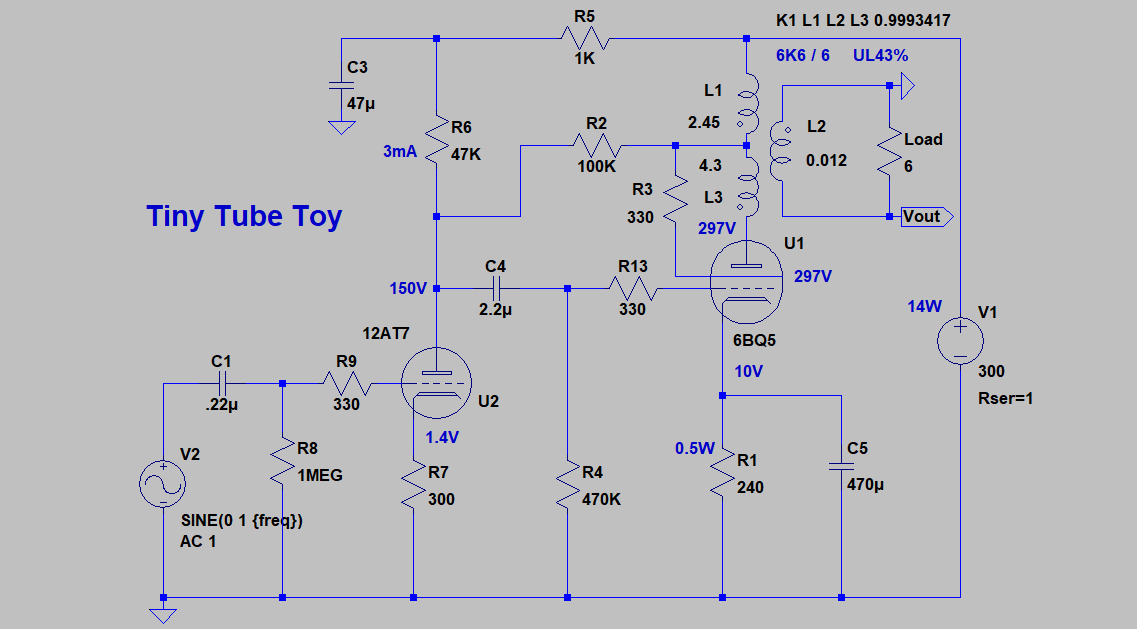

Single ended pentode with plate-to-cathode feedback
I am mostly curious how the pentode + choke load work, theoretically it shouldn't work (too low a load at LF), but the feedback can correct frequency response, at the expense of distortion?!
You were right to wonder about the choke load in the test circuit I used! While the choke load is just fine at low frequencies (LF behaviour can be tailored by adjusting the blocking capacitor) the choke hammers the HF response (-3dB@15kHz). I have reverted to an anode resistor, accepting a little more distortion in order to extend bandwidth above 20kHz (along with re-arranging other component values/voltages/currents to suit the resistive anode load on the EF184).

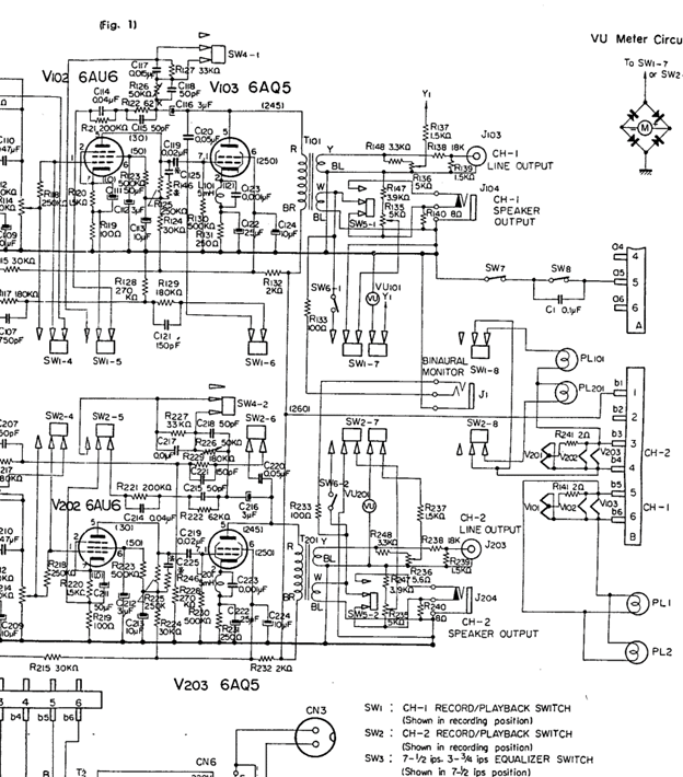

As a matter of interest, diyAudio member wrenchone provided a schematic of a Sony output circuit using feedback from the plate of the 6AQ6 to the cathode of a 6AU6.

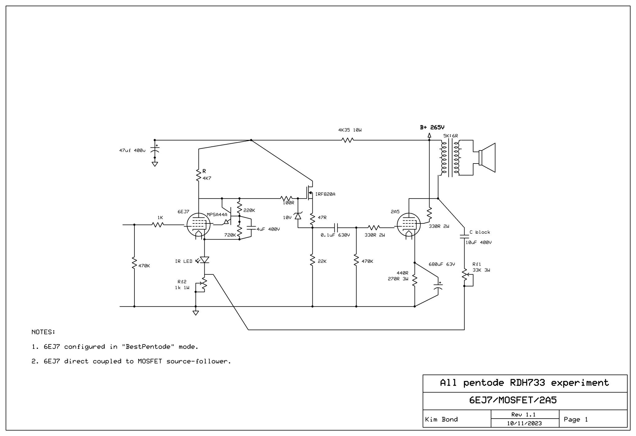

I would appreciate thoughts on extending the high frequency response the circuit on my bench. Presently, it is -3dB@21kHz, which is not ideal. To recap, replacing the 150H choke load with a 4K7 resistor as the anode load on the 6EJ7 extended the high frequency response. It is not improved/is unaffected by:
  • altering the coupling cap at the output of the source follower;
  • removing/inserting the source follower;
  • changing the output transformer;
  • changing the 6EJ7 topology to conventional pentode mode;
  • applying a "compensation" capacitor in parallel with Rf1;
  • increasing/decreasing the value of the 10uF coupling capacitor.
I think I am overlooking something obvious - feel free to point it out!
Turns out that it was the inductive potentiometers in the test rig (I used them to adjust the amount of feedback) that were limiting the high frequency response. I replaced them with fixed value resistors and voila, bandwidth is now out to a respectable -3dB@37kHz on cheap output transformers.
