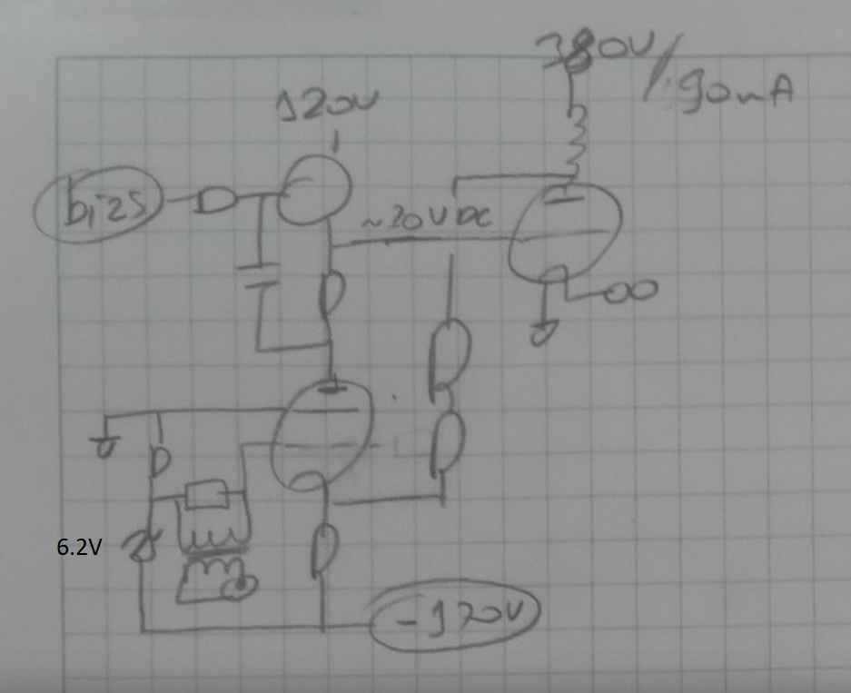

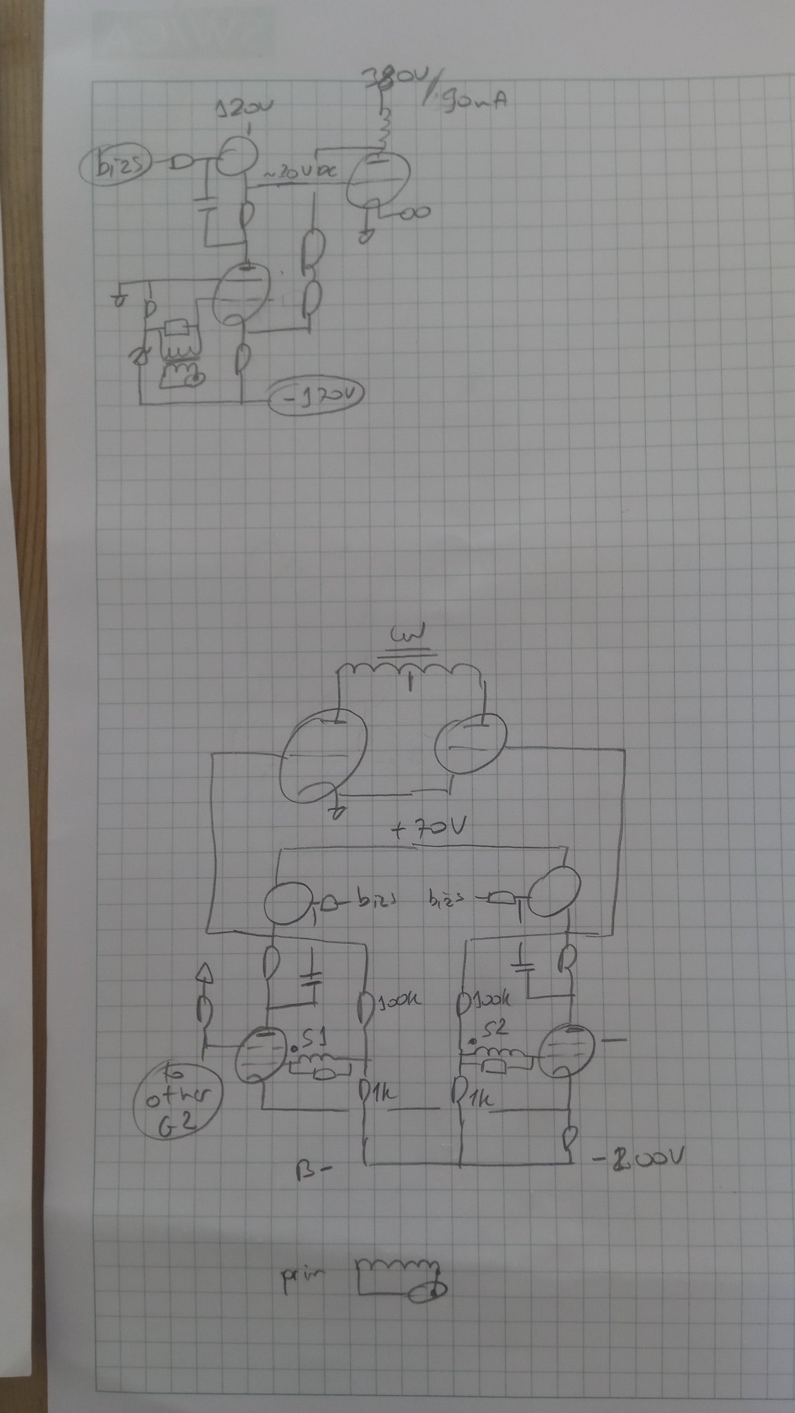

Thank you for your replies and links.
I wonder if for a simple 2 stages amplifier and IF the driver is linear and with sufficient gain, the better NFB is the shorter? ie: plate to grid of output tube only.
The current from the feedback resistor injected into the driver cathode load alters the driver's bias voltage. It adds a significant constraint balancing driver operating point against total available feedback. I benched it quite a bit guided by a spreadsheet covering the full range of operating possibilities before DC blocking. Maybe the highest gain drivers can get away with it but the 6F5 isn't exactly low on the scale. Maybe a pentode mode driver?Usually there is no need for a series blocking capacitor as the feedback resistor has a significantly higher value for the same NFB in dB as from secondary , so the DC voltage from output stage plate is low .

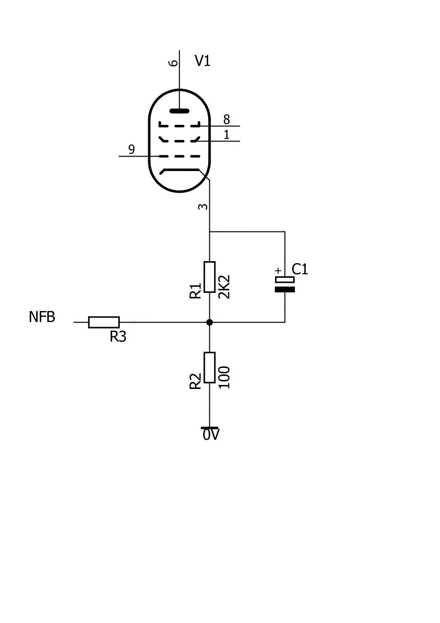

If you don't want to change nothing more than 1 feedback resistor , than maybe you should buy an already modified amplifier ... 😆
The cathode resistor should be split like it is in many designs using a bypass capacitor , if the part that is in NFB loop is small in value , than the DC has very little effect and you don't need to rebias the driver

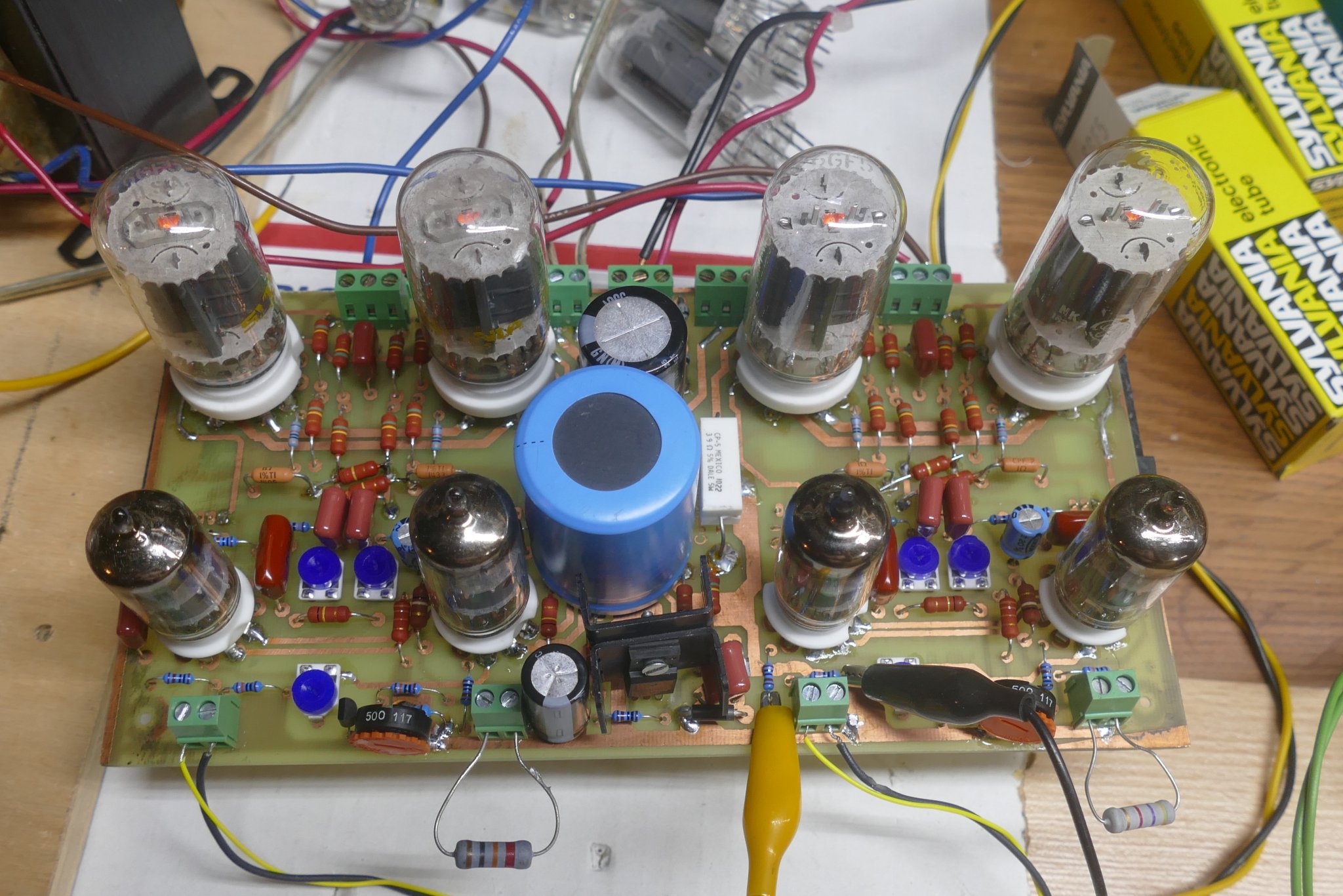

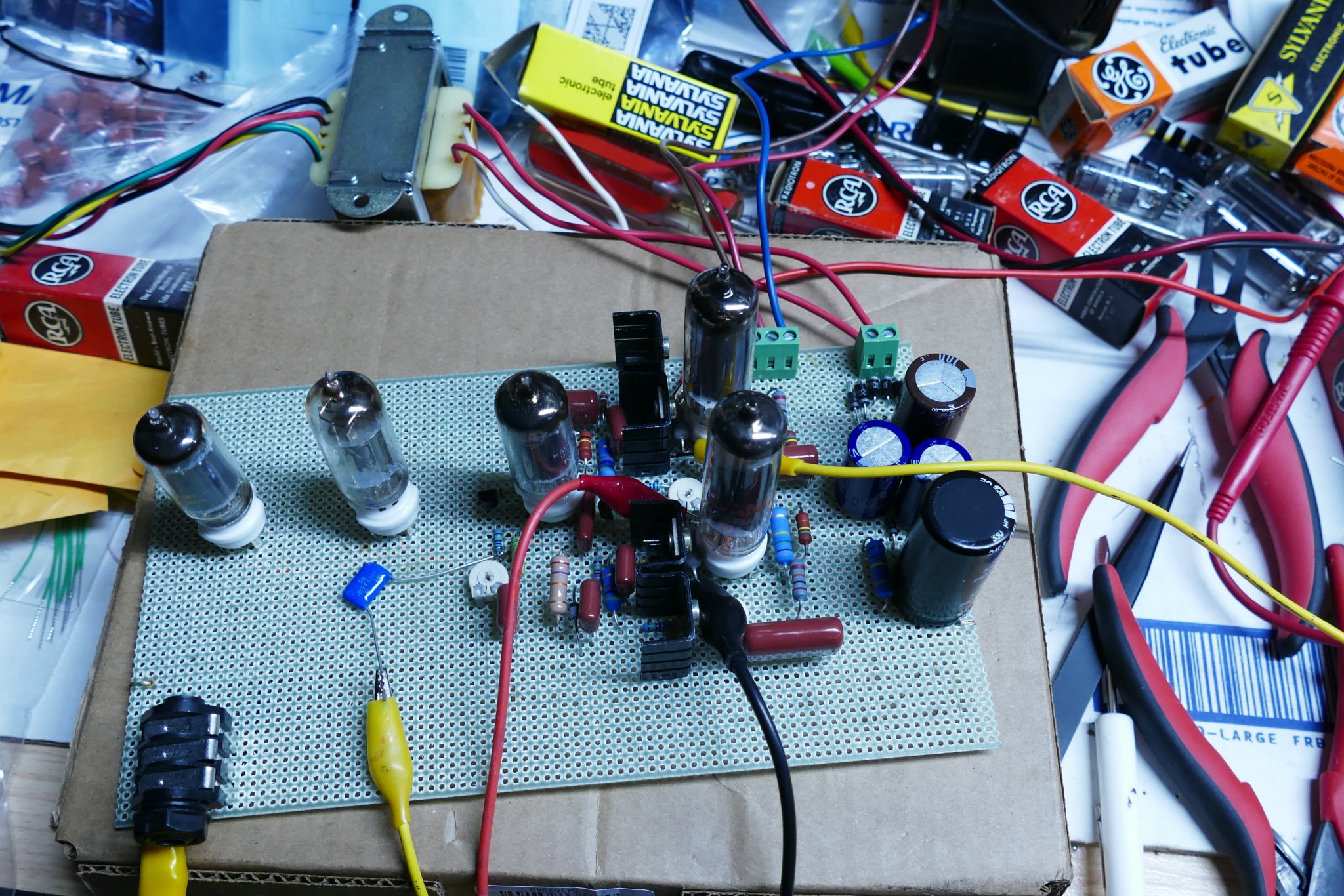

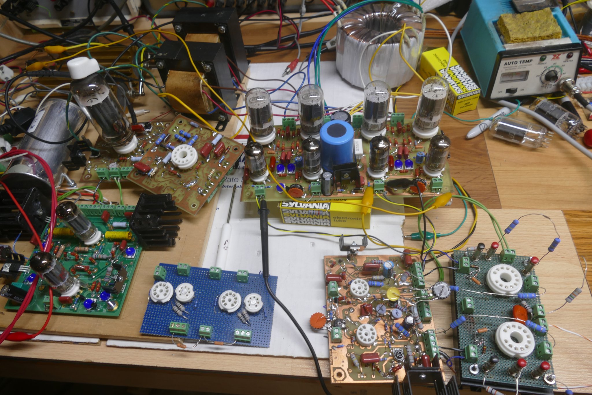

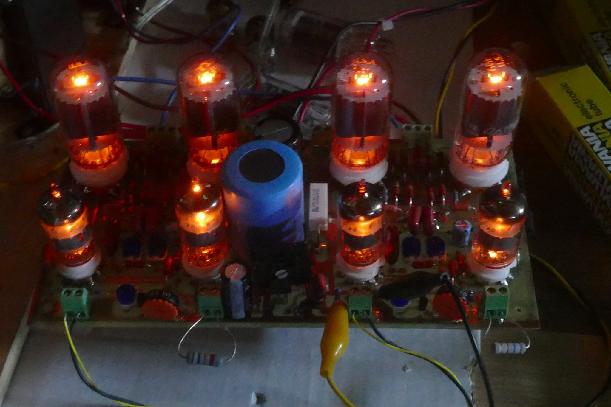

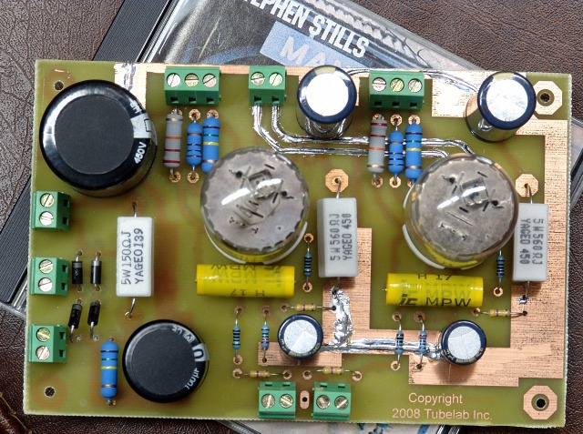

I had been tinkering with various non standard feedback paths off and on foe several years. I made a few test boards with a P / N channel mosfet pair on every element of a pentode except for the plate and heater. This could be used for applying DC voltage with a superimposed AC drive, feedback or both signal present. I built a board with a 12 pin compactron socket for playing with big sweep tubes, and a smaller perf board with a 7 pin and 9 pin miniature socket for the small stuff.

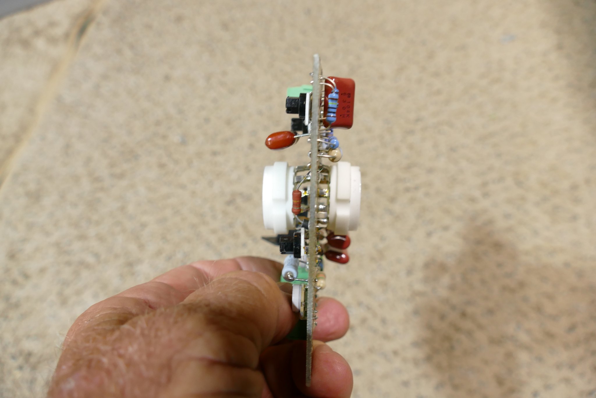

I screwed up and put the tube socket on the wrong side, so I simply added a second tube on the other side.
I often just tried random stupid ideas to see what would happen or played with a circuit in LT Spice before breadboarding it up. I tried two stage amps with several different feedback paths, or more than one path at the same time to see what they did. Two that have not been mentioned here yet are a resistor from output tube plate to the driver tube plate, or a resistor from the output tube plate to the driver tube screen grid.

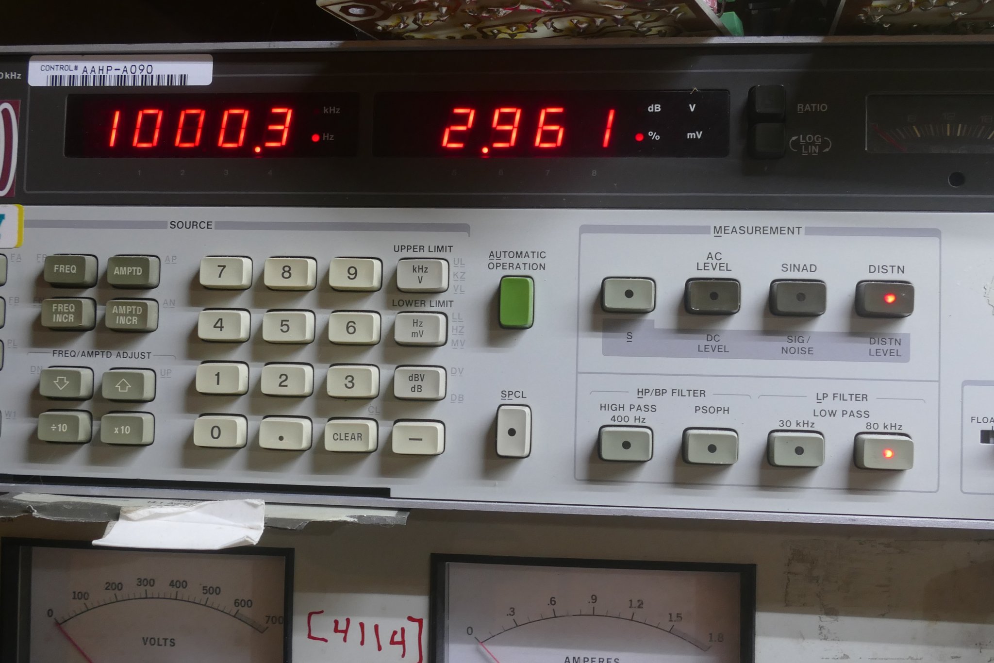

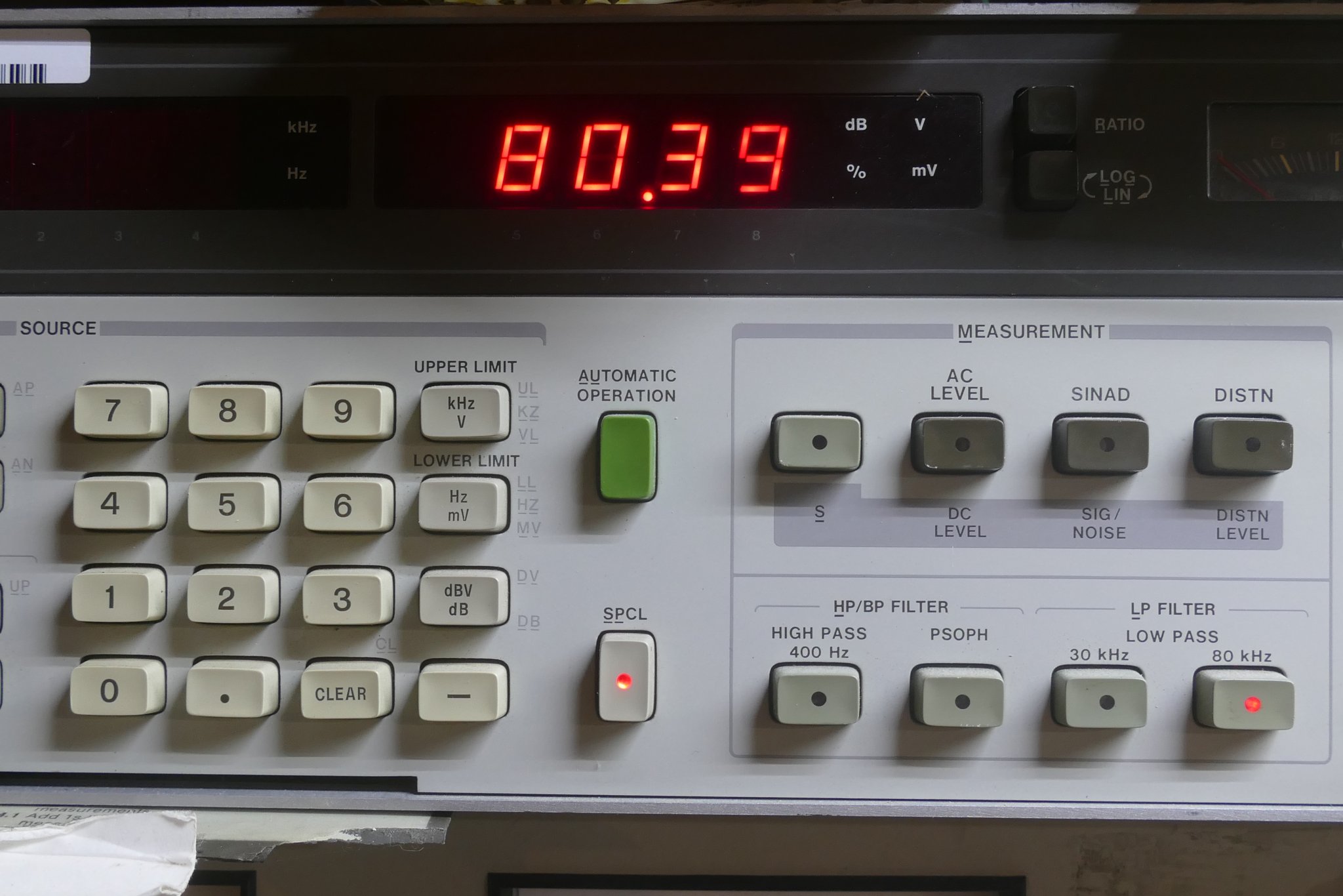

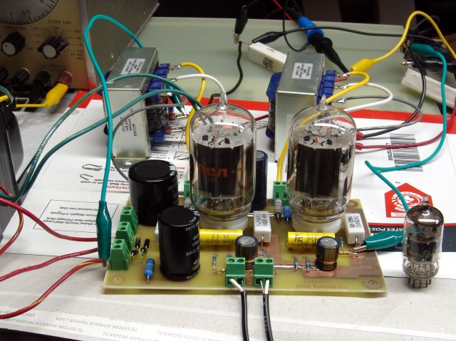

It has been said that plate to plate feedback doesn't work with a triode driver, but my little SPUD board worked quite well with this kind of feedback.
There was a discussion about reducing the cost of a typical guitar amp that was scattered across several threads in the instruments and amps forum that set me on a course that led to the development of the UNSET design. The original reason for the research was to eliminate the negative voltage bias supply in fixed bias amps. The first "success" was this little guitar amp breadboard that extracted 20 watts from a pair of tiny 50C5 radio tubes in push pull from a single rail power supply of 330 volts derived from a voltage doubler on the output of a Triad N-68X isolation transformer.
That led to a little stereo amp that squeezed 80 WPC at 3% THD from two pair of $1 tubes (6GF5) being driven by another pair of $1 tubes (6KT6) on a 500 volt regulated bench supply. The same board made 60 WPC when powered by an Antek toroidal power transformer. The performance and sound quality was excellent, so UNSET was born.
The last picture shows the collection of boards and experiments that got to this point.

Thanks. While that works it replaces, in my example, a 0.33 uF polypropylene in the signal path with a large electrolytic. Boils down to personal choice but not my preference. Still not seeing how your second suggestion would work.This are typical values
Many existing amplifiers are made just like that , if you have one unbypassed resistor you add that small one in series and connect the NFB there , not in the cathode like it is ...
