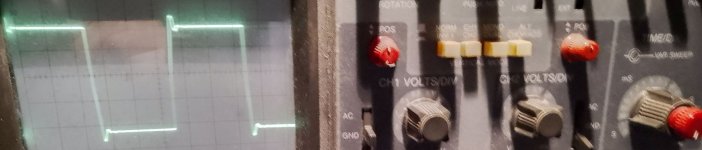

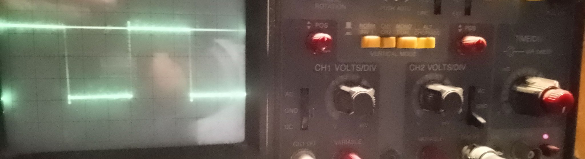

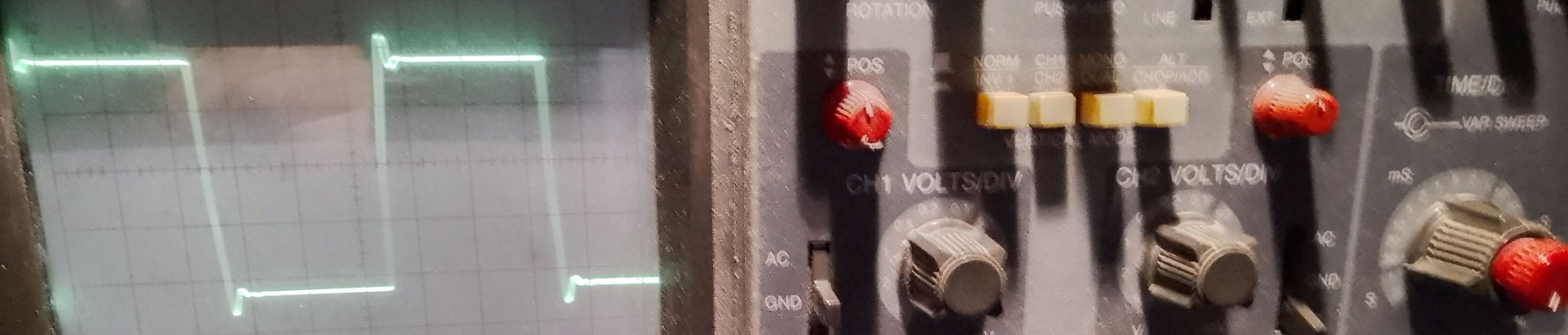

Sorry for the intrusion again, I wasn't talking about curves, but about transient response which with that connection to the Shade translates the transient response from pentode to triode. If I can I'll show you some measurements.The curves in Schade are similar to UL config. and not triode,
The picture in the original article show the curves
Walter
OkIf I can I'll show you some measurements.
Even I can’t understand the “transient response” related to the triode or pentodo config

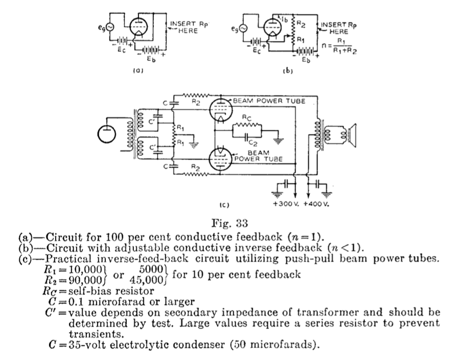

Can someone draw the schematic and explain with formula Shade concept?
How to calculate amount of Feedback? what is the elements configuration etc.
Please?
Is feedback amount, ratio of R2 / R1 in this schematic?
The artcleCan someone draw the schematic and explain with formula Shade concept?

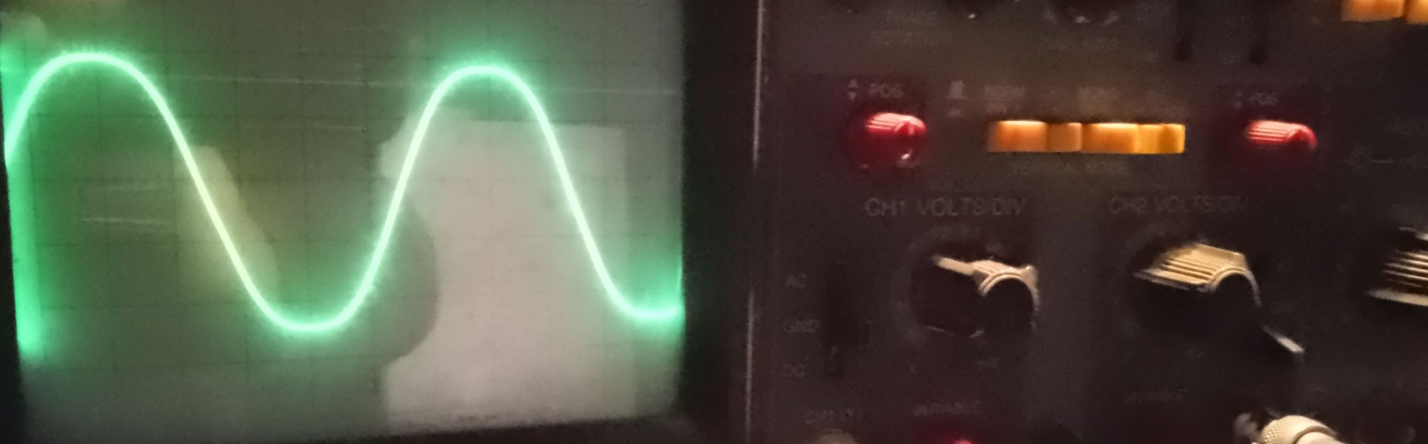

I am playing with different config of FB
Walter
all'onda quadraOk
Walter

Now it is a significantly more clear.
feedback amount for n less than 1 where 1 is 100%
n = R1 / ( R1 + R2)
I will redraw the schematic to more clear variations.
there is some mismatch on the schematic 50uF/35V should be marked as C2
last line in the picture...
btw
on Bartola Schematic R1=10K Rpot should be set to 90K for n=0.1 10%
"G" point is not for the input signal as from the way of drawing could be conluded, BUT for negative grid bias.
This is for measurement only - that was confusing...
For operational circuit, we need couling C in between R1 and R2 at the very G1 pin3.
With R1=10K, it is actually Rg, that coupling C should be minimum 10uF.
Note that in original Shade sch transformer used - not coupling C, so the 10K value is more appropriate.

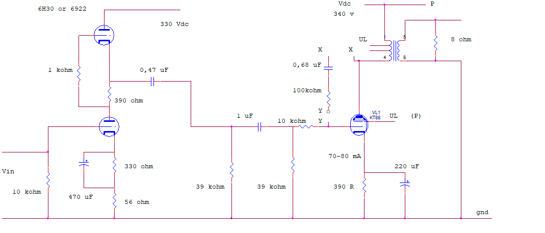

In my case is around 13%. But is a first stepBartola Schematic R1=10K Rpot should be set to 90K for n=0.1 10%
Walter
?In my case is around 13%. But is a first step
Please show calculations of FB % in Your arrangement?
The closest I can get is 15%
R1 = (39K II 39K )=19.5K, R2=10K+100K=110K
n=19.5K / (19.5K + 110K)=0.15
or I am calculating wrong way?
I have took the signal on load. We have to consider also some lossor I am calculating wrong way?
On firsts test poster there is a value. More than 13 dB
I every case I will change a little bit the config with a pot to check different ratio of FB
The schematico is the one I will use; until now I used only the power stage

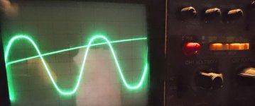

Next step will the use of a pot to set different % of FB having as 0 dB as level in pentode config
Checking the freq.response, the variatin of level moving from 8 to 4 ohms and FFT, in case also phase
I also built a balanced PP pentode amplifier without general feedback, but connected to Shade which behaves like a PP triode, but with pentode power. I basically connected only 2 resistors...
I have seen the pictureall'onda quadra
It seems be good but I mean a set of test more in deep
