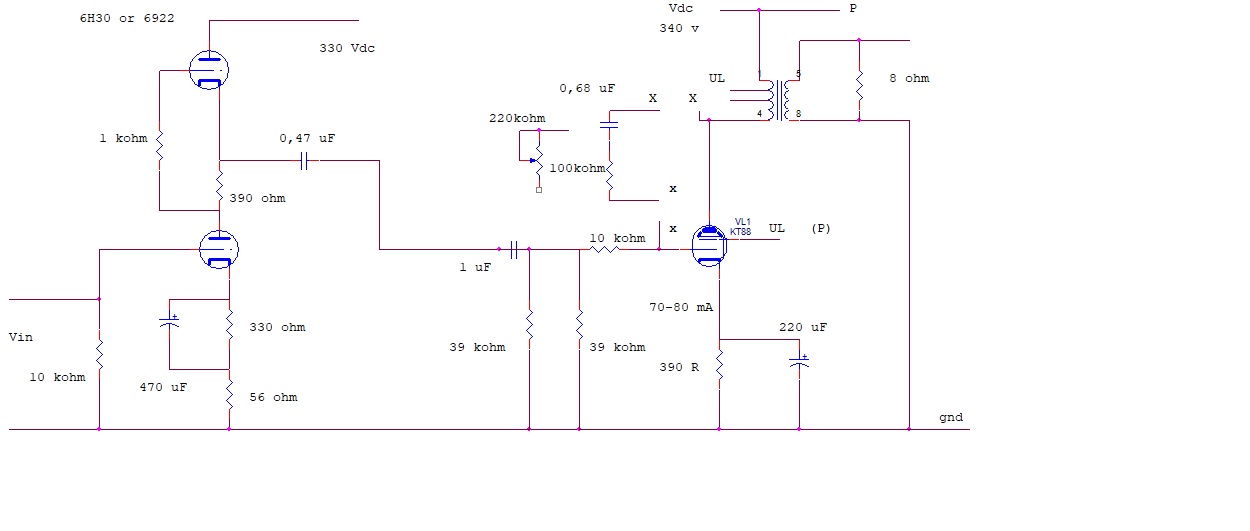

This is the last version of circuit
I add a pot to trim the value of FB
I am working with Hammond mainly and after some tests, with the others
There is also a little changing on Vg2, just to find a better THD, 20 -30 Vdc less.
The 10% of FB declared by Schade I think is found varing the pot of FB ( in my case 220K + 100k, in case) from the value read in pentode mode measured at load.
This make a sense for me, there is a little loss for due the magnetic copupling and Rdc of secondary but it is negligible.
In my case I set as 0 dB ( reference) 3 volt on 8 ohm, it is a start point.
Another consideration is about the Zs on generator that is involved on circuit; in my case with Ecc88 the Zout is around 600 ohm, but the impact is very low; with AP from 20 ohm to 600 hom some little changes are visible.
I will check with the use of 6H30 and, last step, with a common cathode stage with higher Zout.

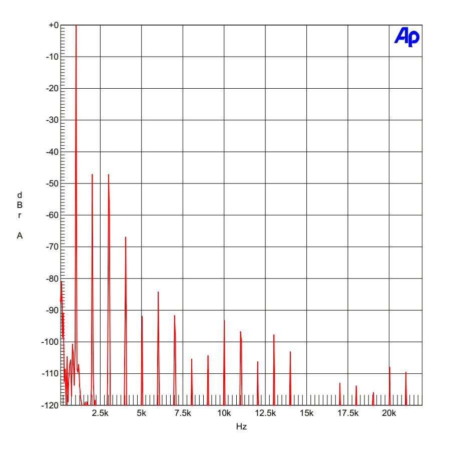

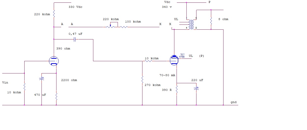

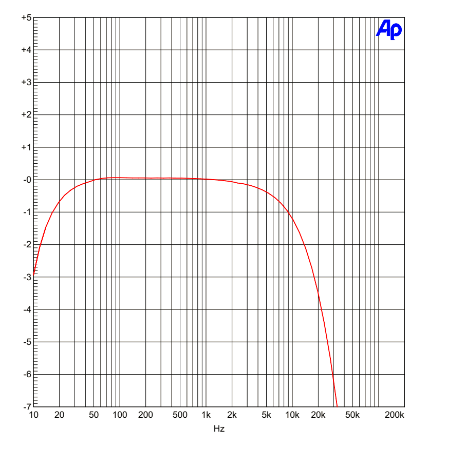

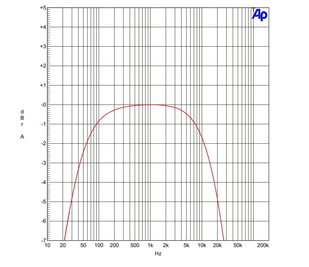

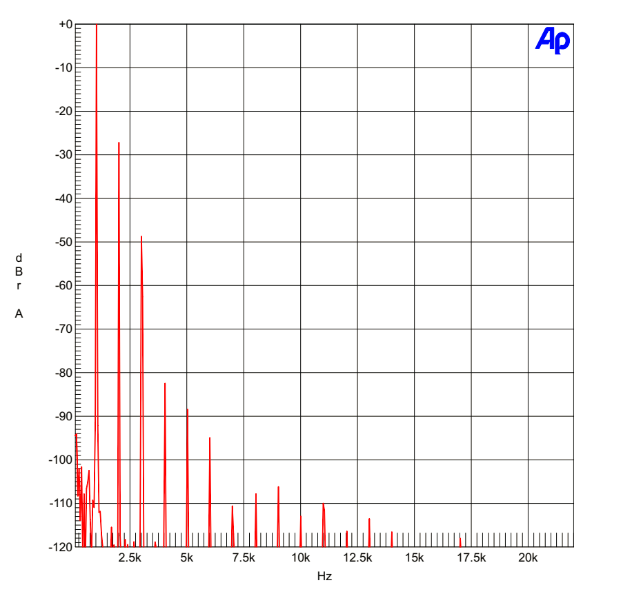

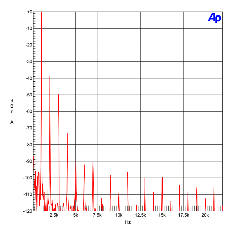

Some other test
Another circuit ( the previous one is in stand by), Hammond 1627SE used
This one uses a ECC83 to drive a KT88 with the use of Schade and UL
The circuit

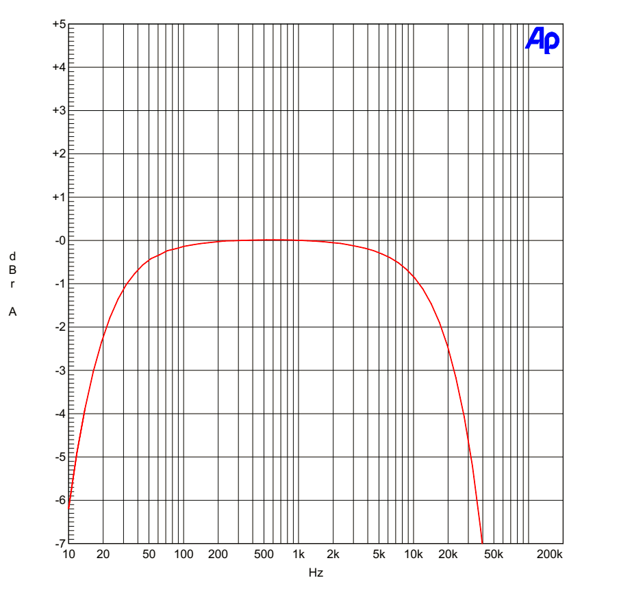

The start point is to set the Vout at 1 watt on 8 ohm as 0 dB.
This was done in pentode mode
Vdc = 335 v
Ia = 80 mA
Rk = 390 ohm
Rg = 270 kohm
Ecc83
Vdc = 330 V
Ra = 270 kohm
Rk = 2k2
Ia = 0,65 mA
Vanode = 165 v
Pout 1 w
con 37 mVin
THD = 1,6 %
The FFT

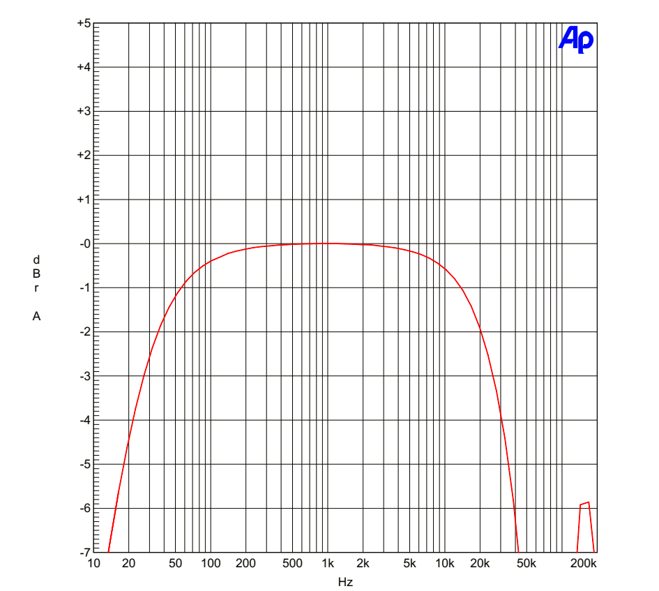

The response ( poor)

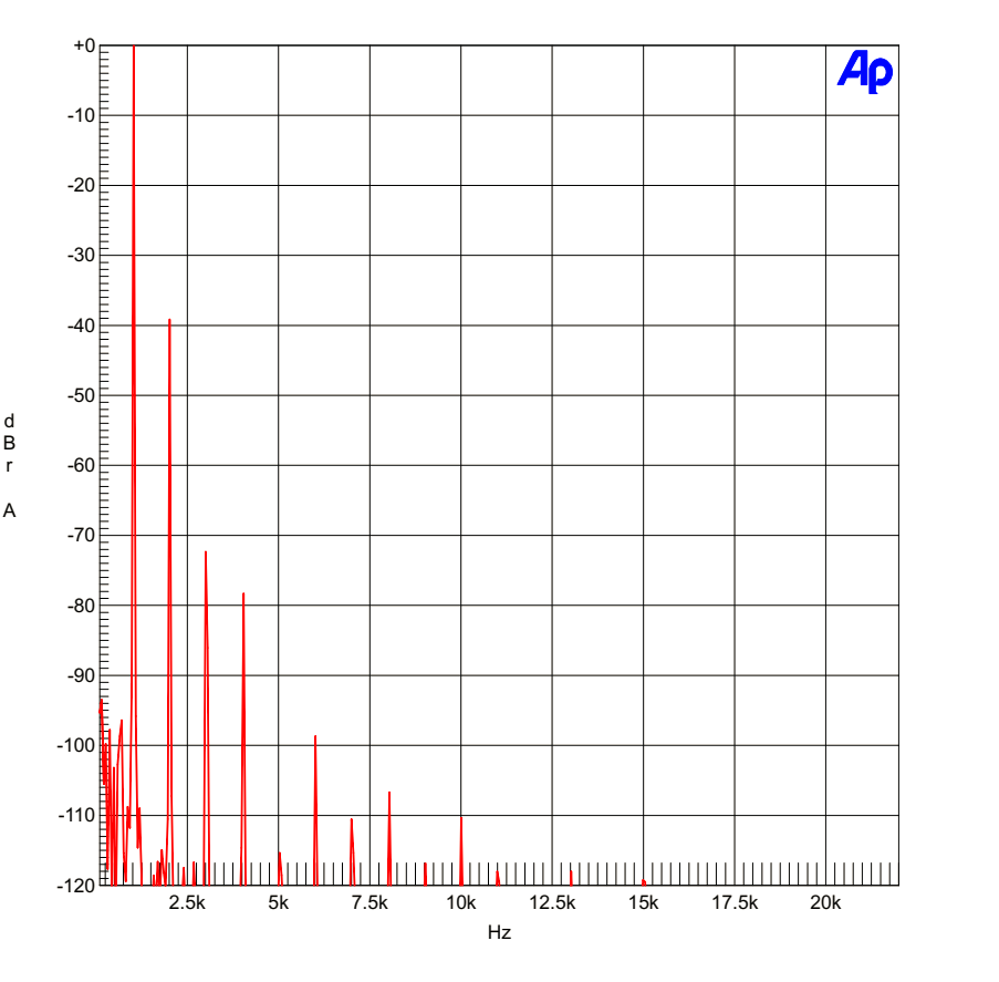

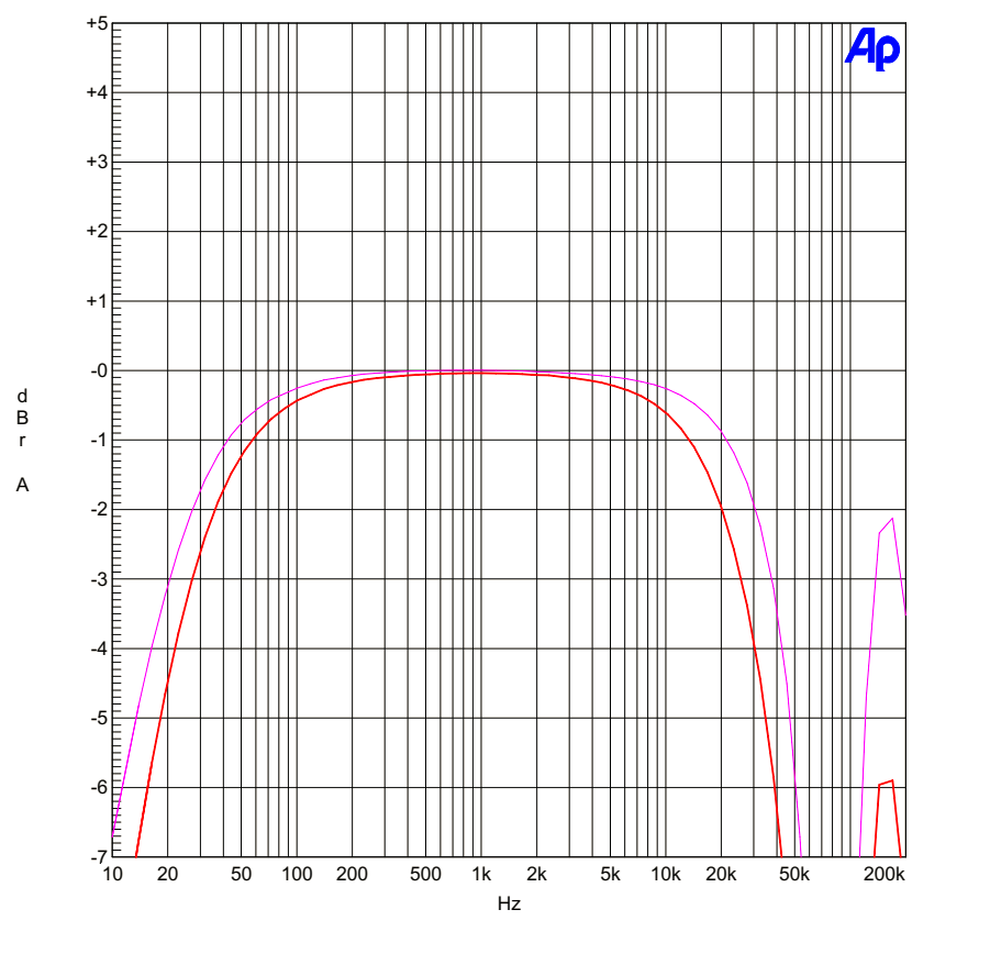

The two resistor of FB in the test was changed for test
Schade with 6 dB of FB ( from 0 dB in pentode)
Vin = 85 mV for 1 w
THD = 1,25 %
Rfb = 1 Mohm (feedback)
The FFT
The response

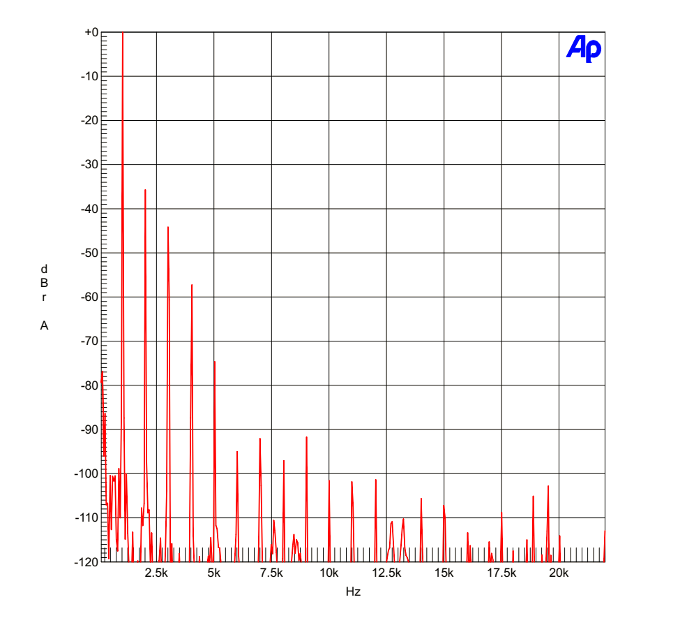

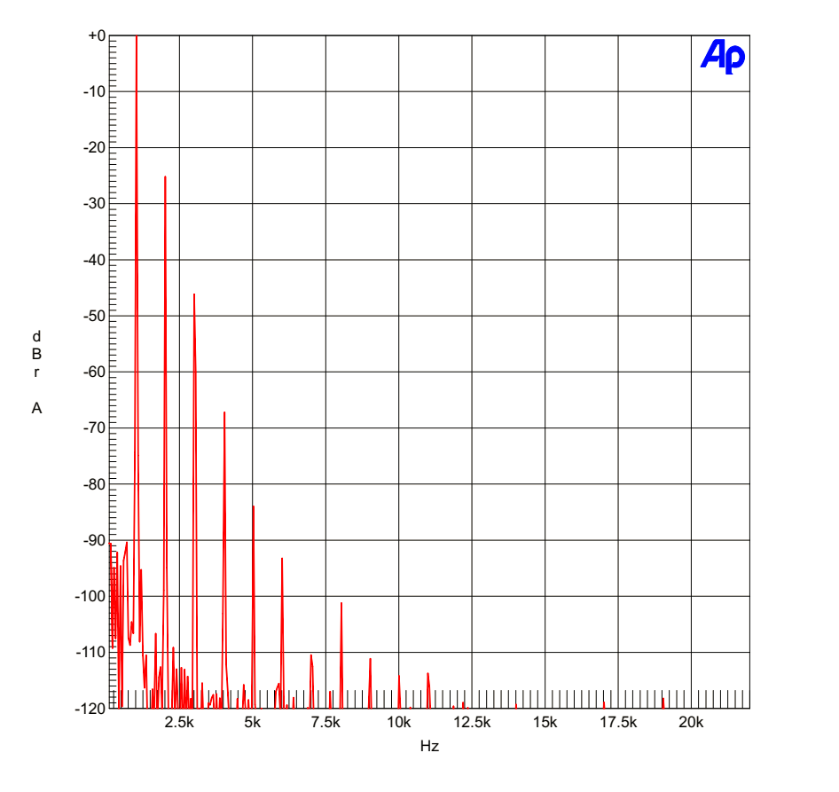

12 dB of FB
Vin = 170 mV for 1 w
THD = 4,5%
Rfb = 348 kohm
The FFT

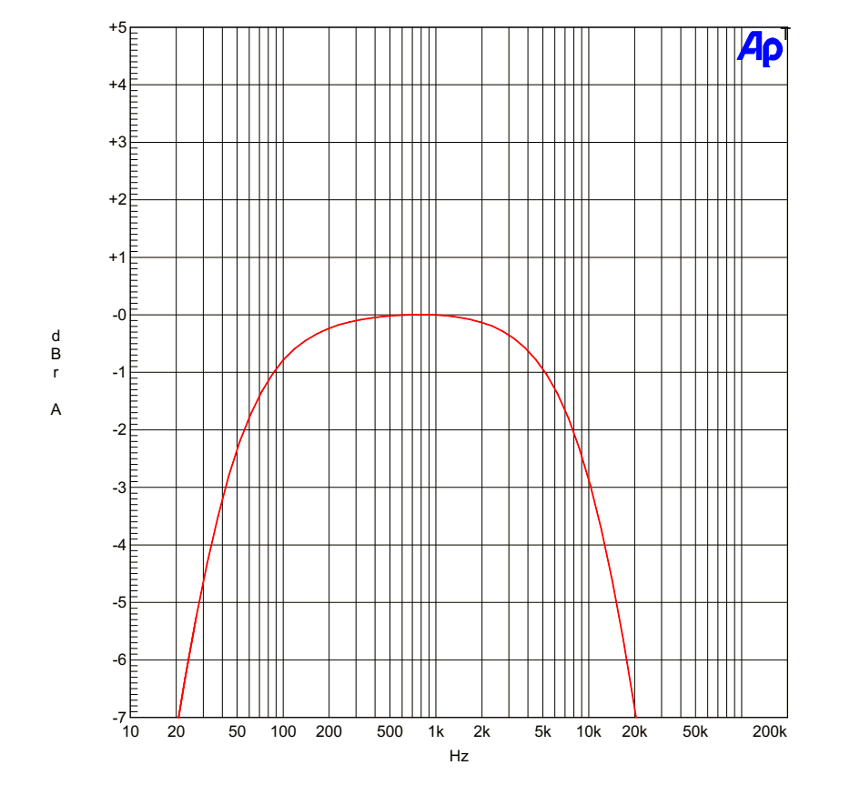

Last
Same circuit taking the Va for 83 from anode of 88
FB =10 dB
Vin = 105 mV for 1 w
Thd = 5%
Rfb = 800 kohm
The FFT
The response
The circuit
Vdc = 335 v
Ia = 80 mA
Rk = 390 ohm
Rg = 270 kohm
Ecc83
Vdc = 330 V
Ra = 270 kohm
Rk = 2k2
Ia = 0,65 mA
Vanode = 165 v
Pout 1 w
con 37 mVin
THD = 1,6 %
The FFT
Vin = 85 mV for 1 w
THD = 1,25 %
The FFT
The response
12 dB of FB
THD = 4,5%
Rfb = 348 kohm
The FFT
Last
FB =10 dB
Thd = 5%
Rfb = 800 kohm
The FFT
The response
UL config
40%
no additional FB
The FFT
The response
The consideration will be done at the end, when other test will be done
I got some first impression, of course
Walter

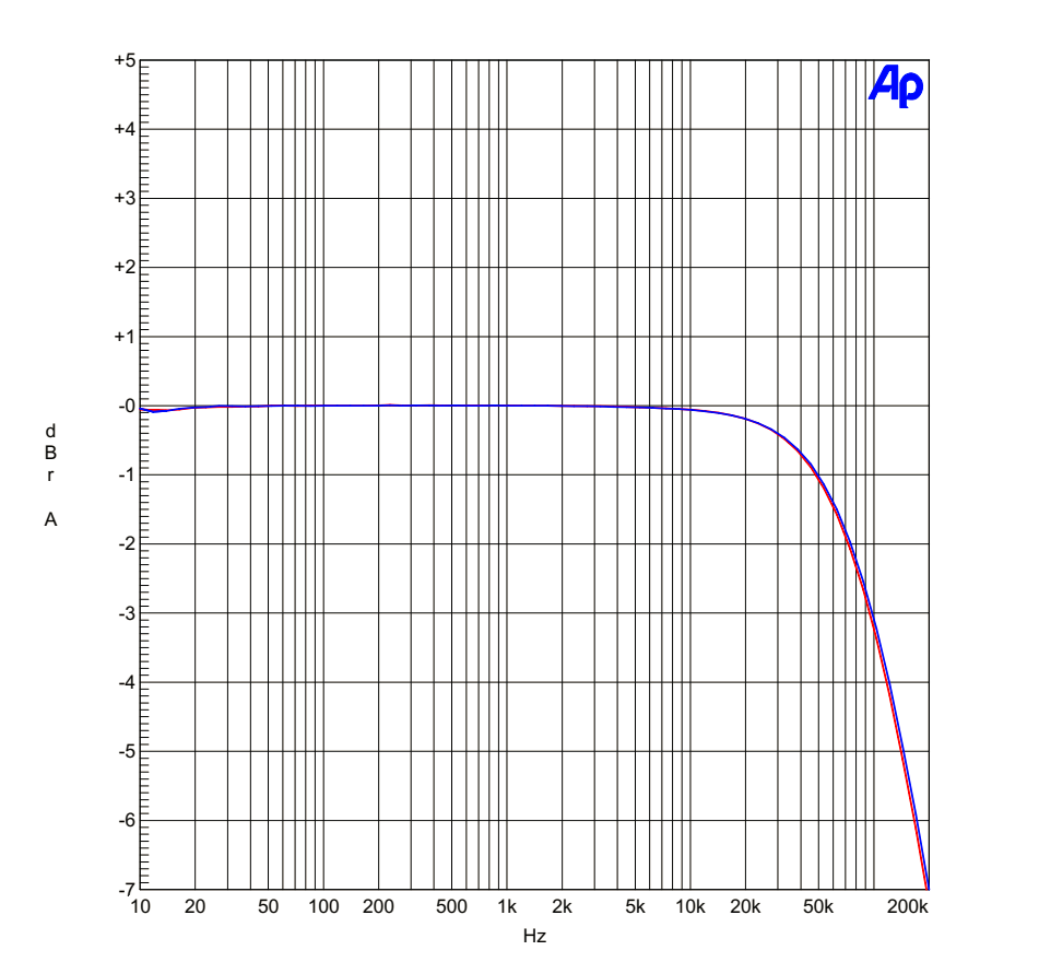

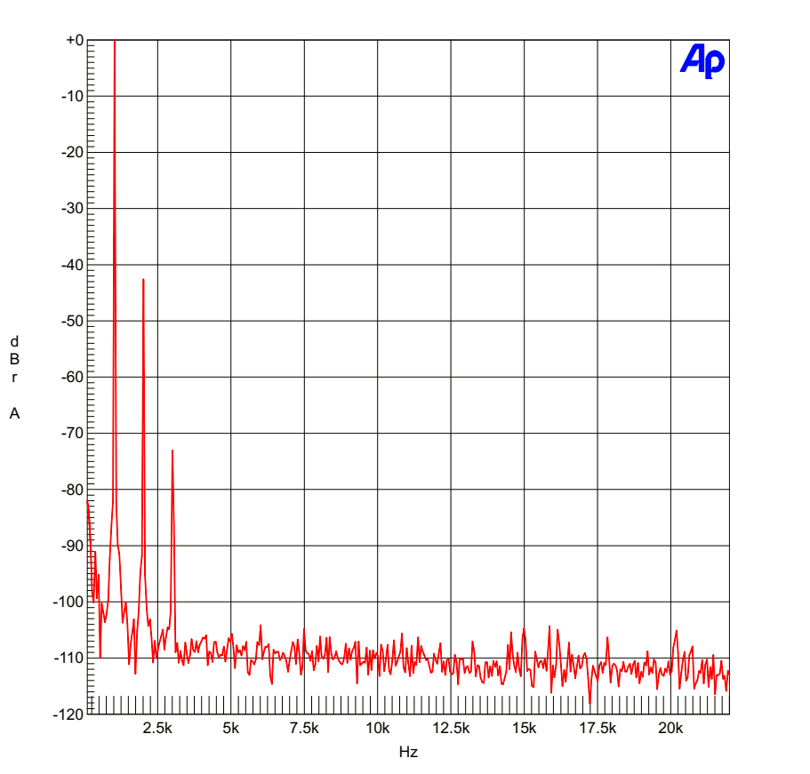

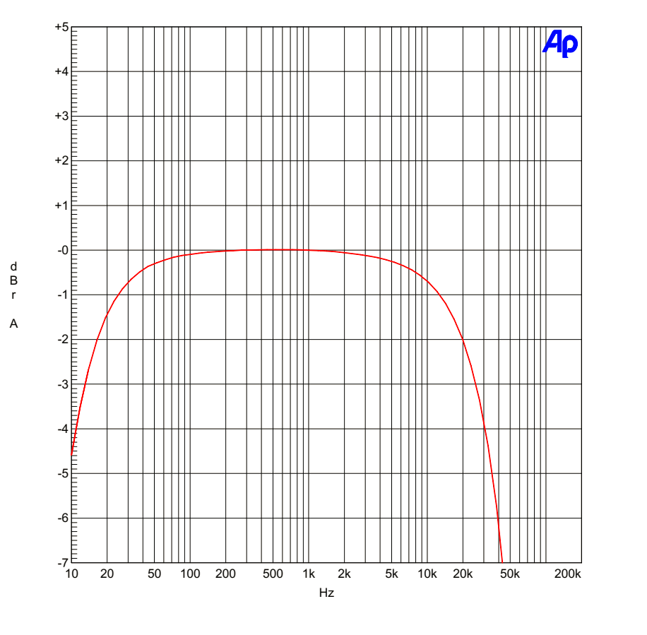

Two test of the input stage with ECC83
Signal taken on grid of 88 ( not inserted) with a differential probe having a great Zin
Gain = 63
100 mVin = 6,3 Vout with 0,76%
The FFT
The response
There are two lines because I used two different signal cables with different value of capacitance
Walter
Gain = 63
The FFT
The response

Ciao Walter,
please do not be upset, but with that circuit you will never get good results.
It is a waste of time to perform measurements without knowing what works best in a specific scenario.
As I already wrote you, to get best performance you need a driver able to easily drive low loads.
A 12AX7 with 270k as plate load will collapse.
I got good results (no measurements, just set the amp to hear some music) with:
B+ around 400V, g2 at 200V, Ra 3k, the KT88 fixed biased at 35W to keep 220k from g1 to bias.
As a driver a 12AT7 with 33k as plate load and 150 Ohm as unbypassed cathode.
100k from kt88 plate to 12at7 plate.
I suggest you to try this configuration and play around it.
It will help you make reasonable measurements and get a better idea of how Schade limits can be reached.

I understand that you put measures above everything, and I really appreciate that you started doing measures about this topic after I talked about it on the italian forum.
I’m sure that some more tests will be much appreciated by everyone.
But to have useful data, first of all it is needed to master the theory, otherwise you will only prove that doing things in a wrong way gives no results.
I started my journey in Hi-Fi with this kind of feedback, understanding its limits in PP and SE.
Then I switched from parallel to series applied voltage feedback, again understanding its limits and strenghts.
This lead me to patent an improved system with the purpose of removing drawbacks of both kind of feedbacks.
If you want to perform some reasonable tests, you must chose a low rp driver and an high gm output tube with limited plate swing.
12AT7 and EL84 in pentode are the combo I suggest you to start with using logic based on theory.
Parallel applied voltage feedback trades gm for rp on the output tube, at the expense of its input impedance.
Using a weak 12AX7 to drive a KT88 in SE you are doing exactly the opposite of what theory suggests to be the right way to make it work properly.

Other test with ECC88 as input
Va = 300 Vdc
Ra = 19 kohm
Rk = 390 ohm
Ia = 7,7 mA
G = 21
Pentode config
Vin = 80 mV
THD = 1,7% 1 watt
Freq Resp
FFT
Schade 6db FB from Pentode
Vin =170 mV
THD = 0,64 % 1 w
Rfb = 111 kohm
Freq. Response
FFT
Schade 12dB FB
Vin = 320 mV
THD = 3,55 % 1 w
Rfb = 40 kohm
Freq. response
12dB = violet curve
6 dB = red curve
Other tests will come
