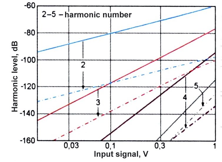

Thanks to X-Pro for good explanations!
Attached is a measured harmonics level improvement shown by arrow for each harmonic number.
Measured for russian KT3102 transistors with 3.5 V over R2 on the x-pro post #27 schema.
Simulation and measurement well coincide, THD for KT3102 drop from 0.11% to 0.0017% for 1 V input. With other transistors more or less may be but by the factor of two order.
A circuit output OUT2 not only voltage but also current corrected if apply low impedance between OUT2(post #27) and positive rail or ground.
An error correction in circuit due to R3 (post #27) add a compensation of Q2_Ube variation to the output in proper value and phase.

Dear Mr. Mikhail,
As I understand this very interesting circuit is a your creation thank you very much indeed and sincere congratulations for the excellent distortion figures.
Please excuse my trivial questions but I am a beginner here:
1) what is the output impedance of out2 ?
2) what is the voltage gain at out2 ?
3) is the signal out2 suitable to drive a 10Kohm input power amp?
Please excuse me again and congratulations again.
Kind regards,
beppe

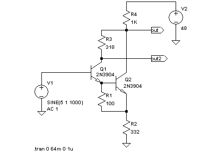

To beppe61:
look at #27 picture please
1) output impedance of OUT2 is R3+R4
2) voltage gain is G=R4/R2
3) any load possible. For R_load>>R3+R4 gain is G=G=R4/R2.
For R_load<<R3+R4 circuit is a voltage-to-current converter with forward transfer conductance G=1/R2
If R_load is compared to R3+R4 gain becomes lower G<R4/R2, due to resistor divider.
Schematic:
http://www.diyaudio.com/forums/attachment.php?s=&postid=857017&stamp=1141087423
This is the circuit we are trying to understand
it has very good performance, from out2
I know I know.
I am trying to understand it as well.
In the end out2 does not provide voltage gain.
Nevertheless the distortion spectrum looks great indeed with all harmonics at -120dB maximum.
Thank you and regards,
beppe
Mikhail's cct seems not tobe an error correction, but a very linear one. For me, to be said error correction, there have tobe input and output to compare with. With output from node2 (collector), there is no comparison made.
lumanauw said:Mikhail's cct seems not tobe an error correction, but a very linear one. For me, to be said error correction, there have tobe input and output to compare with. With output from node2 (collector), there is no comparison made.
If the output compared with the input it would be a feedback circuit. In Mikhail's circuit we have pure and simple error correction, where by adding two distorted currents together we get a very low distortion output. There is no overall feedback in this circuit. If you'll experiment with my example in a simulator you can see clearly that both collector currents do have high distortion content and R3 needs to be adjusted to get the best linearity. As Mikhail already did point out, the circuit works essentially by measuring Vbe (variations of it create distortions) and by adding the error signal to the output in an opposite phase, cancelling distortions. As another example I attach the version of the circuit with gain 3 and in the next post will attach the FFT result for 6V p-p output from out2 of this circuit. Note the increased supply voltage.
