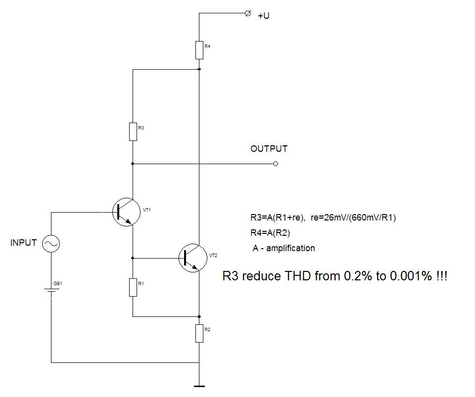

noname said:a very simple modification of Darlington with only one rsistor,
reduce THD 100-200 times -
from 0.2% to 0.001% measured.
It would be proper to note that this circuit was published in Russian magazine "Radio" (12-2005) by M. Kulish. Here is the first page of that article (djvu) :
A big problem with that circuit
is that if you use one single darlington transistor, like BC372 in first simple example,
this circuit will be impossible.
You have to use 2 transistors, in a darlington arrangement.
There is a difference using one darlington transistor
instead of 2 transistors in darlington.
In first case you have not many choices to modify or add resistors.
This is one major reason, why one darlington
is ALMOST NEVER USED in high quality audio circuits.
Including power output stages.
Here is a bit more about that circuit:

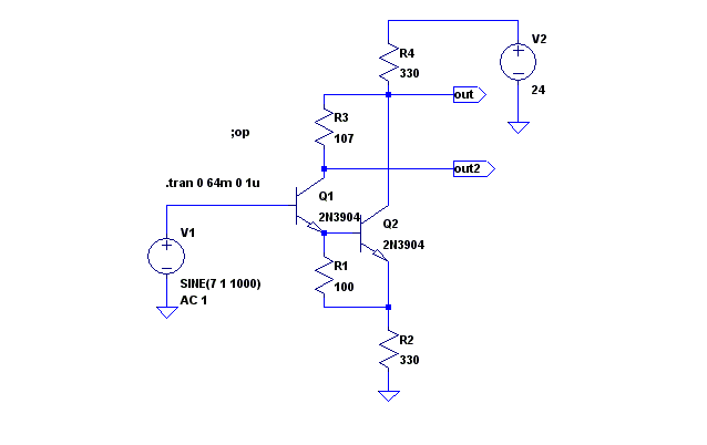

I've simulated the simplest circuit from that article in LTSpice. Here it is:
It is not a darlington as such, rather a two-transistor error-correcting circuit with a very good performance. In the next message I will attach the result of the simulation - FFT from "output 1" and "output 2" for 2 V p-p input/output.

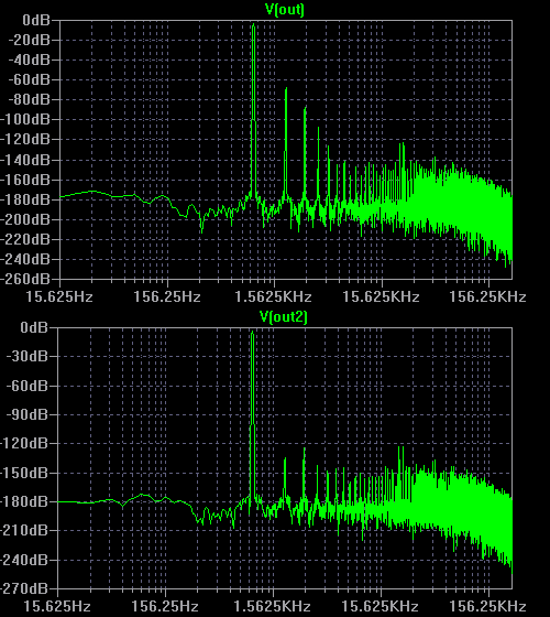

x-pro said:And this is the FFT graphs:
Is a dramatic improvement, taking output from point 2.
And the simulated response of output 2, is at real Hifi level low distortion.
Dear Sir,
thank you so much for your extremely interesting posts.
In your experience how does the output from the sim programm compare with the real output on the oscilloscope?
Thank you very much again.
Kind regards,
beppe

it appears that the darlington configuration but taking out2 as the output is using the second transistor as a ccs.
Would similar results be obtainable if a real CCS was put into the emitter of either TR1 or even into both TRs or into the whole darlington emitter connection?

beppe61 said:In your experience how does the output from the sim programm compare with the real output on the oscilloscope?
It usually gives you a good idea about behaviour of a circuit however there are many limitations especially in simple simulators and you shouldn't trust them too much.
x-pro
beppe61 said:In front of Q1 no resistors or caps are needed (to fix the base voltage) ?
I.e. is the schematic ready to build as it is ?
If you look carefully at my simulation circuit you'll see that V1 voltage source has 7V DC component. So the answer is: you'll need a proper DC biasing and coupling capacitors on the input and the output.
x-pro

Dear Sir,
I have to tell you that my knowledge is very basic.
So I would need a confirmation on the following.
Do I have to put a voltage divider in front of Q1 to get 7V at the Q1 base and of course a nice input coupling cap ?
If the real output resembles even marginally to the V(out2) sim output I have found my new line stage !
I promise not to disturb you anymore.
Thank you very much.
Kind regards,
beppe
AndrewT said:Hi,
Second transistor here is not CCS 🙂 . It is an error-correction circuit where one transistor provides most current and the second provides for a correction signal. The sum of two currents makes a corrected low-distortion output.
x-pro
