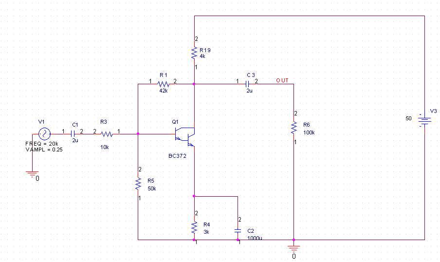

I wonder if it is possible to build a line preamp just with one small power darlington.
If I am not wrong it could provide voltage gain and low output impedance to drive adequately a normal power amp.
Opinions are very welcome and appreciated.

a) do smal power darlington exist?
b) where can I find a suitable schematic to be used as a line pre?
The cost of the experiment should not be that great.

I feel like paraphrasing any number of american movies: "Just answer the goddamn question!"
Yes, you can use a small power darlington for this purpose. However, I suspect you mean a small signal darlington, such as BC516(PNP) or BC517(NPN).
Connection would be pretty much identical to you Sziklai pair preamp, with just the polaritiy of the second transistor reversed.
How it would sound? Well, you'll be the judge of that. It's easy enough to test with two regular transistors in a darlington connection.

runebivrin said:However, I suspect you mean a small signal darlington,
BC517, NPN, looks like a normal little TO-92 transistor. (Also called SOT54 package)
But as it is two (darlington) transistors in one package, it has very high hfe-gain. (high beta)
It is minimum 30.000, tells Philips data.
So, 1 uA into Base, will make 30 mA flow Collector->Emitter.
THD 0.07% at 20kH, 1V
fr. res. 30hZ--150kH
gain=5
Zout=100 hom
Re: Re: Single darlington line preamp.
Dear Mr. Rozak,
that is perfectly what I was looking for.
At the end I have a circuit to start with.
Thank you greatly.
Kind regards,
beppe

beppe61 said:2) because I thought to get some voltage gain but maybe I am wrong.
As I said all started from the consideration that I did build a prototype of a line preamp with a Sziklai pair (with very good results. It was better than a commercial preamp) and noticing that the darlington topology has some similarities to that.
But am I completely wrong ?
Maybe is a darlingtonusable only as buffer (i.e. current gain)?
Beppe, you seem to be a bit misunderstanding about amp stages and devices, you do not need a Darlington to get voltage gain. Voltage gain will depend on the circuit configuration and feedback, not the current gain of the device used (well it will to a tiny extent but that's not the issue here).
You can use a Darlington or a single BJT as a voltage gain stage and either will be fine. For a line stage I would myself use a single BJT as the less active devices the better in a way, and you have no control over the Darlington insides.
As somebody has said look for common emitter amplifier, it's really very simple. The best implementation uses four resistors and one BJT, maybe with a couple of capacitors.

Dear Sir,
the topology I was looking for is one of the kind Mr. Rozak has posted.
With that circuit I can get at the same time voltage and current gain out of just one small signal darlington.
That is what I intended in my query.
Now I will have something of feasible to test.
I strongly think a line stage cannot come simpler than that.
It is just a curiosity and as I am not a cat ... I have nothing to be afraid of.

Yes the schematic posted by Rozak is exactly what I was suggesting. You will need to put just as much thought into your power supply though to ensure a clean and stable power as that circuit will be very sensitive to that...

I will test the circuit but first I have to build a nice power supply to go with it, as from the schematic all the noise from the PS will be present at the output with the signal.
Anyway I think that a regulated PS based on a LM317 should suffice.
If you have any suggestion for a really great 0-50V single voltage power supply I am all ears (or link to relevant DIYAUDIO's threads of course).
