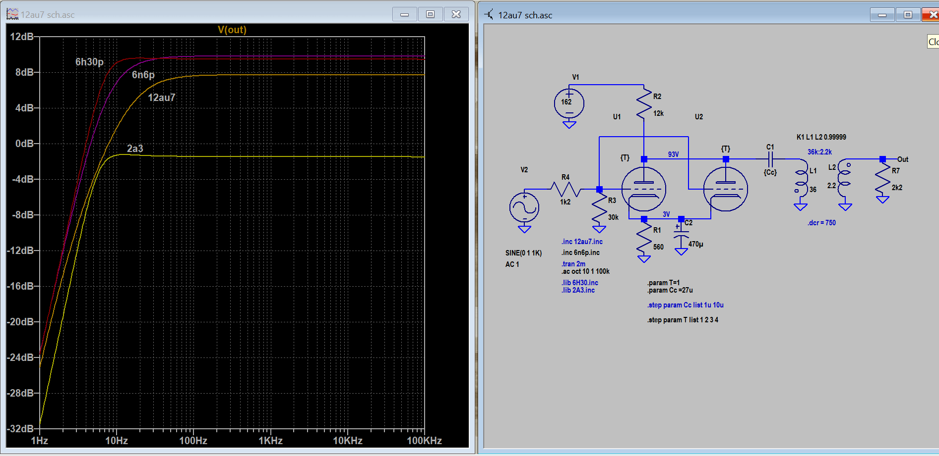

This sim attempts to show the effect of Rp on frequency response. With lower Rp when the coupling cap value is increased so the frequency is extended but a high Rp tube can not. If the cap is too small an amplitude peak at low frequency will show up or kind of resonance, increase coupling cap flatten and extended the bottom freq. response. In other word try to shift the pole downward so it does not interfere with bass reproduction.

Please understand that tubes are voltage devices - not current devices.In my last post I put a link with measurements fone on 6n6p where you have also the Rp parameter...As you can approximate from the available graphs you could go easily with 2kohm load at 16mA anode current so you'd lower the B+ with just 20 V. A spice simulation can give you the exact value.Try 2k2...1k8 load, 180 ...220ohm cathode resistor.
So lowering anode voltages to abnormally low values even for the transistors, is absolutely wrong way.
Anode voltage for this tube is already wrongly low. Please take a kook at the anode curves and data sheet.
It is totally unclear what is the circuit what is the load, is the hating OK, and so many other things
Judging from the "handwriting" of the schematic owner is probably is without experience in this area. Judging of values from the sch, designer of the preamp have not much experience too.
So take a care...
It is abs(wrong) test. Because The final load after Coupling C is way too small 5Kand the difference between1u, 10u and 100uF at driving split load
The circuit output resitance as generator is about Ri II Ranode-load
You terminate high generator internal resistance with small load of 5K
producing the high compression-limmiter-dumping effect and loosing almost 6db half of amplified
signal...
in the same time talking of value of Ccoupling to very wrong Rtermination for LF frequency response...
This 5K is even smaller because the some R is at the input of next stage. So this

Got you Boss! You'd be so right if you wouldn't be so hasty at throwing mispelled remarks ... I started to use 6n6p tubes 3 years before i've done any simulation...6n6p can be loaded with a 2k anode load with ease...it is used to drive 32 ohms headphones too...I first put a link to a russian site with real measurements of that tube ...is the hating OK, and so many other things
So take a care...
I just wrote some facts. Didnt said anything offensive please read again.Got you Boss! You'd be so right if you wouldn't be so hasty at throwing mispelled remarks ... I started to use 6n6p tubes 3 years before i've done any simulation...6n6p can be loaded with a 2k anode load with ease...it is used to drive 32 ohms headphones too...I first put a link to a russian site with real measurements of that tube ...
You have to make the difference on Anode Load and Output Load.
Yes Anode Load could be 2K BUT tube has a parameter called Internal resistance.
Anode load RL and internal resistance of the tube Ri are factors deterninating source resistance/impedance
it is roughly parallel result RLoad II Rinternal
Rinternal is about 2.4K
In this case when RL is about 2K Source resitance aas generator is 2.4K II 2K = 1.09K
Terminating this 1.09K with 5K is giving a loss and create disaster for sound outcome...
termination resistor, including stge termination+Rinput of the next stage, should be around 100X source resistance
in this case minimum 110K
not 5K
driving 32 ohms, with Tube loaded with pure resistive anode load of 3K is wrong...
That deserves impedance matching transformer.
Loading the tube with transformer is totaly different thing then Anode load resistor.
You must simply understand this.
As other members told @Veeren, pages before this is reactive kind of load, not reistive, and for low frequencies inductance of primary is factor.
But it is not clear after so many pages what is the configuration 🙁
And I think That @Veeren didnt check the heater supply as some member told him before... 🙁

For headphone of 32ohms driving, step-down transformer with ratio of 8.7 : 1 is welcome.
Tube have gain of less than mju=15.5 X
So it will be rougly 15/9=1.67 total gain of stage. With say 2Vp-p input You will have not more than 3.33Vp-p to headphones.
Should be checked is this enough.

Please put in the simulation not impedance ratio but inductance ratio. For make it clear what is happening at low end.
Main factors are Ccoupling, and Primary inductance, but Ck is also from factor as, value of last C one to Anode R, in the power supply...
And appropriate coupling factor (witch is unknown without measuring and calculating of mutual inductance) For HF end
