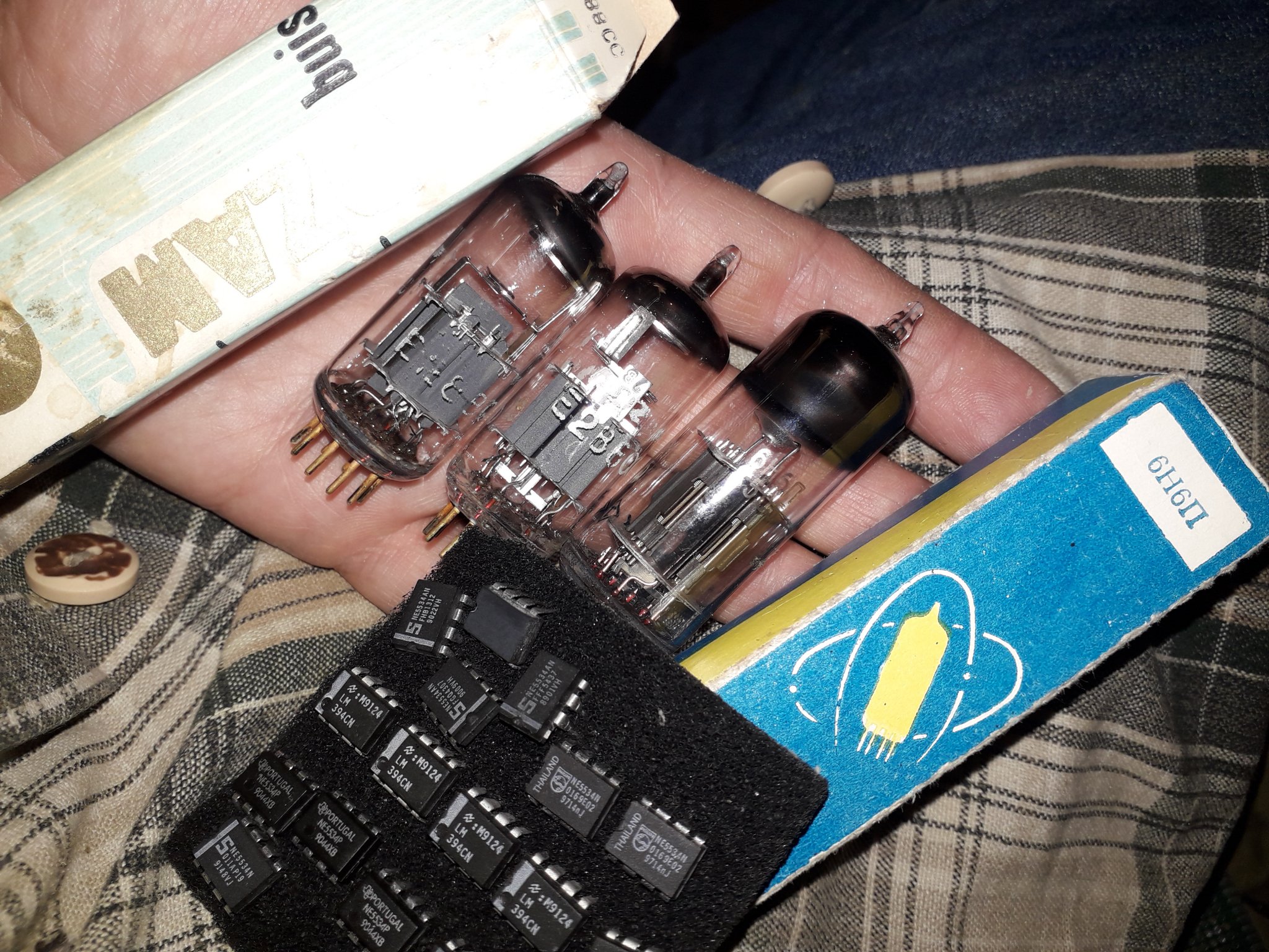

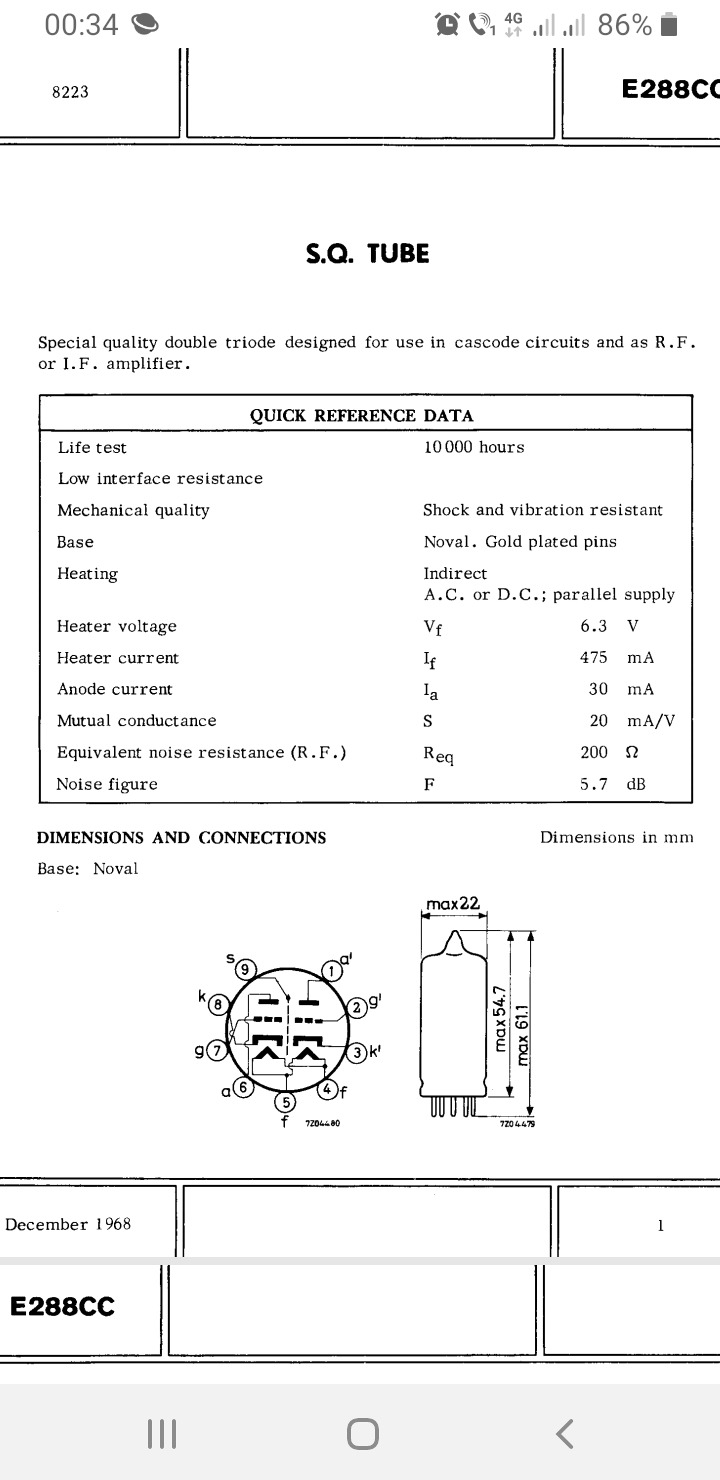

I've tested about 30 x 6n6p.None of them had the matching offered by ANY ADZAM e288cc. Yet they are ok...You won't hear differences between channels.

You are not a lucky man 🙂I've tested about 30 x 6n6p.None of them had the matching offered by ANY ADZAM e288cc. Yet they are ok...You won't hear differences between channels.
The graph of Sofia I sent show the real test on this tube; it is not easy to match the 6N6 but no impossible.
